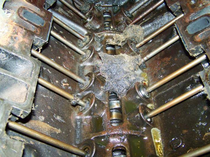

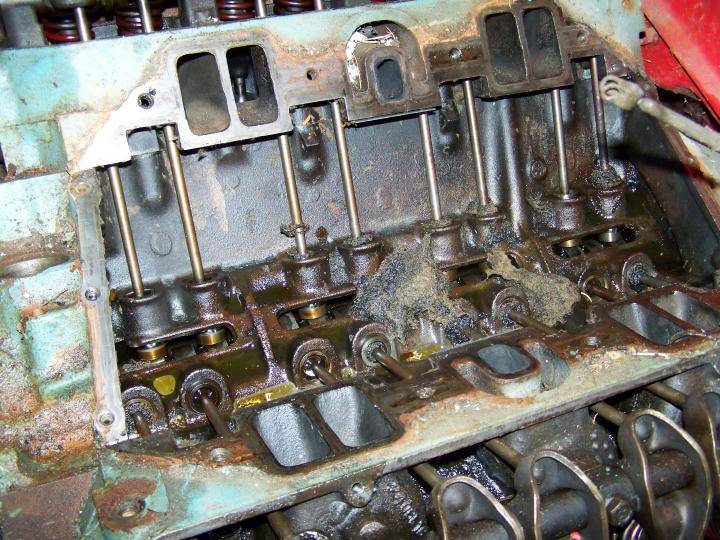

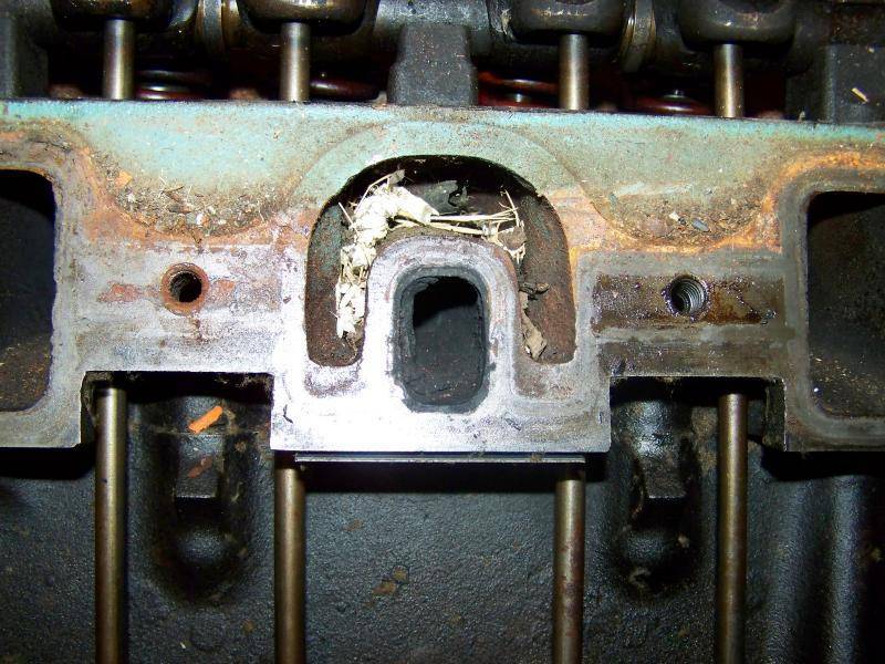

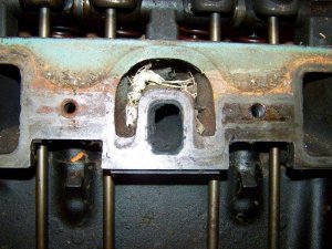

Well after pulling the valley pan I found this. Looks like insulation? It's wrapped around the bottom of the push rods and no telling whats in the pan and all the oil galleys. also found this "nest" in the heat crossover. No wonder I didn't have any oil pressure!
I bet it would have run and built pressure but a rebuild at this point looks necessary.
What did the valley pan look like? It shouldn't have done that but obviously it did.
< Sent from my tablet >
The valley pan was clean and solid. Did not have insulation between it and the intake.
Is the material in the valley synthetic or is it natural wood sticks and leaves?
