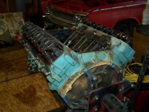

Got the engine pulled out yesterday and secured to a stand. Can't wait to tear into it.
I've used a couple of jackstands on the rear several times when pulling a complete drivetrain and used an adjustable engine jig to get it out without tearing anything up.
