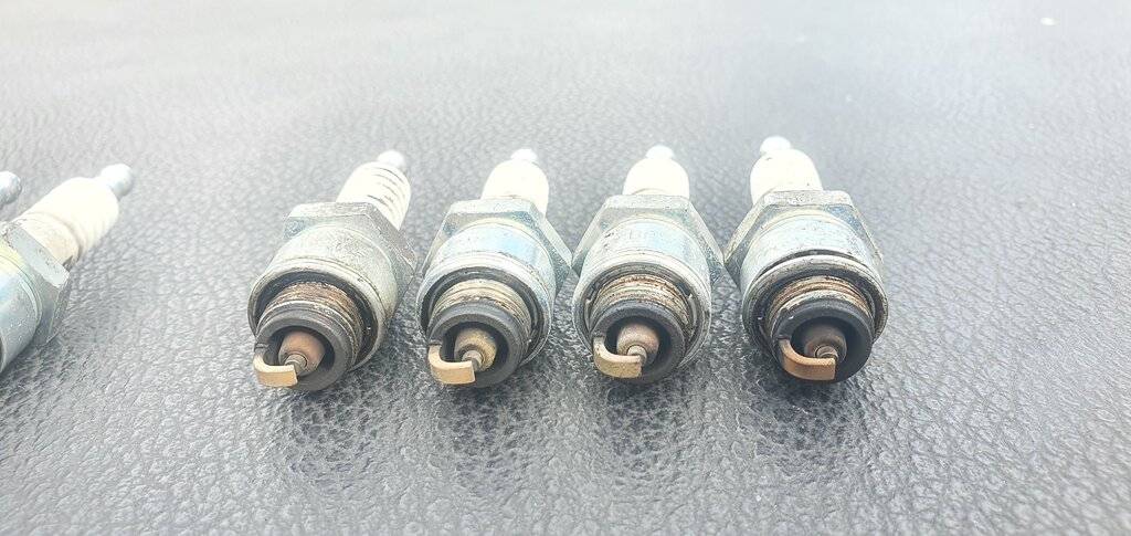

Plugs #1-3-5-7
Plugs #2-4-6-8

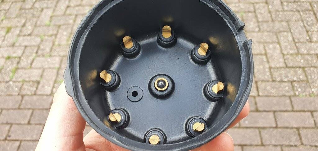

Cap

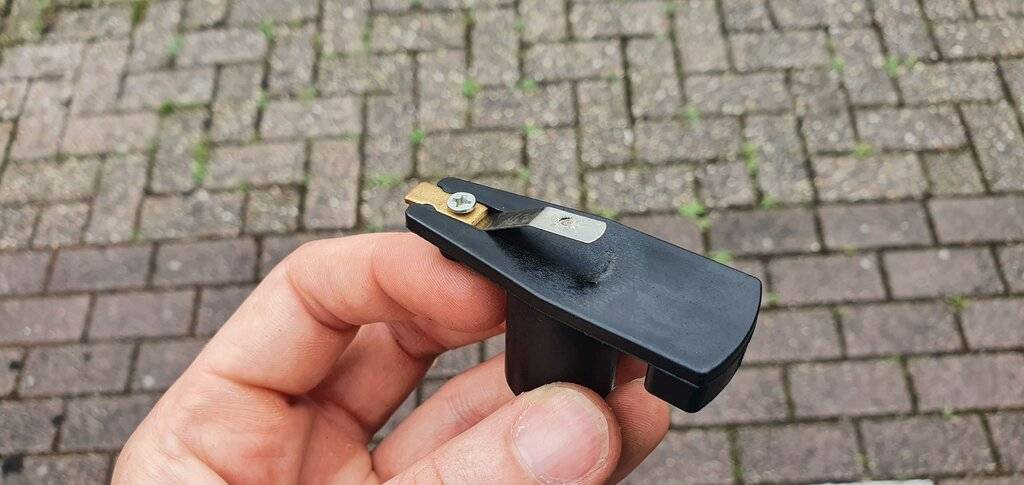

Rotor
These all look okay to me

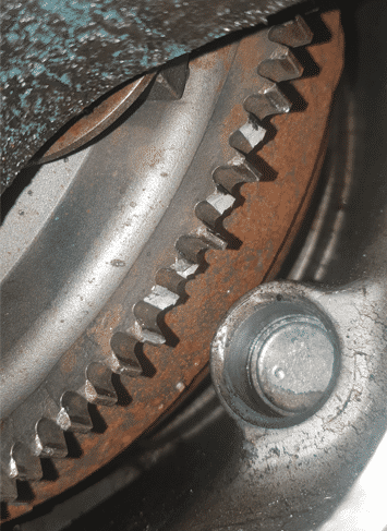

Talk about one step forward two steps back. I was ready to confirm that my acceleration problem was because of junk in the tank by rigging up a second temporary fuel tank but when I tried to start it no dice. Heard the starter spinning freely so I thought the solenoid could be bad. Pulled the starter to bench test it only to find it was working perfectly. Crawled back under the car to find it was missing a bunch of teeth on the engine side.
Up till now I've managed to do all the work myself in the parking lot behind my building but this'll be above my skill level I fear. I'm guessing I need to pull the trans and I doubt I'm able to do that without a lift or something.. Don't even know what this part is called or if I need a whole new torque converter..
In theory, you can change the ring gear on the converter. I think the FSM may even show it being done.
In practice though, you are better off replacing the converter. I doubt if you can easily find the ring gear, then fitting and welding it on right is going to be above most guy's heads.
