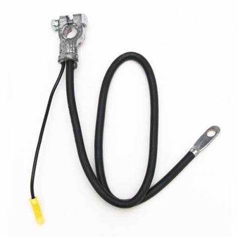

Usually there's just one smaller (#10?) wire going to the fender. There are negative cables that have the second wire with a crimp connector so you can splice the old cable on. If you feel you need the wire going back to the firewall, connect it at the fender ground connection.
This is very common and often the cable is sold by length along with application.
Thanks for all of the info and suggestions. Do you think I would find this in the aisle of my local store or need to go to a counter person? I like your suggestion for the firewall ground as I am trying to tidy up the engine compartment.
Probably ask the counter person, but measure the length of your old one.
