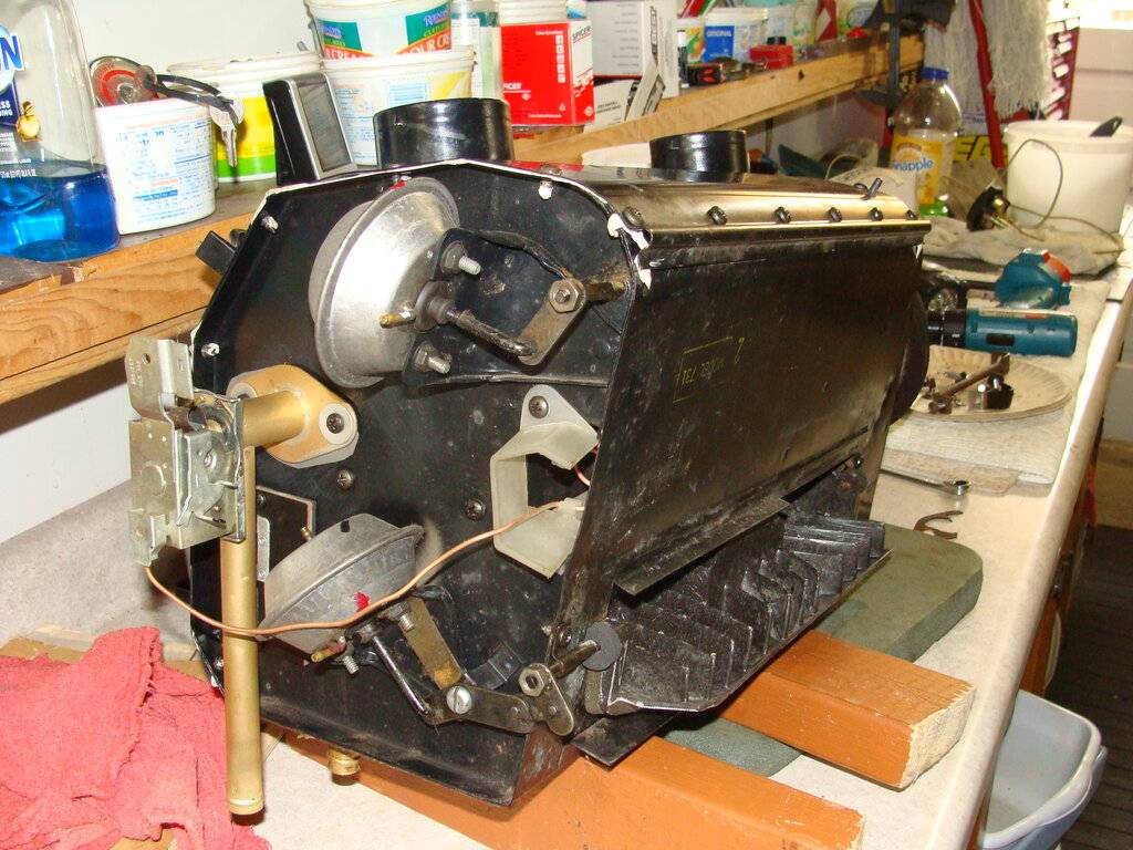

repairing my leaking heater box
Good work! Might want to verify the vacuum pods are working, another weak point on these cars. The plastic vacuum control switch is another troublemaker, there are a few guys that rebuild those.repairing my leaking heater box

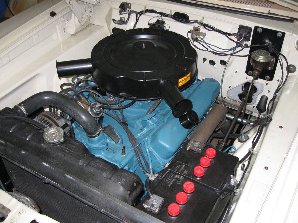

Probably doesn't matter. I saved this pic from a '65 Satellite survivor that had less than 500 miles (no joke), it shows the routing.thanks, which 2 hose coming out of the firewall go where on the water pump? can't find in SM

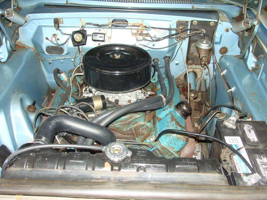

installed a couple gauges, most all components have been rebuilt and patina left, I'm leaving engine bay original 59K miles , no rust just paint flaked off
Nice. Believe on MT cars the hoses are stacked in the U-shaped bracket to right of air cleaner in pic. Also the throttle return spring should attach at the throttle cable.

I think your spring is the correct one. It matches my car ('65 Sat) & others. I think somehow the throttle & kickdown springs on the low mile automatic car got switched. Think your car is so cool, if I had any room I'd have beat you to the punch.Thank-you, I'll have to get smaller spring.
I think your spring is the correct one. It matches my car ('65 Sat) & others. I think somehow the throttle & kickdown springs on the low mile automatic car got switched. Think your car is so cool, if I had any room I'd have beat you to the punch.![]()

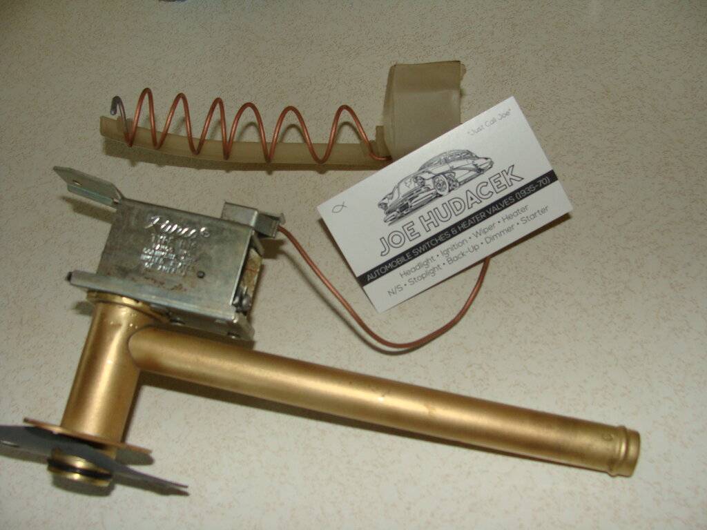

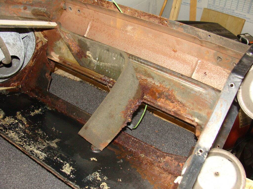

Here’s my ’65. It has a lot more miles than yours but is a nice original western car that never had any rust. It was a mechanical mess when I bought it & was unsafe to drive. Typical of the type of work done was the heater box. It was leaking at the control valve & core. Their solution was to try & fill it up with RTV & put the hoses back on. It barfed antifreeze all over the nice original carpet. I took the carpets out for a thorough scrubbing & managed to save them. I never drive the car in cold weather so I elected to leave out the internals when I redid the heater box. The car can be driven anywhere now. One other thing I’d do if you haven’t already is check all 4 wheel bearings. That old grease can get really petrified.
