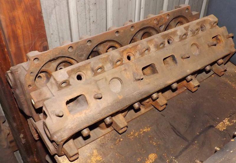

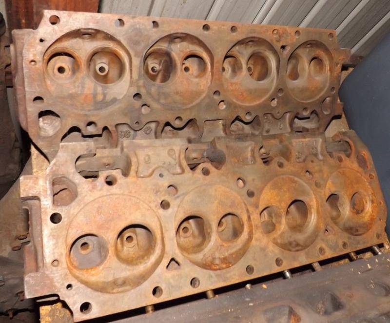

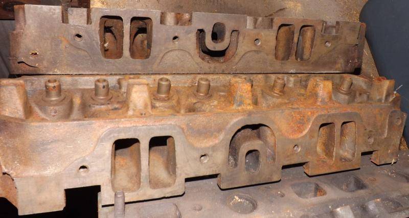

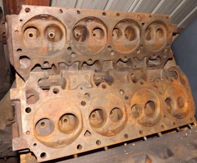

Here are pics of each set of heads, the first three pics are the first set, the second set had been dipped to remove all paint hence the rusty stains on them. Both sets show no visible cracks anywhere but i have not had them magnafluxed. $100 per pair.
