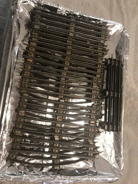

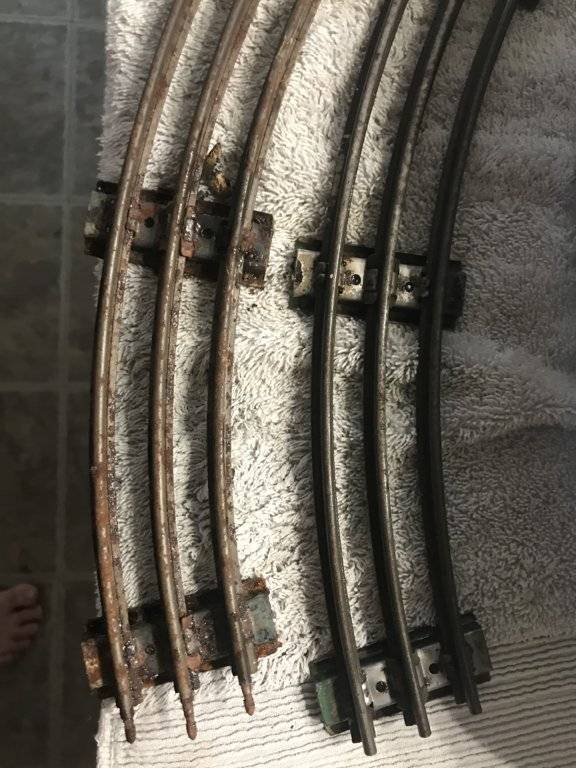

It’s been about 22 hours. The vinegar is working! I went through, and scrubbed em all with a toothbrush to get the now loose top layer off. I’ll let em soak again over night to attack what’s left. After soaking a bath in water, and baking soda to neutralize the vinegar. Then sit in the oven for an hour to completely dry. If they come out decent I’ll brush some black paint on the ties. Maybe wipe em down with a rag soaked in wd-40 to keep em from flash rusting.
Looks like these were on a layout at some time. A lot of em have green paint (simulated grass I’m assuming) on em. There’s also some white paint too... the green is coming off for the most part. The white is a little tougher.
A little comparison

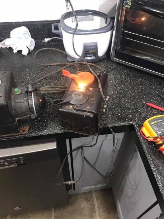

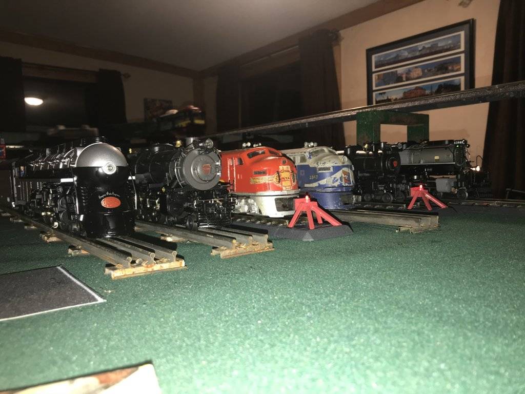

Straight out of the oven, and to the floor. The ZW isn’t working, but the TW is. Steve is enjoying himself. lol
Take a look at using oxalic acid instead of vinegar. It may be easier on the tin plate that I think those tracks have.
Buy on Amazon in powder form or as wood bleach at Home Depot etc.
I’ll have to look into this for the next batch. Thanks!

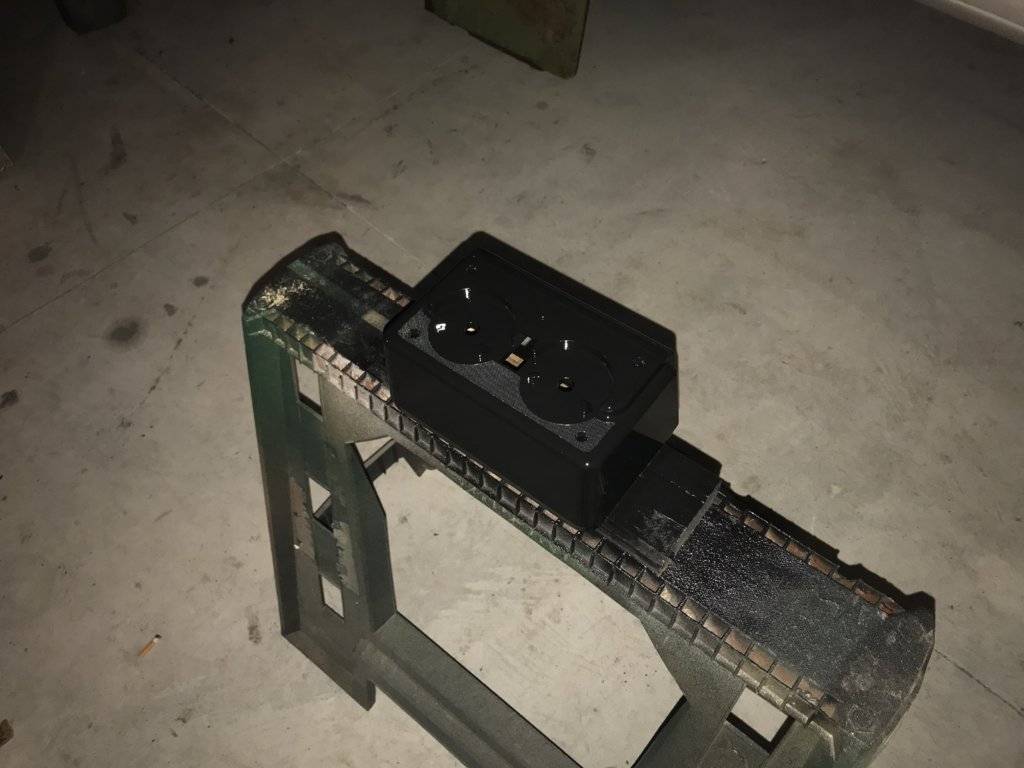

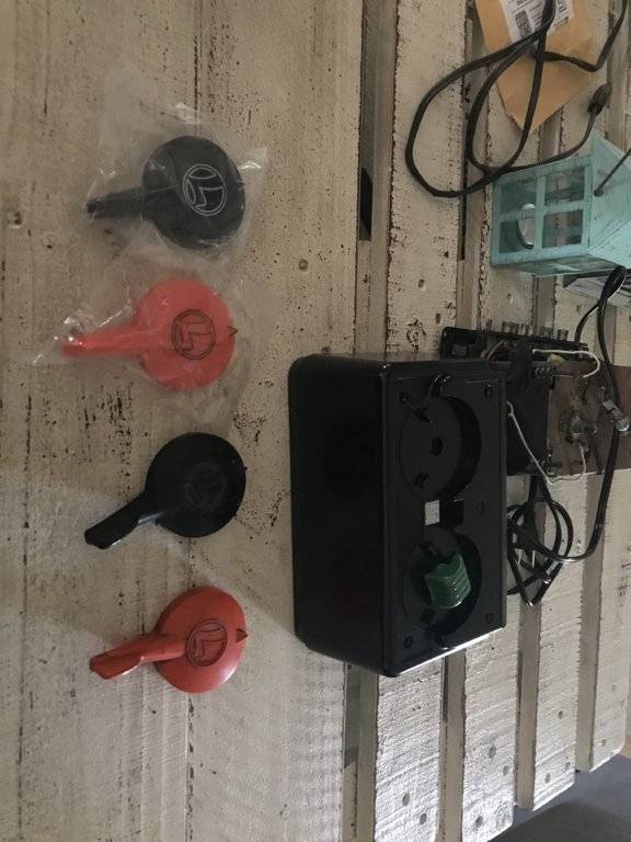

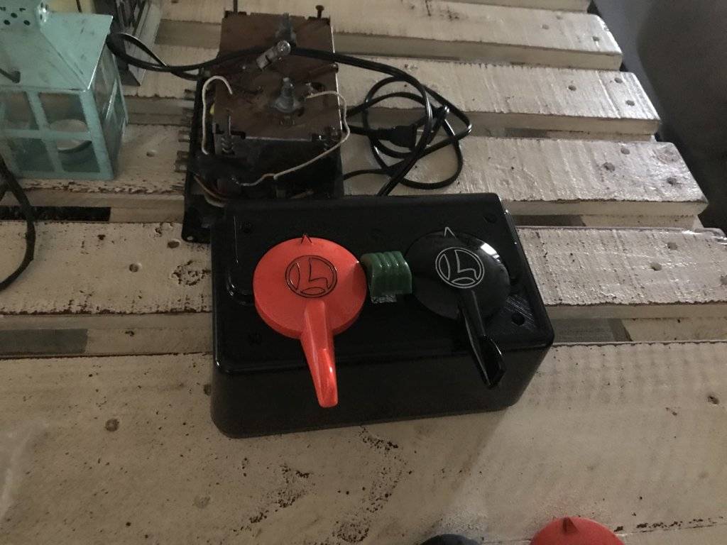

With the TW working decent, I decided to give its beauty a little restoration. Give it a little more pop to work on the layout.

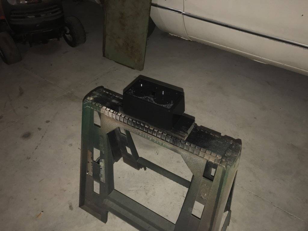

It looks like it suffered a decent fall in the past. The case had a big crack on the back side, and the bottom frame was a little distorted in the same corner.
Glued the crack up, and sanded it pretty smooth. After a good cleaning and sanding, gave it a coat of adhesion promoter, and some new semi gloss black. Looks good!
The original cord was toast, so it received a new one. Was also able to find a new cover for the light, and some reproduction handles for the controls. The original orange handle must have suffered a crack from the same fall, plus the paint was long gone.I’m waiting on the new decal to come for final assembly.

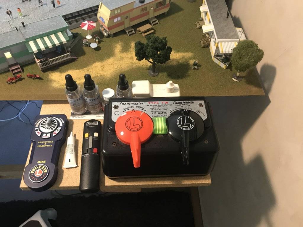

TW all finished up, and now doing work on the layout! She looks and runs good!
The decal got a little goobered up from the screws, but I can live with it. Looks 1000% better.

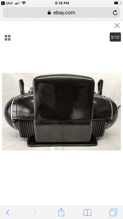

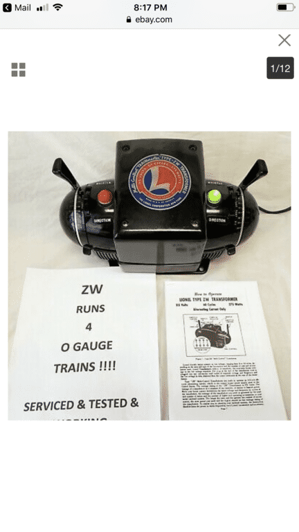

I sold the ZW, and a few other pieces from the bin. The transformer needed work, and wasn’t as clean of one I was looking for. Ended up winning one on eBay. It’s been completely restored, and ready to go.

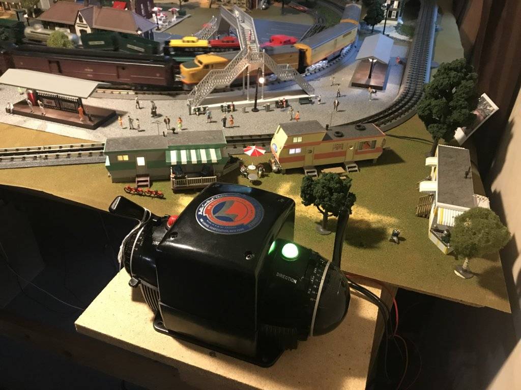

I feel like one of the cool kids now! She showed up, and is working perfect!
Need to build a bigger control center to house everything lol.

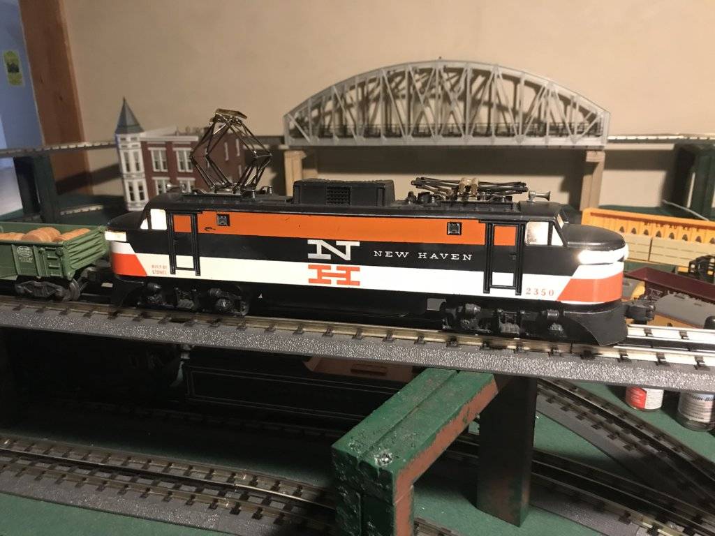

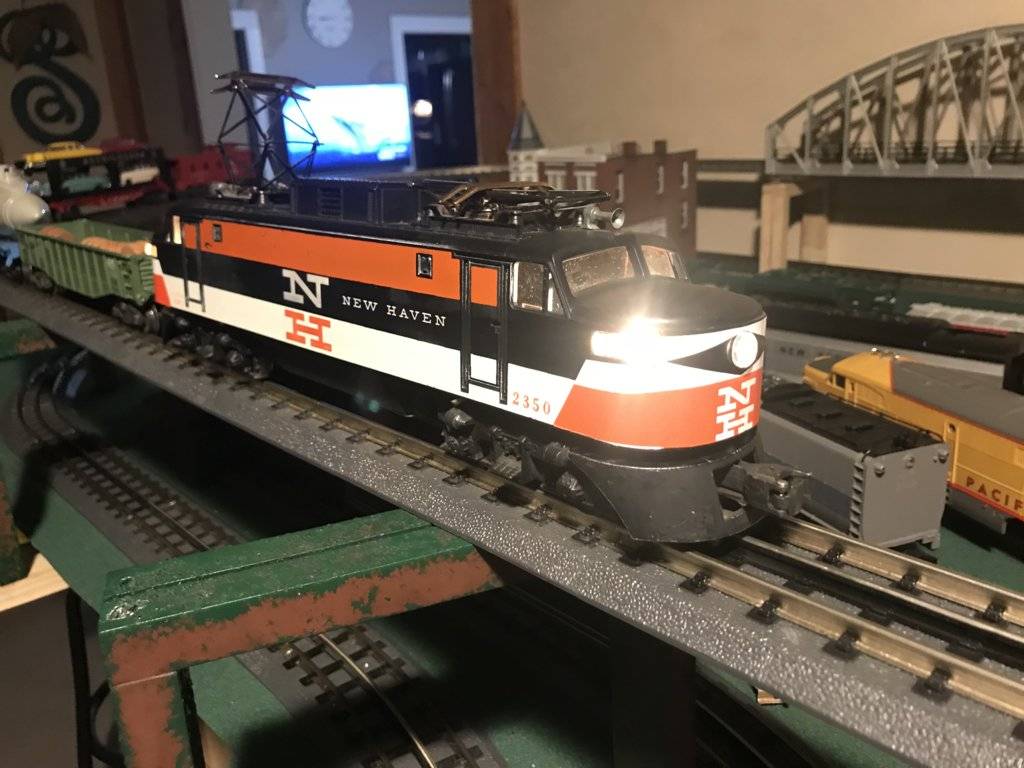

Went to another show down south a bit. The postwar bug has really bit. Came home with a 2350 New Haven. Guy claimed it ran good, but once home it wouldn’t move on the tracks. Removed the shell to find the wires had pulled off the motor. Soldered em back up, and she is running.

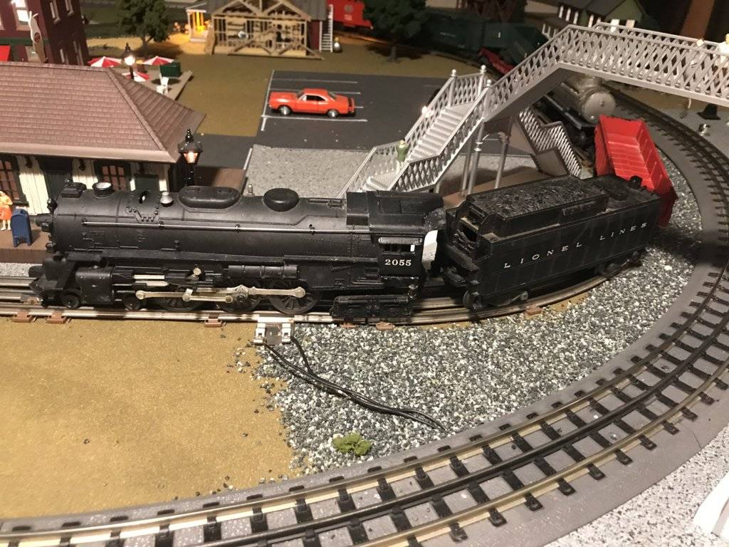

Also picked up a complete 2055 set. Locomotive and all but one car came with their original boxes. The guy wasn’t sure if the whistle tender worked or not. Was a pleasant surprise to hear it come to life on the layout! Sounds great! It even had remnants of an old smoke pellet in the engine. She smoked for a couple minutes around her first laps.

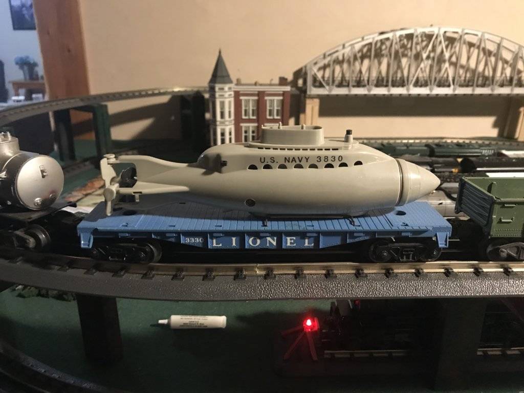

The submarine car looked too good to pass up.

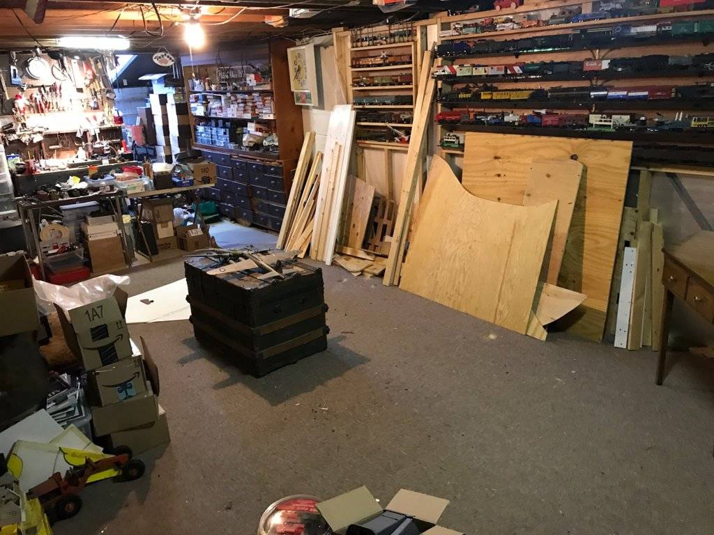

You postwar madman! I love the 2350, it looks like it’s in really great shape! I spent the day dismantling my layout tables. After 13 years, it just wasn’t progressing and it became a junk collector and alternate work bench for the Chrysler. Time for a fresh start!

I’ve been trying to grab one for a little while now. Bid on a few online, but kept getting outbid. Surprised to find this one at the somewhat local show. Guy had 2 of em. The shell is in great shape, but it has a few little issues that need resolved mechanically. The 2055 was great surprise once on the track. She runs beautifully.
Uh oh!! Don’t let it sit too long apart!! LOL I’ll be keeping an eye out for what you plan out! I like that wall in the background!
It’s amazing how “free” space turns into work/storage space! Hell even the cars aren’t safe at times from turning into a shelf around here once in a while.

I dropped the above New Haven off at the shop down in Daytona. Hopefully they can get it going in both directions instead of just one lol. Of coarse while there, I had to get a couple things! Picked up a big flood light tower for the yard. Also grabbed a restaurant for the city.

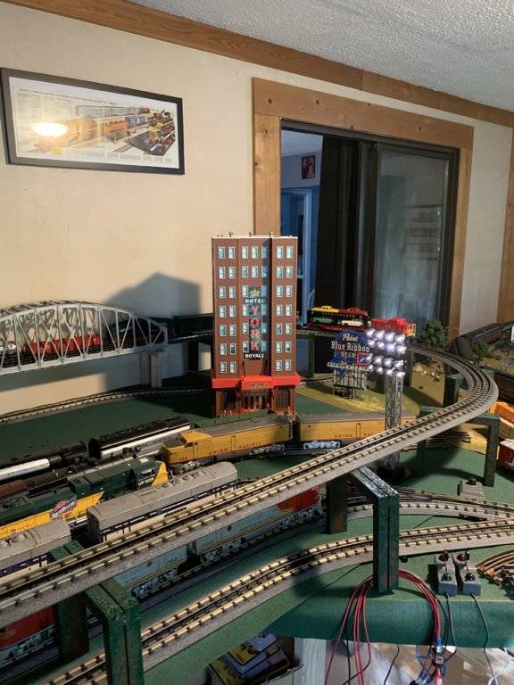

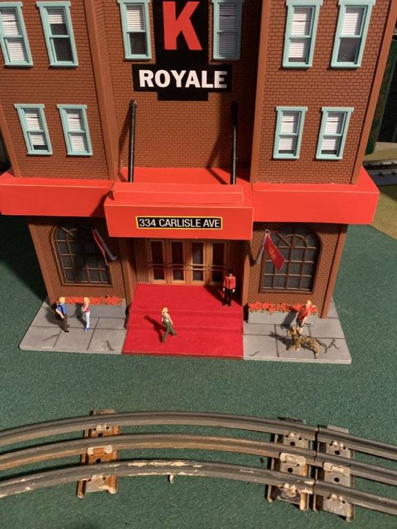

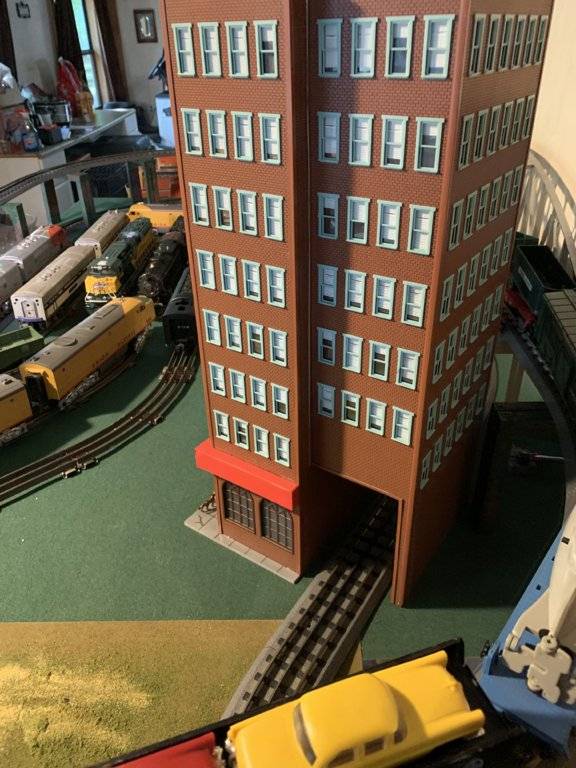

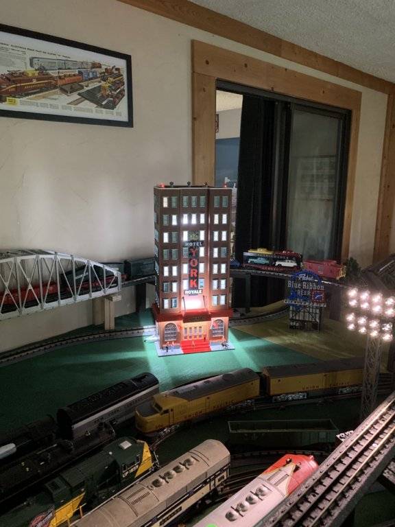

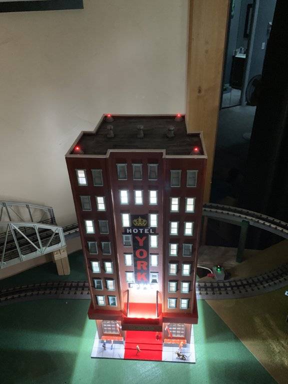

Placed a nice order on Menards. Been wanting this one for a while. Finally pulled the trigger. It is HUGE! The York Hotel. Looks great, and massive on the layout. Love how it can be used as a tunnel as well. Think I found a good home for it. It dwarfs the other city buildings.
A couple quick vids. One showing a little more of a night scene.
Nice! I saw that hotel at York TCA last week, it is massive. Here is another huge piece that will never fit on my layout:
