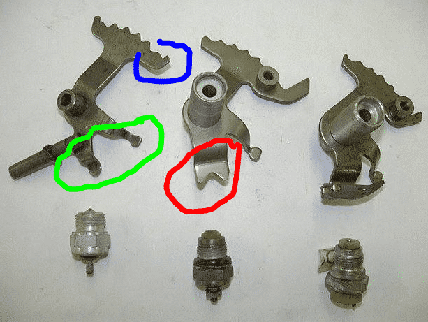

Here's the pic from that FBBO thread, at first glance, the one on the left seems to be the one to match yours (and John's) as it has the cable clevis on it.
But the rooster comb in this pic appears narrower, and the teeth are certainly more pronounced, esp in the blue area. (and I can't see a comb on John's)
Even if yours was really worn, I don't think the blue area would be possible, it looks too short?
Regardless, the LH piece has only 2 tabs and yours and John's have 3. That's definitive that the LH one doesn't match..
The red-circled has 2 ears for the NS switch, but yours/John's have feet on them, and the red clearly does not. (and other features are different too)
So none of these match yours or John's.
