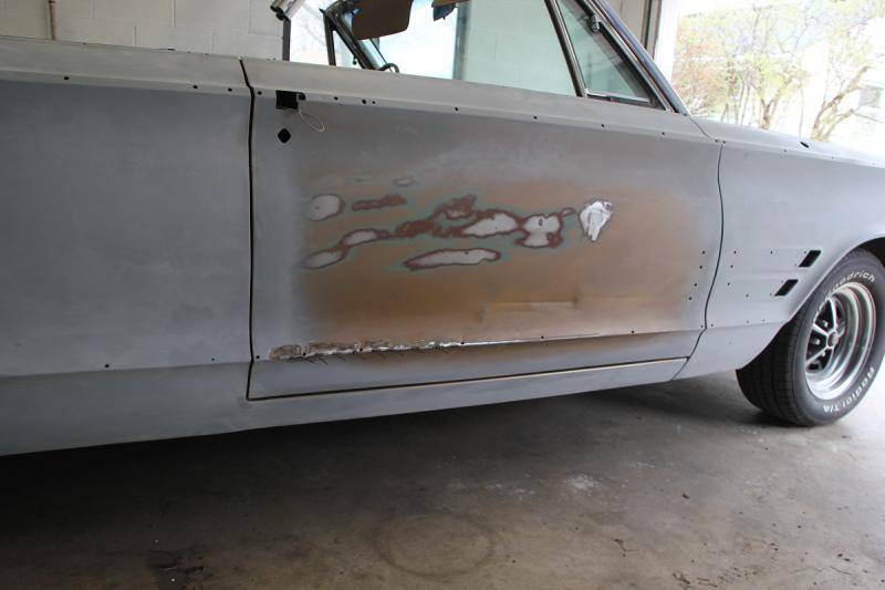

Here is a little update on the repairs. I stopped by the body guy to see how far he has got on the 300. These are the areas he is working on.
The damage on the passenger door is from a few different accidents. The good thing if you look at the door gap, it is even all around the door, so it is all cosmetic damage on the door skin.

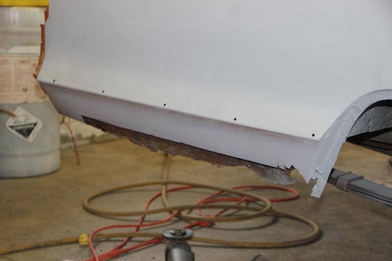

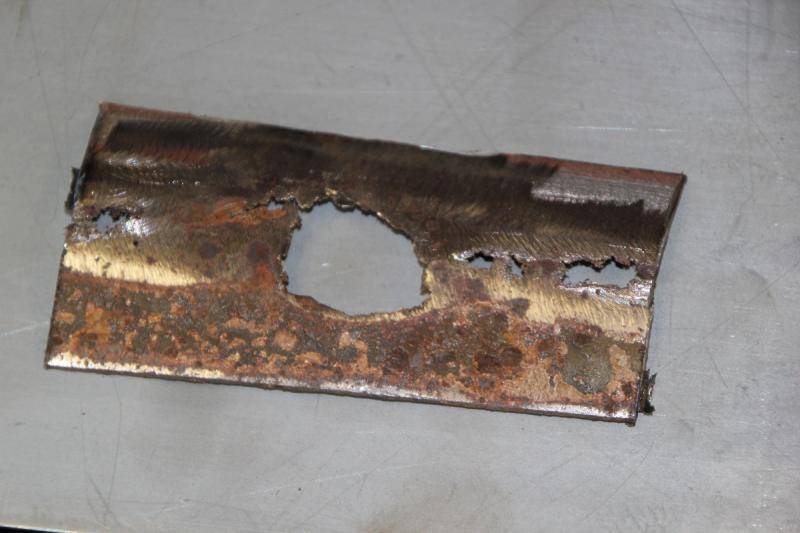

The right quarter has the most rust. Most of the cancer in the outer skin has been cut out; he will cut out the rest once he has formed the replacement panel. The inner leg is rusty about the same distance up and will be cut out too.
This is all that was needed to be cut out of the left quarter panel. The hole is about the size of a quarter.

Looks like you have an excellent body and paint guy! Good for you!
Sign of a good body man. Correctly pulls out the crease instead of Carlos' Body Shop method of making a new crease with bondo. Nice job.
< Sent from my tablet >
Yes I told him I wanted him to pull it out and not just bondo a new line. I couldn't get that crease out myself. There was damage right next to the door that I was able to pound flat with a hammer and dolly, but it was below the crease not in it. There was no way to get behind the door unless I cut out a chunk of steel and welded it back in later.
I can't even figure out how the dent in the middle of the door, was caused in the first picture. It had to be backed into with something because the paint really isn't scraped the metal was streached by impact. I bet there were over 50 dings in the paint, on that right side and I'm not including the door. The rest were in the rear quarter where people in the back seat of thier big four doors swung open and hit the car. The good thing about most of them is they sanded out and where not dents just paint chips.
