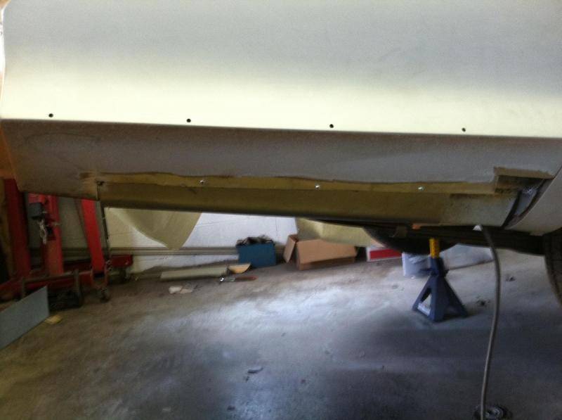

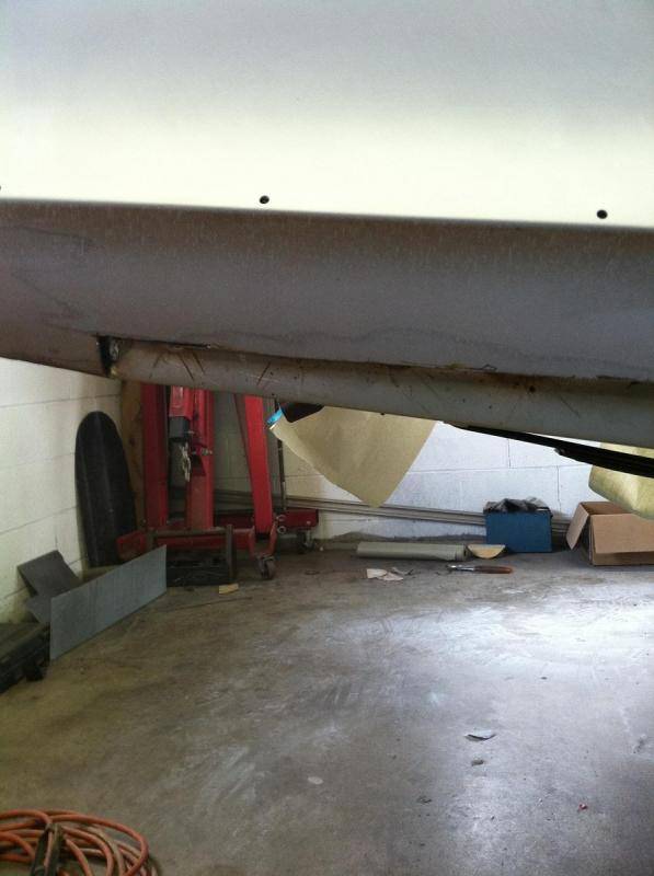

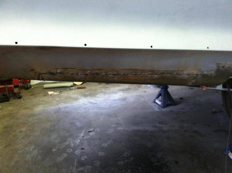

Last patch is in place. This was the worst spot on the car. The leg was rusty too, so that needed to be sorted out first. It is a nice cool, rain on and off weekend, so my paint body guy should me focused on my car this weekend. It is one step closer, this is the last step before he paints it. Legs welded in.s.jpgRt quarter patch 1st step.sm.jpgRt quarter patch tacked in.sm.jpg

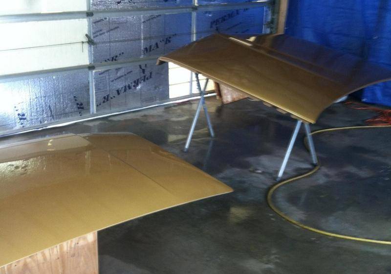

I hope to have a completely painted car in my possession by next weekend. All of the body work is now finished. Here are a couple of shots of the hood and trunk lid that the painter sent to me. They are completely done and buffed. I am getting really anxious now more than ever.Hood and trunk painted2.sm.jpgHood and trunk 1sm.jpg

I got to see the painter/body guy's work today. The work is beautiful. He is sanding my sanding primer down with a dual action sander with 500 grit paper and it feels like glass. He is then laying down a 2K primer with harder before applying base and clear the results are outstanding. I am so glad I decided not to paint it myself. I really looked over the finished trunk lid closely and I could not find an imperfection anywhere and the finish is like a mirror.
Well here's my "profesional" opinion, It looks great! Sounds like he's doing all the right things. I can't wait to see the finished pics.
