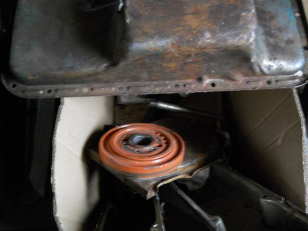

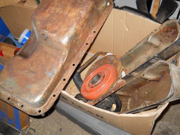

Well it looks like I do not have the correct oil pan for my beloved fury.(boo) I did find a used one from a 413 out of64 Newport with the correct indent for the idler arm. Anybody know if this will work for mine? 67 fury 3 with a 413 once I get an oil pan!
Also the owner of the pan says there are no numbers stamped on it. I've researched and seen the #s for what works, I just don't know what the 64 Newport would have had. Any help is appreciated!
Here's the pics provided on the listing.
Might not be the original pan for the motor then. The guy "says" the blocks casting reads A-413 3-24 9-14-64. Well like I said hopefully it fits and I don't get shot getn it!!lol
$150 vs $30 . I started combing Craig's list and found that one. It's got the right indent for the idler arm and for the price if it doesn't work I can still afford the other. Just gotta go to a sketchy area to get it. Not a safe as summit but I like living in the edge. and the fury fund is getting tight. I've gotta save where I can if want this one the road this year. Thanks for your help earlier Stan.

I picked the pan, it's in pretty good shape. Threads on drain plug look good! Il get a pic up in a day or two.
