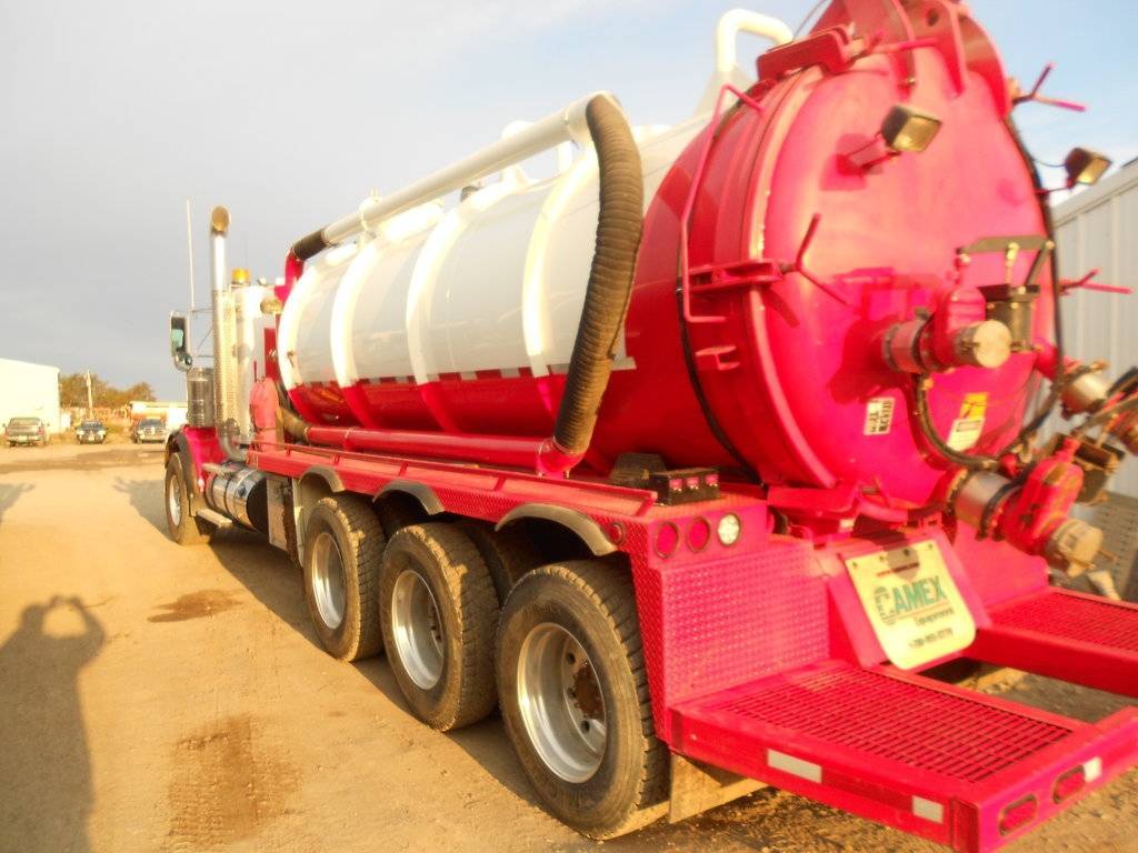

We had a H2S shut off installed on the KW I drove, it closed a butterfly at the air intake. Once activated it had to be reset manually, and at the switch. Once the gas get into the intake, it increases the rpm's until it melts down or grenades, as the gas has typically flooded the location. Thank God, I never had to use it. 6wd lockers, and an 18spd, sure made for alot of fun driving, I do miss driving this truck.
Bet that would be fun, start running faster because of the atmosphere.

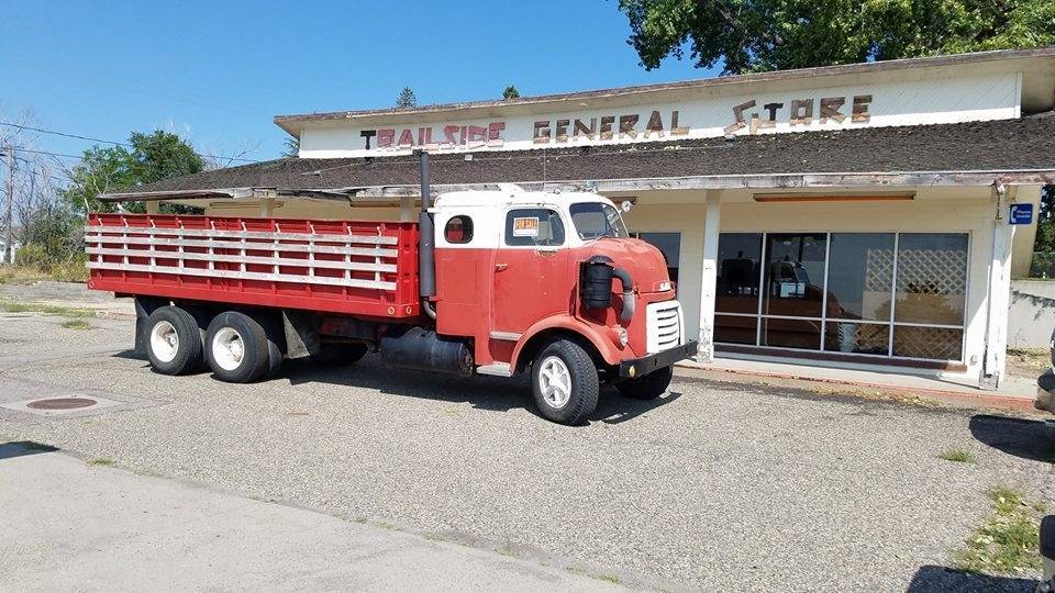

looks like a deuce and a half, cool vid.
That would explain the ability to go anywhere, plus I wasn't paying that much attention to the truck, I was wondering what the combined IQ was. For the record, I'd have fit in fine with their vocabulary, and no, I'm not proud.
