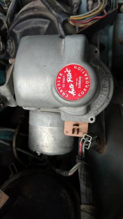

Does your car have Autopilot (cruise)? If so, I'll bet that's what is making the sound...
The cruise servo (located on the driver side inner fender) will make a sound like that when not adjusted, whether it's turned on or not. Try carefully unplugging the wire connector at the front of the servo to see if it stops.

Ding, Ding, Ding! We have a winner. Messaging you.

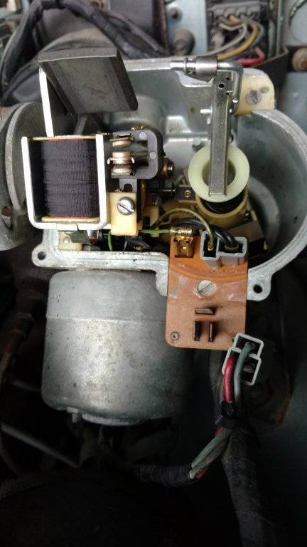

A qualified "yes" on bot h. I cleaned and adjusted the contacts on the Auto Pilot and the sound stopped immediately! What I don't know is what a proper adjustment range is. On the headlights, the hi beams do function while sitting there in park and with no load. The experience I had on the road was with a/c, headlights, etc., drawing. BUT, I will put today in the "W" column for sure. I also read some on the MADD solution, but am wondering if converting to LEDS (especially the headlights) would reduce draw enough to avoid potential meltdowns?

There is no "proper adjustment range" on the Autopilot armature - if it works it's adjusted to within tolerance. It's a fairly basic system. Keeping it adjusted and dressing the points is the regular maintenance part...
