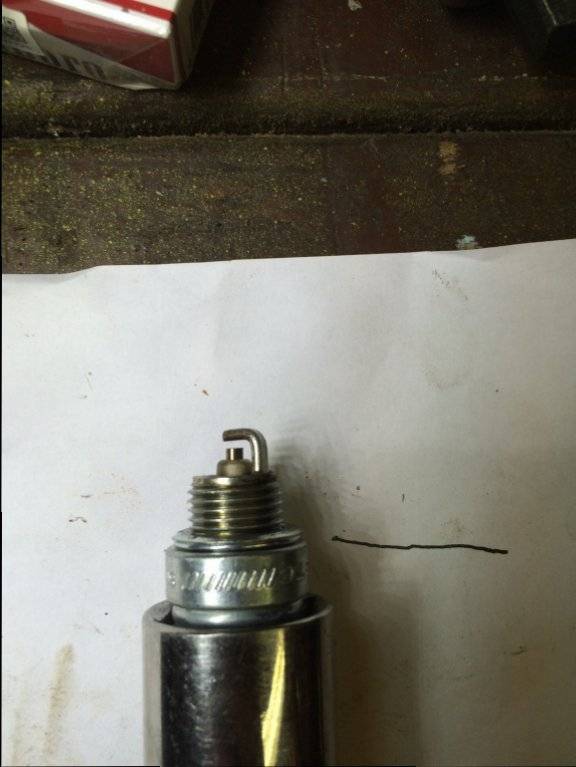

Well after going back to basics and pulling the plugs, this is what I found. The # 6 hasnt been firing.

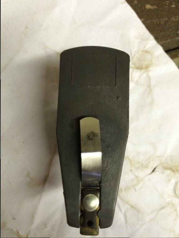

And closer inspection of the cap and rotor..
