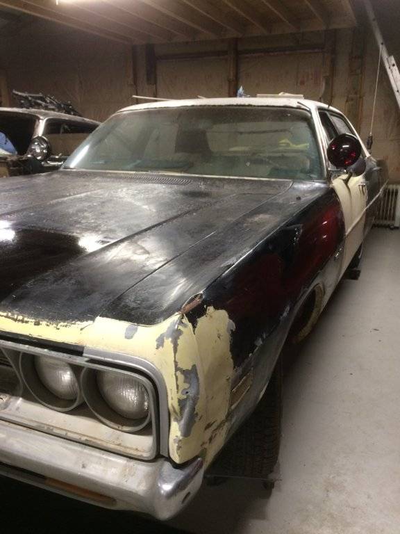

So did you have a special cut tool, or where you just being extra careful?
And it's looking great.![]()
i'm curious about the specially cut razor blade.

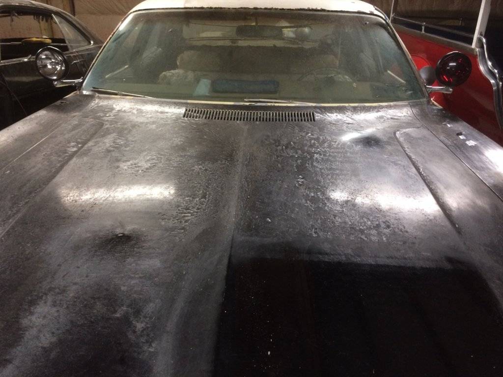

What I do is simple really. But it really boils down to patience and technique.
You want to remove only the top layer or layers of paint, and not the substrate or base, in this case the original paint.
Most razor blades, (including the newer style of “snap” blades where you can progressively remove a dull edge, by breaking off a piece) have two edges. By lightly pulling the blade, running the one edge, in one direction across a sharpening stone, or 600 grit paper you can “shape” or dull the leading edge of the cut face of the razor. I also lightly shape the corners of the blade while pulling it across the stone while flexing it 3 or 4 times to lightly dull the 90 degree edge (the corners) of the blade.
Then when you remove the layers of paint you can mimipulate the blade by positioning it and by “bending” it to comform with body curves/lines etc.
Doing it takes time and patience and lots of practice, mistakes will be made, but overall the outcome is effective.
Long winded explanation, I really need to show you what I’m talking about. But I think you can get the idea.
