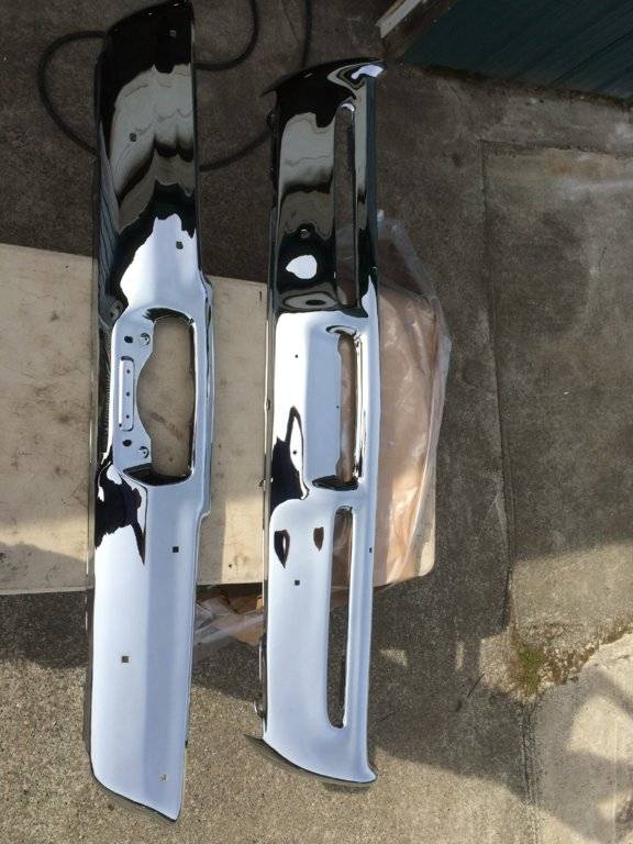

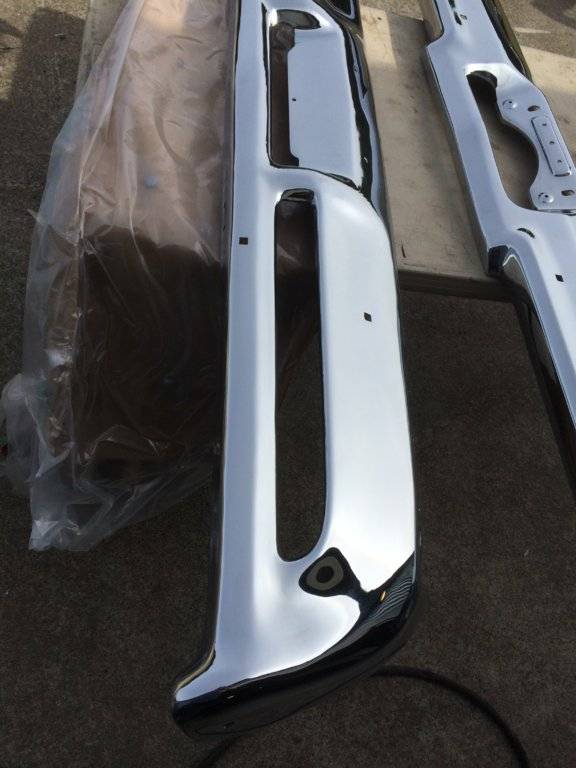

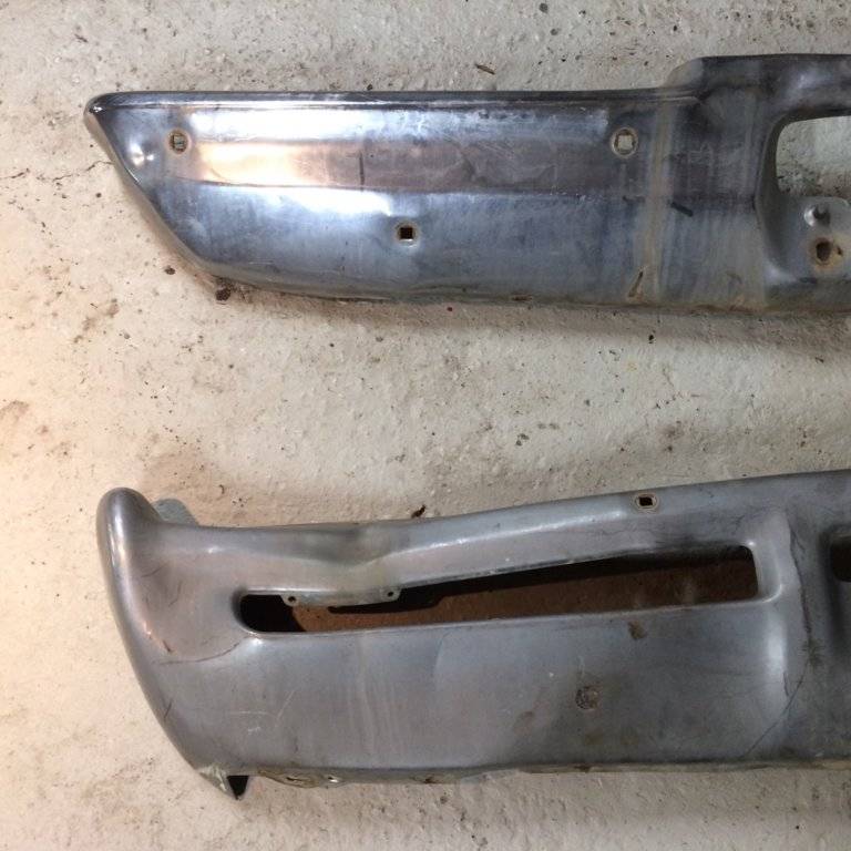

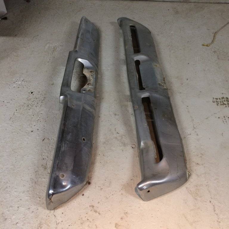

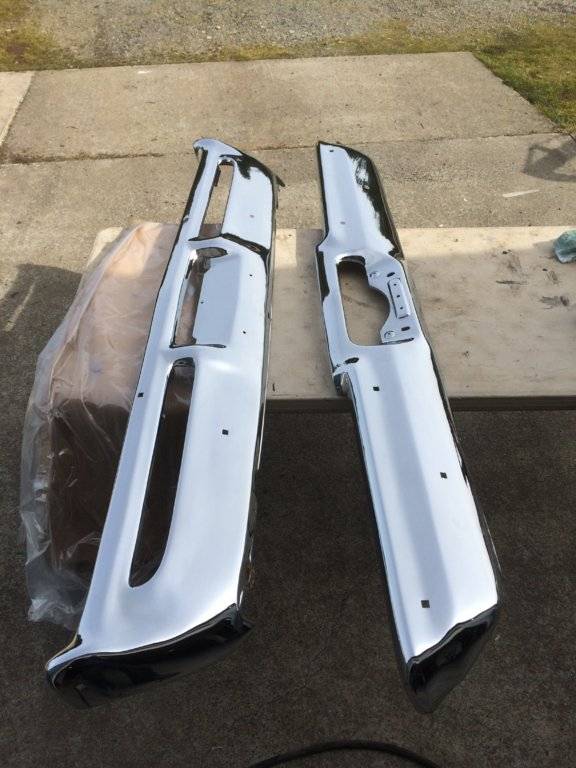

Re-chromed original CHP bumpers.
I always paint the inside and wax the chrome as soon as I get them in the shop.
I looked up the company you used and seen some very very poor reviews...but this makes me question that...those bumpers look excellent! Cant wait to see em on the car!
Thanks man, me too.
I hear you,...actually none of the "affordable" platers have a very good reputation on the internet.
I wanted "driver quality" chrome, and straightening and that is exactly what I got. They did get the bumpers relatively straight. Not too wavy. It looks fine for me, better than fine for most people. They will look great on the car.
If this was an OEM or show quality restoration, I would have been using a different shop.

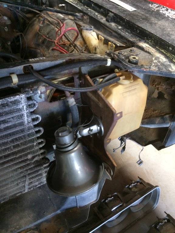

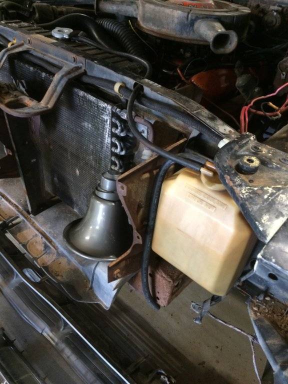

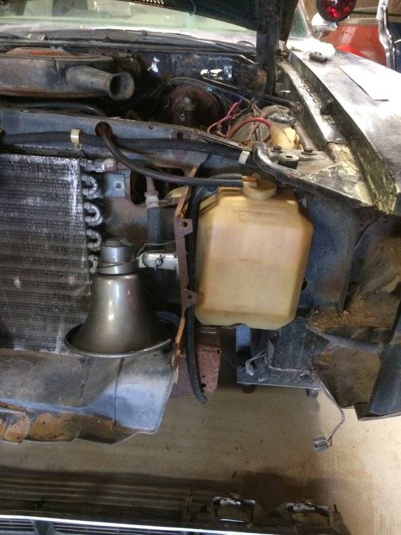

I located the original GM radiator overflow tank that the CHP installed on these cars in ‘69.
While the grill was off I installed it and it fits like a glove, it works too.
Also located the original issue CHP external radio speaker and installed that as well, it fit like a glove and works!
Baby steps...

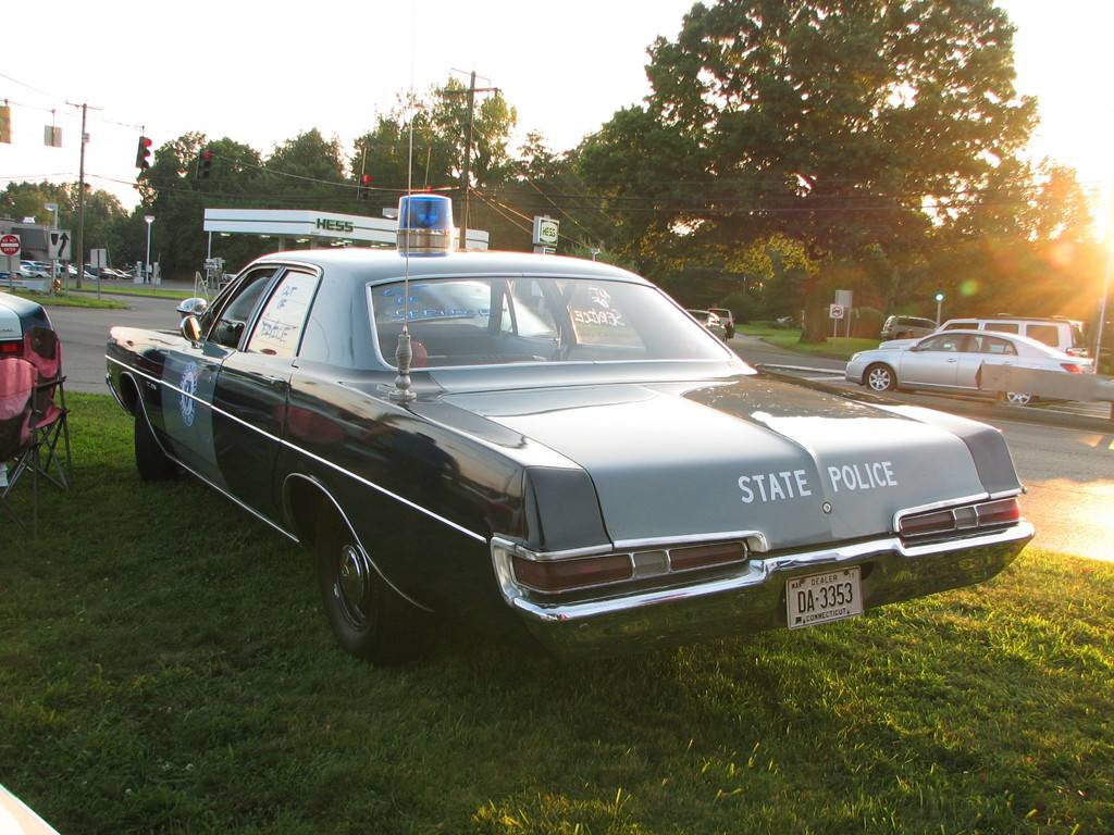

I just discovered this tread today. I'm very interested and now following this. I love the vintage police cars. Pretty awesome project you decided to take on, makes me want a one now. Last I knew there was a '69 Polara police cruiser originally from Massachusetts in my state of Connecticut. Not sure if it is still around, haven't see it in awhile. Here is a picture. The "new" bumpers on your car are looking great by the way. Any updates on the rest?

I thought the MA. State police used Fords in1969, anybody from the area remember? Where are ya Stan?
Maybe it is a clone, the caption from this picture says it's a clone. Maybe you're right. If it is a clone it's a damn nice one. Would still like to know if the MA police used these or not. Anybody, Alan?
