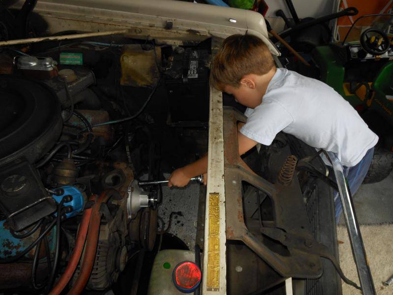

And I had bit of help putting it back together too:
