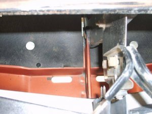

Reversing the outlet hole to the other side......isn't on the "correct factory" side now?
I heard rad yoke and went right to the top where it seals to the hood, Bob you're right the bottom one is more important but I bet that ones not maid in the aftermarket. Is it?

Good question! You'd think Ma Mopar put it in the best place to begin with but I guess improvements can always be made.
it is on the correct side now........so the question satill remains, why is this thnig running hotter then usual? Maybe with the wrong wtr pump on it?
I don't know if there are aftermarket ones available for Mark's car. I know there isn't any aftermarket ones for Formals. Might have a chance finding one in one of those old Mopar junkyards that's been on FCBO lately.

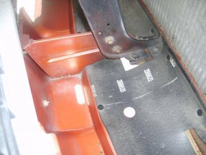

From '71 FSM.
