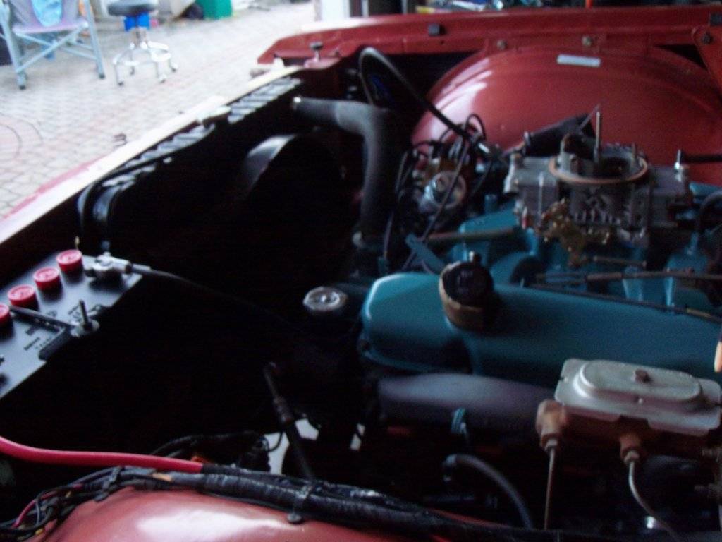

I'm having a problem with my Polara overheating on the highway. I can drive it around town with no issue and even on State Routes at 55-60, but on the interstate running at 70+ it will overheat every time. It's a 383 4 barrel without air. I have replaced the temperature sensor, radiator, fan & hoses. The water pump is less than a year old. The heads have been checked. I've even tried an auxiliary electric fan. I'm not sure what else to look for. Any suggestions?

Do you have Fan shroud?
I would think a fan shroud would be more important at lower city driving speeds. he mentions overheating at highway speeds where you should have all kinds of air through the rad. I don't think its an air movement problem. maybe the rad cap is not allowing the cooling system to be pressurized enough. just a thought.

The thermostat has been replaced, the filler pan/front valance is there and the lower hose is new with the spring in it. The radiator is a new all aluminum replacement that was supposedly sized for the car. It has a new cap with a temp gauge in it. When the gauge in the car says it's hot, so does the gauge on the cap. I've also installed a overflow reservoir to keep it from puking all over the place when I stop. I thought about trying a high flow water pump next. I'm pretty convinced that it's a water flow problem and not an air flow issue.
