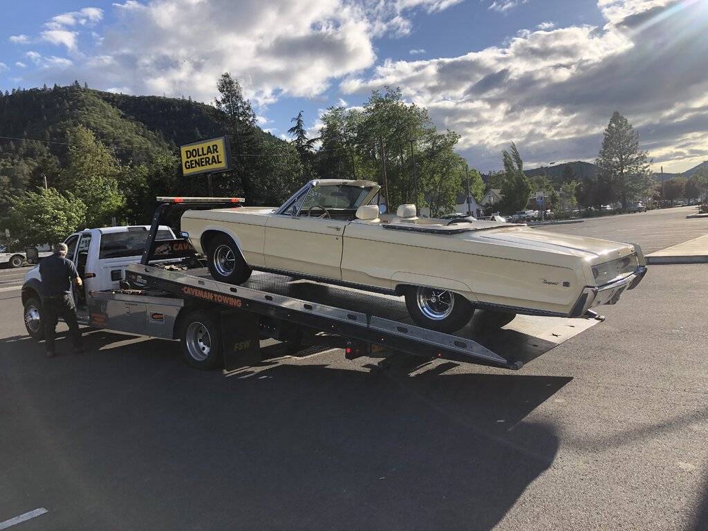

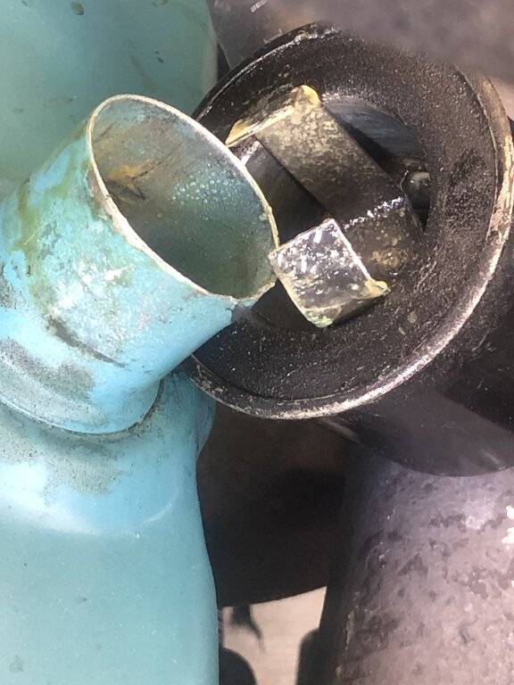

I am terribly sorry but I fear I will disappoint everyone. I hit the freeway home with the car so I could take to trans shop this morning, and she began running rough, and sending all her coolant out the exhaust. Had to flat bed it back to her garage. Today, I checked the oil, and it's over full and there's some foam in the breather cap. Either blew a head gasket, cracked a head, or broke a block. I'll know more Monday, and this may lead to disposal of the car.

Blown head gasket, be running in a couple weeks then we'll pick this back up. Meanwhile, I await the arrival of the refurbished heater box I had rebuilt.
