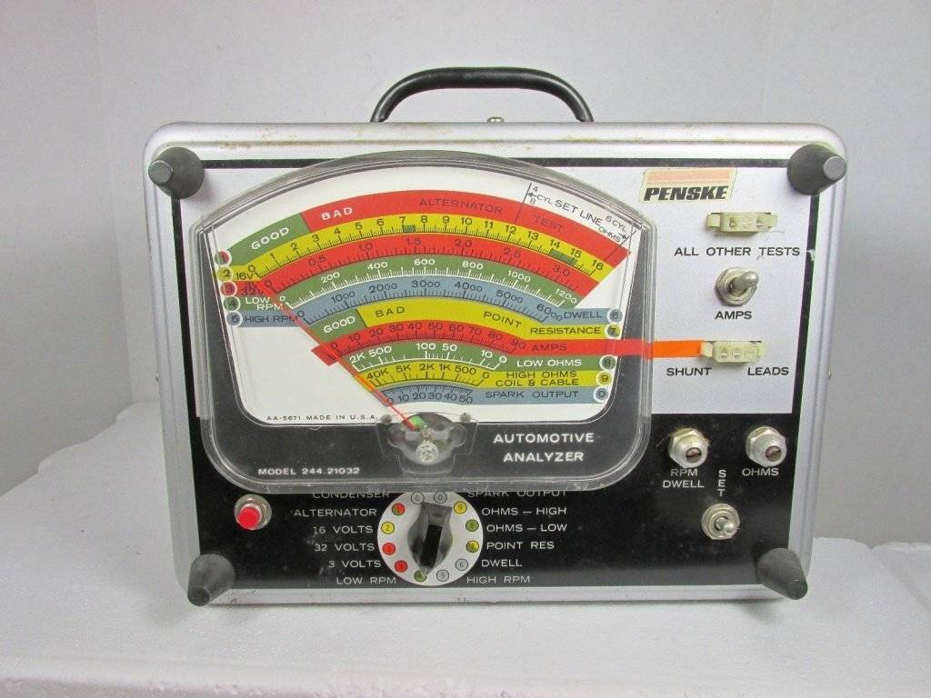

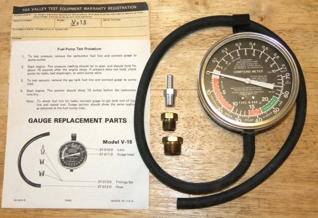

Well, I just got my old school tuneup tools in the mail...now I can do these upgrades and set everything up properly.
