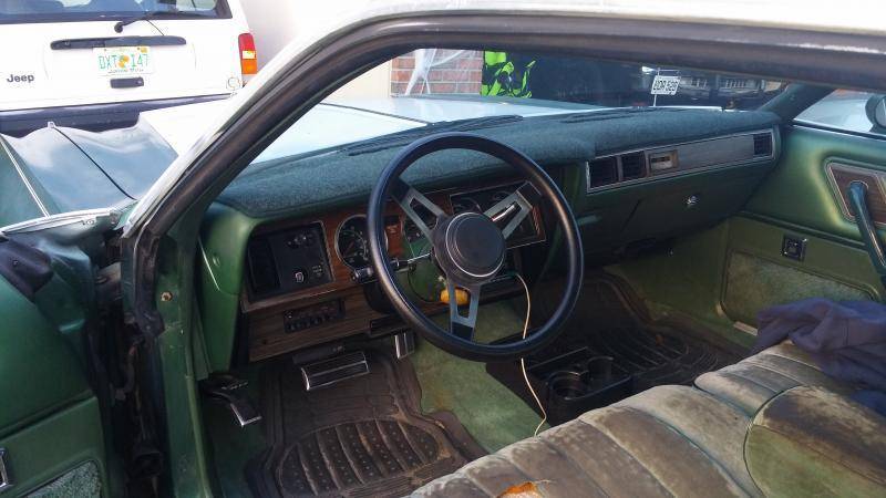

Other then that the cars been doing good. I picked up a Grant tuff wheel a while back and put it in. Not really impressed with it (cheap!) but much better then the old cracked wheel.
