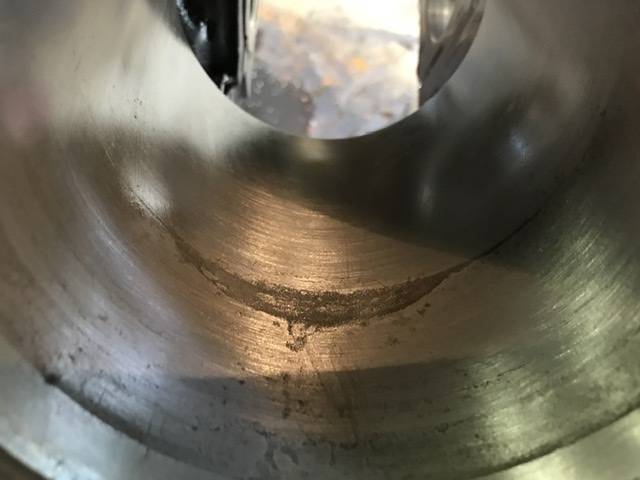

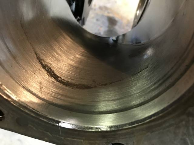

Well as I was honing the cylinders it revealed this. I could see it & slight feel but a glaze over it didn’t reveal it that bad. After I honed & wiped down its pretty coarse. #4 hole. Looks like some water sat on top of the piston. Run it or have it bored ?
That’s far down From the top, not a problem At my house. This is a budget build right?
