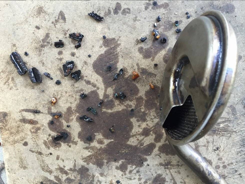

I drop the pan and yes, there was some junk.

Show us a picture of the junk so we can advise on what we see and let you know if there is anything else you need to do inside the engine, cheers.
Here's the junk but I belive it's old junk as some of it seems to be hardened corc valve cover sealing and I never used corc valve cover.
No metal what so ever, it's far to light...
Check those yellow bits and see if it is plastic, if they are that means your timing gear will need replacing.
