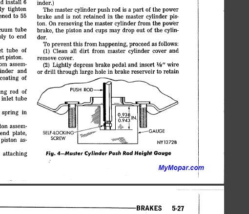

Through some brake troubles one thing I wanted to check was the power booster push rod length to validate it is properly set
In the 66 shop manual I could not seem to find the specification.
This is a standard drum/drum single power booster.
What should the power booster push rod length be?
Thank you!
