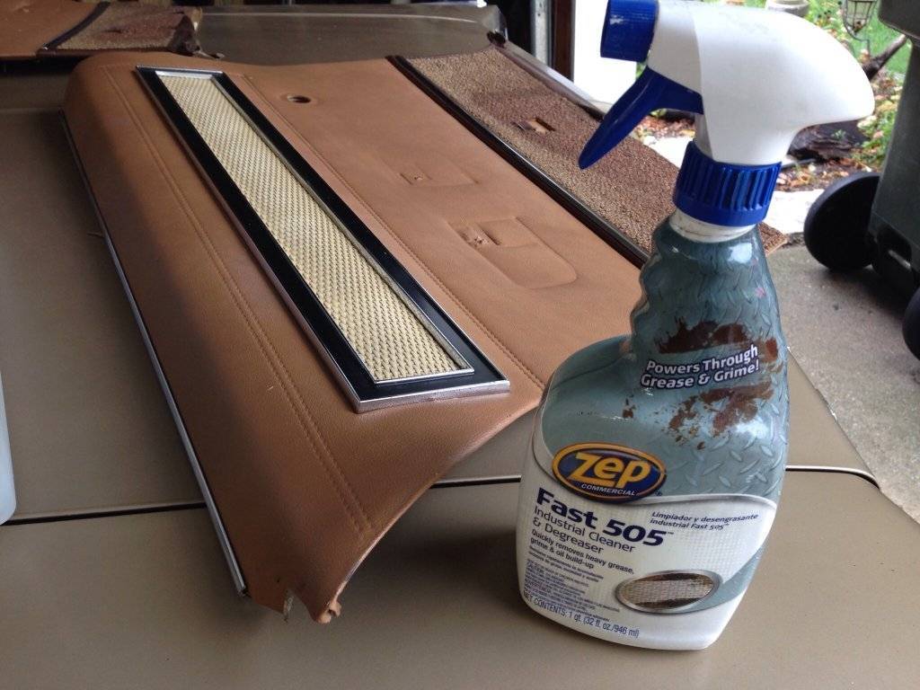

I used this to remove old hardened grease from my quarter window guides and regulator. That old stuff was rock hard and binding up the rollers and crank mechanism.
I soaked the assembly i removed from car to repair with this stuff and used a brush on the stubborn stuff. Everything cleaned up like new.
Since i had the interior panel off the other side too. I sprayed everything i could get at and let it soak overnight. I used a shower style back-brush that fit down thru the top with the window fully lowered and scrubbed everything i could reach. Lay a rag along the bottom of the door or qtr. panel to catch the crud.
I used a white lithium & silicone grease, ran the windows up and down a few times to spread the stuff, they work fine now.
