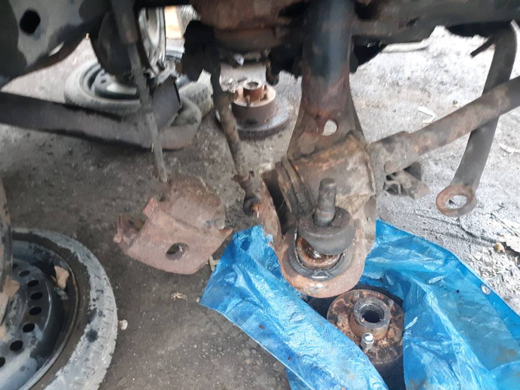

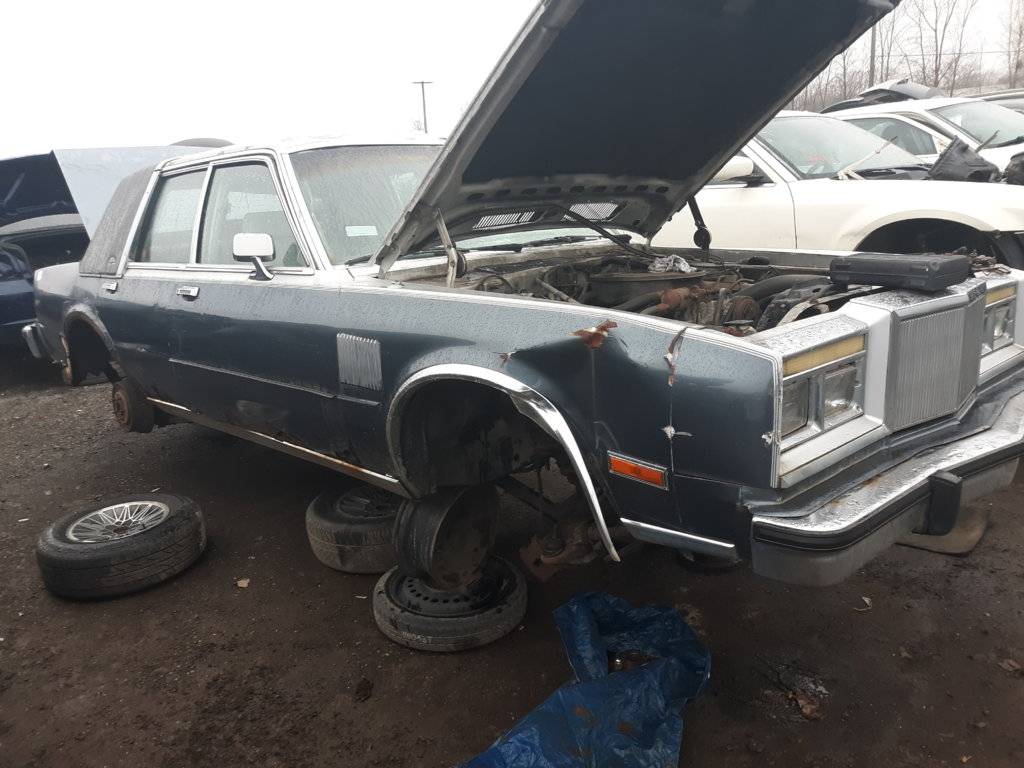

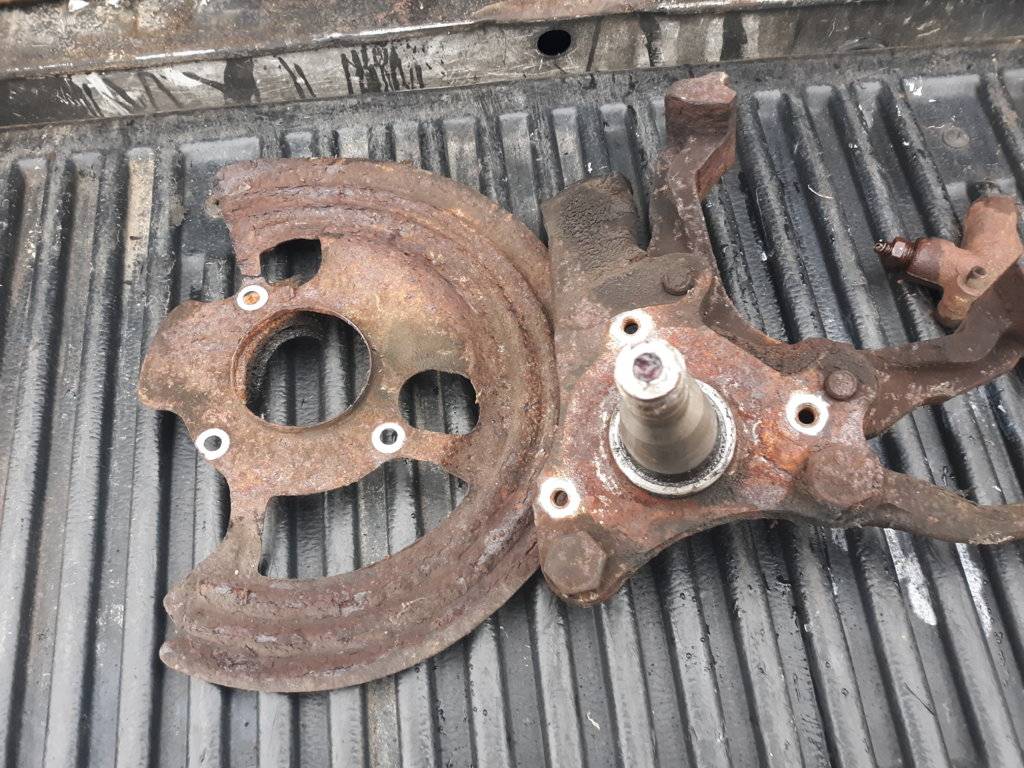

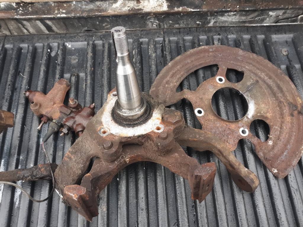

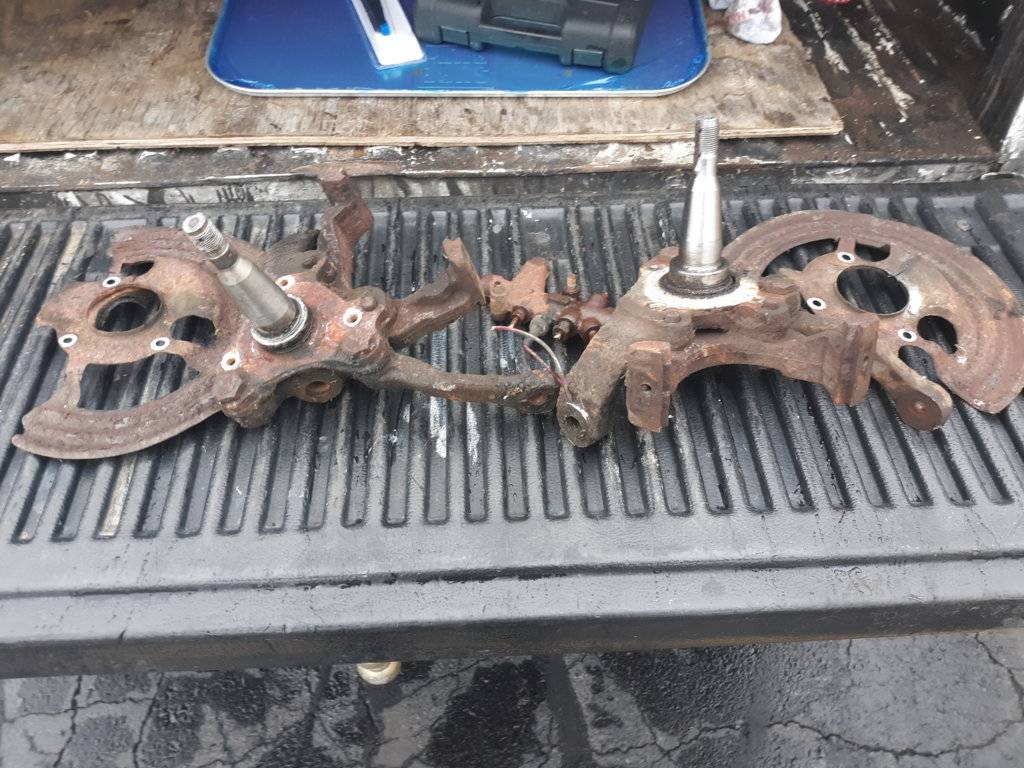

Spindles. Caliper brackets and backing plates from an 86 Fifth Avenue to put disc brakes on my 61 Chrysler.
Thanks to Jim Rawa for the information on how yo do this swap on an fl car.
Cut both tie rods a half inch, then cut the sleeve a quarter inch on both ends. Bolt it all together!

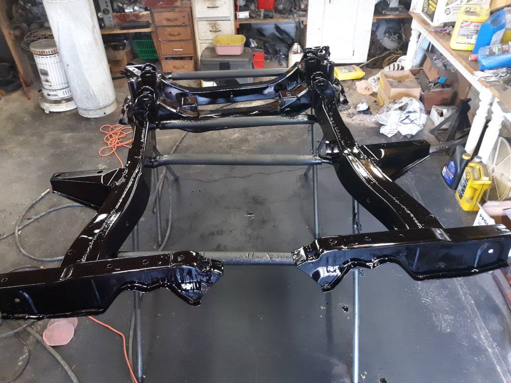

More work done to my 61 Chrysler Newport two door hardtop!

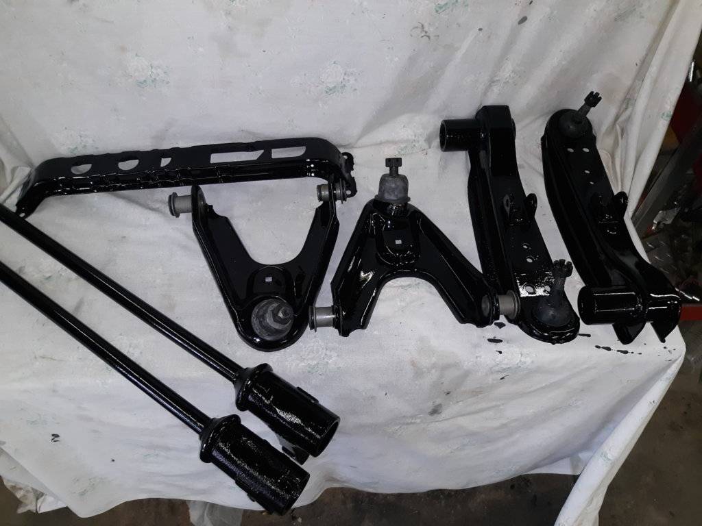

Subframe sandblasted, coated with chassis saver, then painted gloss black! Same with all suspension componets. Wheel spindles and disc brake caliper brackets and backing plates coming next.
All new suspension parts have arrived.

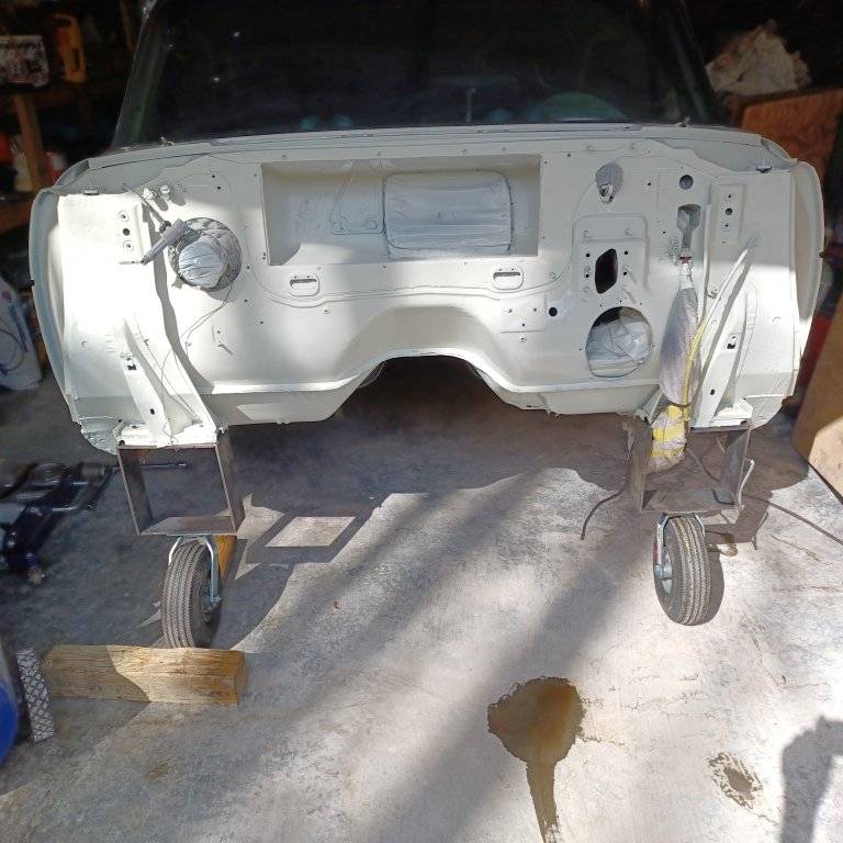

My idea I rigged up to get the car, less subframe, up on the trailer.
Would have worked flawlessly had my friend not mounted boards on his trailer to keep car doors from bumping fenders when opened.
Made it a little but of a project. Wish I'd engineered it differently. But without that wood step up on the trailer. Would have performed flawlessly.
