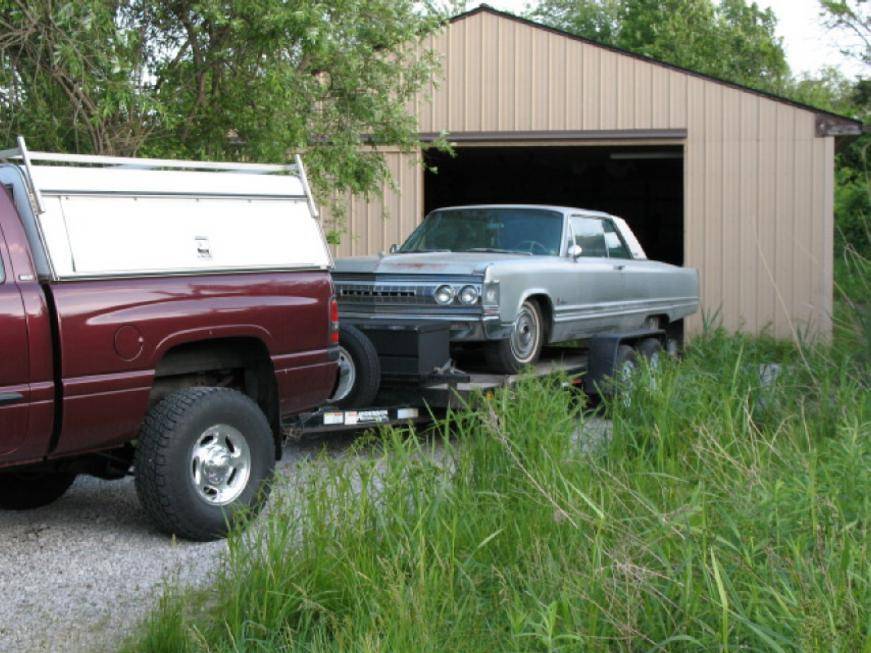

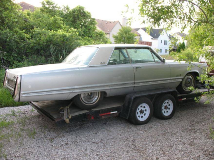

Pulling a Fusie home this weekend...

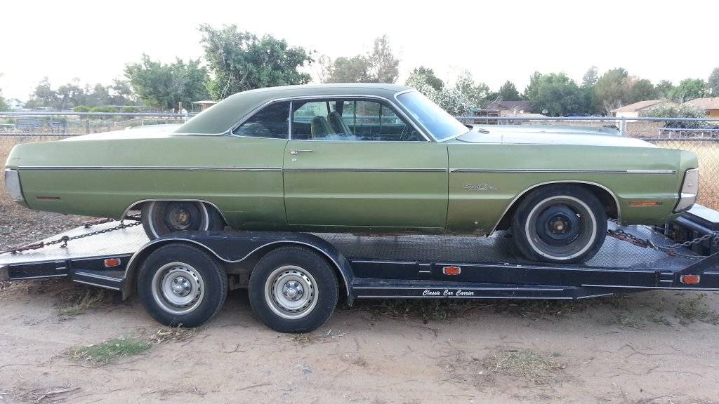

The average american car of this era was about 60/40, in my experience I needed to put the car till the front bumped something just to get it to fit. Now if you have a long trailer, center the car over the wheels and you probably be fine.
Alan
Level trailer, 3 hour drive from Kingman AZ to home 70-80 MPH and didn't even knew it was back there. Never had problem even with big Chrysler's and Imperials.
20160501_182638-jpg.83381
I would have been tempted to back the car onto the trailer. Get the engine sitting closer to the trailer axles.
I'm pulling it with an 04 Dodge 3500 Cummins diesel long bed so tongue weight isn't a problem. Frontwards, backwards doesn't mater as long as the trailer is level.
I still have semi on the brain and see everything in terms of 5 axles and 80,000 lbs. GVW. Like said above, I'm probably over thinking it too. :p
Recipe for disaster if pulling over hills ... not enough tongue weight. Especially for a big block car.

Gotta disagree with ya.
The center of gravity of the cargo goes over the trailer axle.
I'm not a fan of trailers like Chris'. I like to see the wheels midway on the deck, The added length for the tongue and the typical distribution of most cars puts the right amount of weight on the hitch. I'm sure that trailer tows great, the wheels being further back reduce the chance of fishtailing but you need to muscle it with a bigger truck, not sure I'd want that trailer behind a F-150.

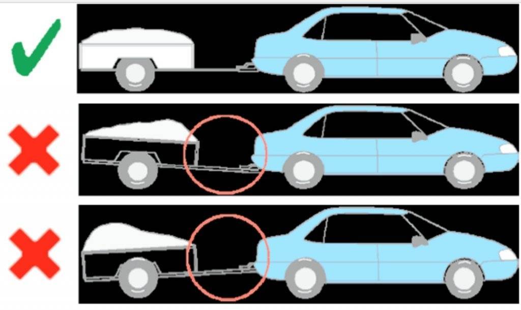

I think equally important is the hitch ball offset, not all trailers have the same ball height, the proper ball mount offset is needed for the tow vehicle trailer combo. Trailer should be level, they sell the ball mounts in different offsets, I have three so I'm covered depending on the trailer.
I guess I'm just overly cautious when towing. After I'm loaded I go around the block with left and right turns, check everything, after 40-50 miles stop and check everything and again at every stop for gas or food and again when leaving motels.

Backed in and towed beautifully for a cross-country return trip., and I still had about 10% tongue weight (850 lbs).
Loading and towing a car, (with the engine in it), backwards is something I have done in the past but certainly would not recommend for anyone with just basic towing experience. The trailer can become very unstable at highway speeds, even with adequate tongue weight. Once the sway starts your pretty much along for the ride.

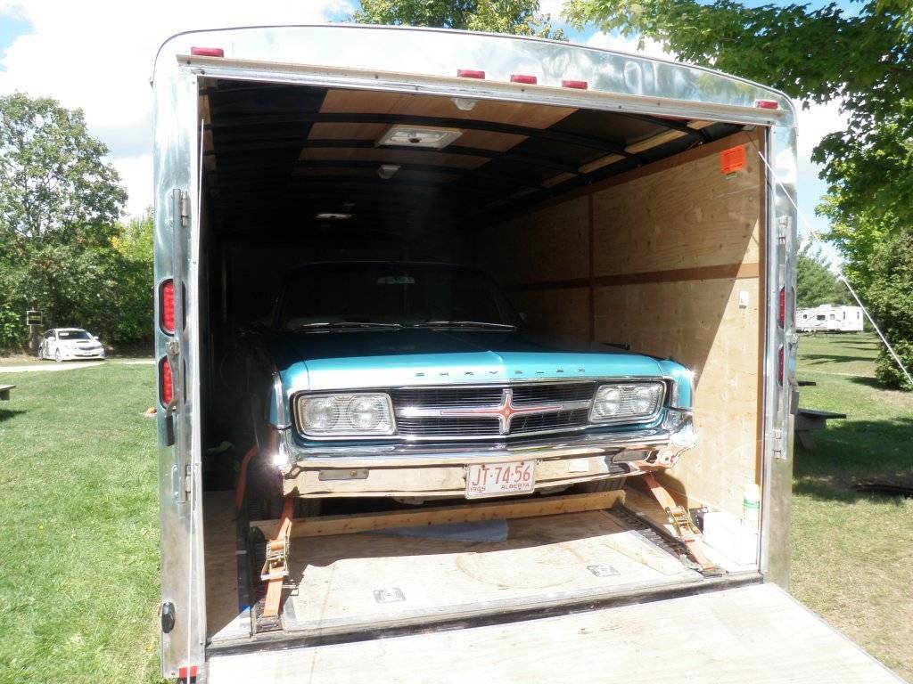

I used a buddies trailer when I brought the Imp home and had I known how badly it was going to tow I would have pulled the tool box off so I could have gotten it further towards the front. I'm glad it was a relatively short trip.
As you can see, when put in nose first, the forward weight bias is substantial on my trailer. Tail first gives pretty good distribution for a C body. In both instances, the car was about 12" from the rear door. I would really have liked my trailer axles to be about a foot farther forward, but that would have made the tongue weight too low on an empty trailer.

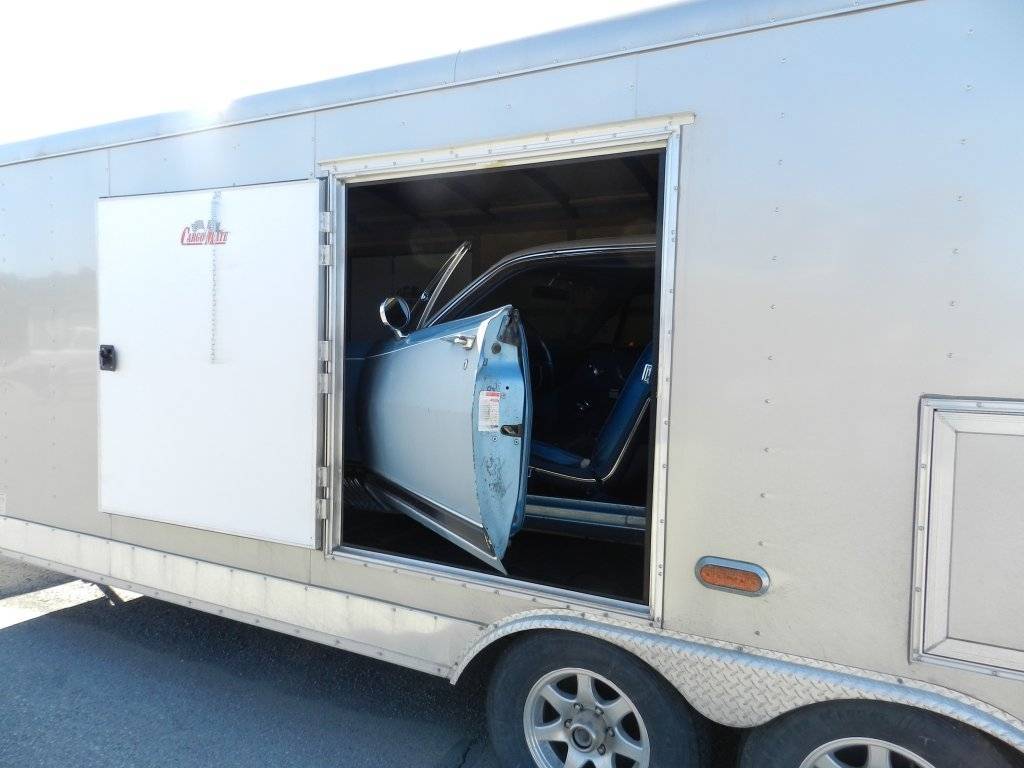

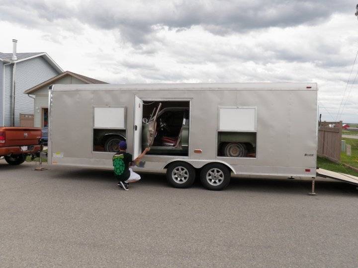

Were those access doors located specifically for C-bodies?

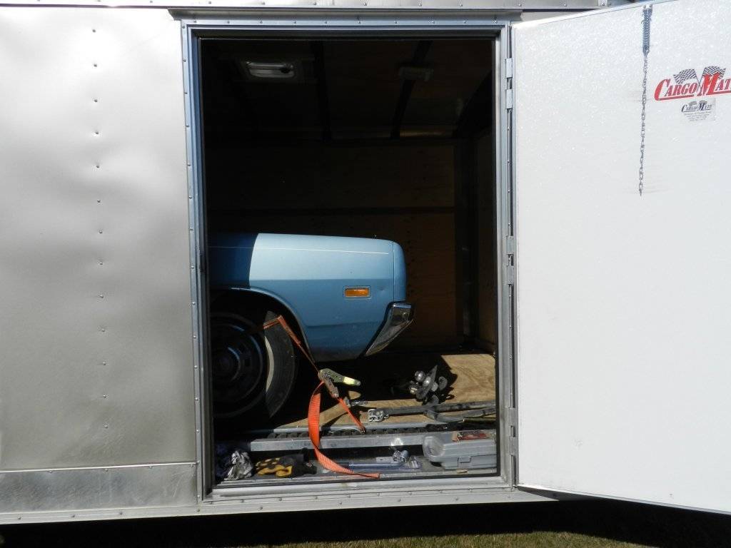

Yes. I measured up the car and gave the specs to the dealer. I gave him the centreline for the back wheel opening, the rear edge for the escape hatch (for a two door) and the centre for the front wheel. I wanted to use wheel straps and had no desire to crawl around. The full length E-track is a godsend. The back bumper is 12" from the ramp, and I have a little over 2' in front of the car. I waited 8 weeks for it to be built and shipped.
