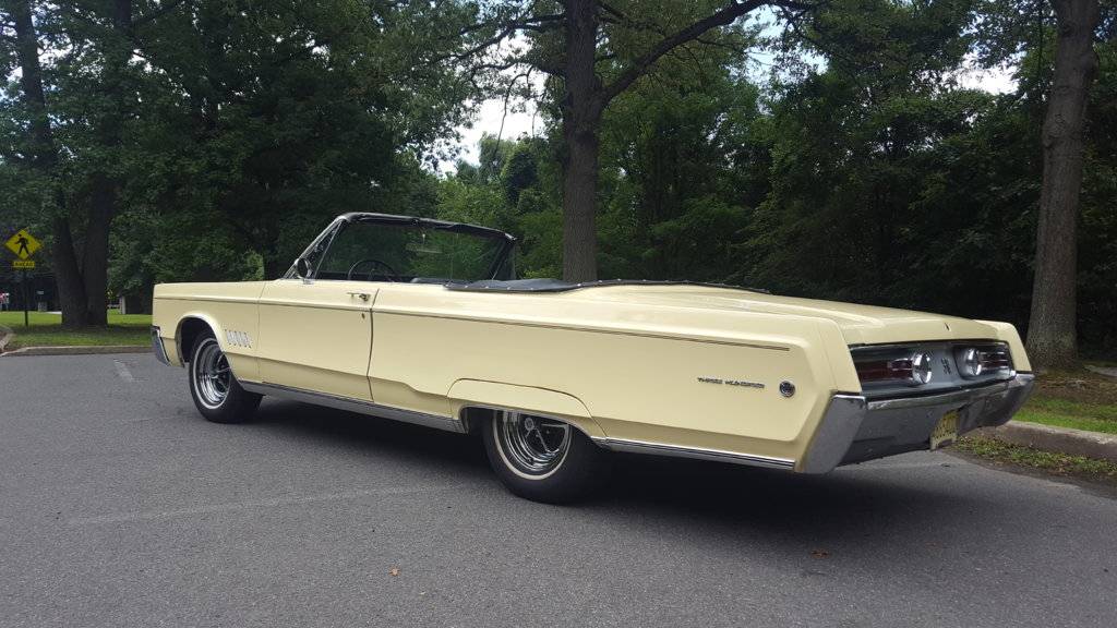

Put Magnum 500 wheels on my '68 Chrysler
JC68vert300
Apr 4, 2017
1,107
1,749
Ocean County, NJ

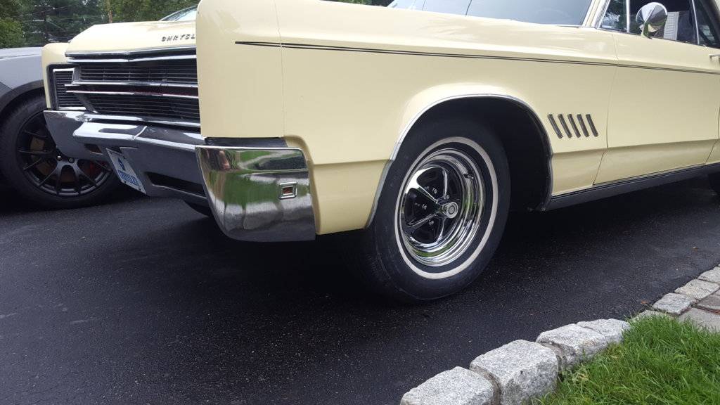

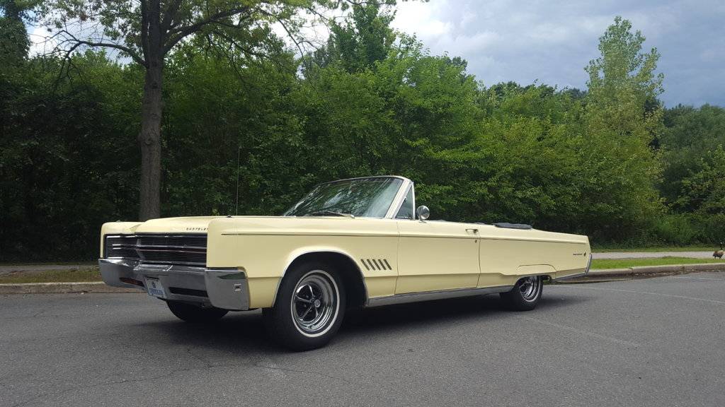

Just had Magnum 500 wheels mounted on the '68 300. There have been more than several posts on here questioning what size to use. In '68 you either had 14 X 51/2 inch wheels with drum brakes or 15 X 6 inch wheels with disc brakes. I know some have discussed going taller and wider. I chose 15 X 6 wheels to stay with a size that was offered at the time, and to keep the stance/wheel well set back as would have been from the factory.
Car looks great with those wheels. Great choice. I’ve always liked them.
Now the bad news. There were no 15” chrome magnum 500 wheels offered by Chrysler.
I know...only 14", I was going for factory size so it would sit properly. I don't care for the '15 inch disc wheel cover.

What backspacing on the 15x6 wheels? Just curious. What tires did you use?

The back spacing is 4", the tires are P235/75R15, Cooper Trendsetter.

I'm a purist with wheels, but still think these look nice, and also "correct." OK, so 15" Magnums weren't available from Chrysler in '68, but it still works just fine on the car, and looks appropriate on them as well. 15 X 6 definitely keeps the right stance. Beautiful 300 convertible!
