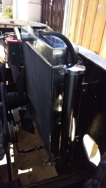

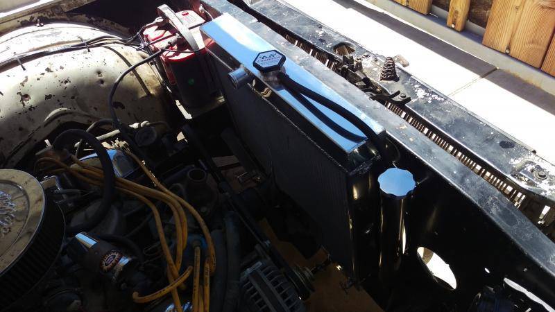

I had the same problem nobody that I found made a radiator for my 65 Polara. I did find that a 1965-67 Dart 4 core from Champion radiator
Was the same size and the only thing I had to do is redrill the top holes for the radiator to mount to the core support. Everything else worked fine.
The top hose says it is centered in the radiator it is not it is about 2"-3" to the left of the the radiator cap. I just went to the parts house and looked at all there top hoses till I found on that would work.
