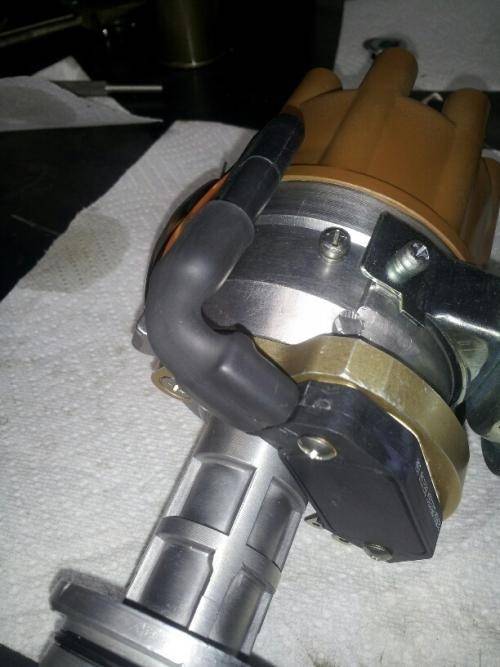

These work really well but here's an important tip, don't use an oil filled coil in the stock horizontal mount. The HEI module will make the coil run hot, and while laying horizontally the windings aren't covered with oil. You WILL burn out a coil. I know, I killed two flamethrowers in that manner.

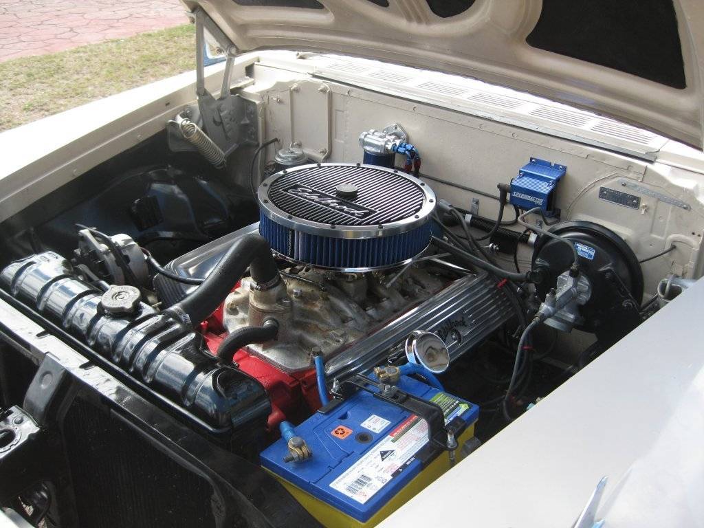

I've been eyeballing a lot 383's, have seen a couple with vert mounted coils, they look pretty good in that position. Am also playing with ecore coil mounting as an option, ecore was in Phoenix setup I had.
That's not a 383

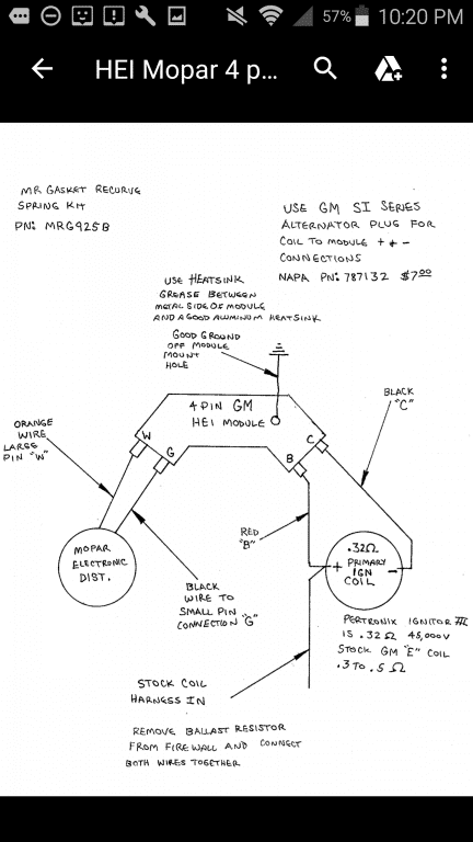

The HEI is designed to use a low resistance primary type coil. As I understand it, when you start using a low resistance canister coil, you need to use a ballast resistor to make the coil live. If you use the E coil, you won't need a ballast resistor.
Go to that link I posted above and also take a look. They answer a lot of questions.
The point of the ballast resistor, and only point of a ballast resistor was to lower 12V primary to 6V to prevent arcing and burnout of points. When everything went electronic, ford and chrysler got stuck on the ballast resistor. GM realized it wasnt necessary anymore because no points.
You can buy a pertronics ignitor lll cylindrical oil filled coil that has the correct ohms primary resistance as an HEI E coil. Dump the ballast resistor and hook the wires together. I myself also have the designed2drive bracket. Its a very nice piece, however i used a plug off an old HEI dizzy to the GM module, and soldered a mopar plug on the other end then used industrial heat shrink to seal up the adaptor. My reasoning is that if the HEI module goes poof, or the pickup goes poof. Its plug n play using an adaptor.
I also added another drain hole in the distributor body since your drain holes now hold the hei bracket. I also hollowed out my ballast resistor, and just soldered a heavy gage wire inside it, making it into a jumper wire that looks like a ballast instead of hooking the wires together. The other end of the HEI module to the coil is pretty easy too. A GM alternator plug from napa plugs right in. I got one w black n red wires. It was perfect.
HEI modules require 12V to deliver a good clean hot spark. Do not use a ballast resistor on one of these otherwise its not an upgrade, and would just waste your time.

Nicely done, very tidy. will copy

From what I've read, most canister type coils that have a very low primary resistance, like around .5 ohms, live longer with a ballast resistor in series to limit current and keep it from overheating. I believe that the designtodrive site even mentions this. A slightly higher primary resistance canister coil (over 1 ohm) can do without it. Again, this is from my reading on the subject.
If Pertronix has a low resistance coil that doesn't need it, that's great. I think an E coil is the way to go and the whole thing is a moot point. Then there is no issue at all and you can take advantage of all the HEI offers for a hot spark.

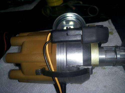

I myself also have the designed2drive bracket. Its a very nice piece, however i used a plug off an old HEI dizzy to the GM module, and soldered a mopar plug on the other end then used infustrial heat shrink to seal up the adaptor. My reasoning is that if the HEI module goes poof, or the pickup goes poof. Its plug n play using an adaptor.

My goal was another step in tidying my engine bay with increased performance being a bonus. I have experience with a 318 Poly engine in a 1960 Dodge Phoenix ( with after market ignition, Bosch style distributor with BIM024 module and Procomp e-core coil) which has reliably taken us on >1000km journeys throughout coastal and inland Queensland Australia in temperatures above 100F.
That setup I could not find for my 383 Polara but with the designed2drive/Moparmat2000 setup I am confidant using these commonly found parts, subject to suitable coil we will again be good to go.
What is the deal with that master cylinder on that car?
