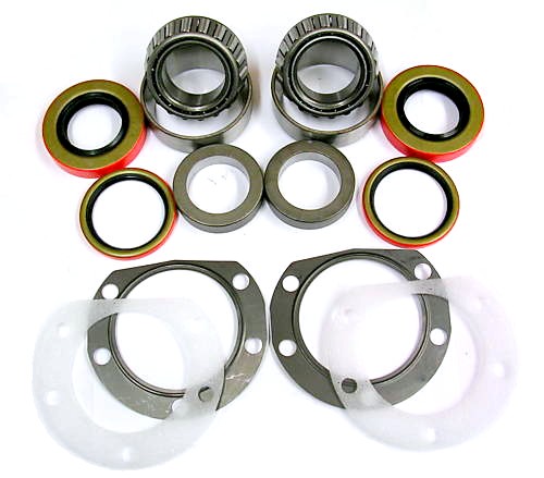

This is the photo from Doctor Diff for the axle bearing package for an 8 3/4 axle. What is confusing to me is that on his website, he says this package is for tapered axles, but as far as I know, those were discontinued with the 1964 models. So my question is whether the title for this listing (below) should really say tapered bearings instead of for tapered axle shafts???
http://www.doctordiff.com/tapered-axle-bearing-package.html
Has anyone actually installed Doctor Diffs repair kits and fixed the leaks and noisy rear axle bearings?
Bearings for the tapered axle look nothing like that.
I think that "tapered" in the web site refers to the bearings being tapered, which is the correct bearing for later rear ends.
I'd call or email them to be sure.
