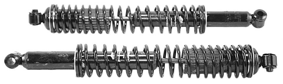

Monroe offers coil overs.
58577 :: e-Catalog :: MONROE® SHOCKS & STRUTS

My Fury had these (Midas branded) on it for more than 20 years and they didn't damage anything. The crossmember while not built like its for a truck is fairly stout & unless seriously corroded should be fine. I have Gabriel Hijackers on it now. Should it have new springs? Perhaps but to many other projects going on. Has anyone actually seen the crossmember damaged from shock choice? Maybe if seriously overloaded or towing.

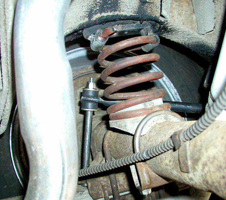

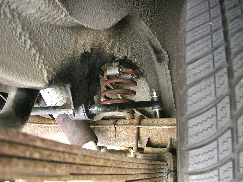

View attachment 432595 Nothing you do to a fusey suspension will make it a good-handling car by today's standards. Loading the upper shock mounts can produce some interesting results under the wrong circumstances. You can add hauling capacity and tighten it up with stuff like this, but that's going to be your best goal for a c-bod. Just enjoy the smooth ride!
Where'd that rear sway bar come from???? Inquiring mind desires to know!
I'm convinced that a good ride and good handling can be had in non-modern vehicles. The "bone" are already there, just got to add some muscle.
It's a generic/universal bar from Megs, IIRC. The install is a custom job, reversing the traditional setup, hanging it from the frame rails. I learned to weld at an early age, so metalwork has always been one of my hobbies. The C-Bod was my truck for a long time, before I could afford to buy a real pickup. :)
