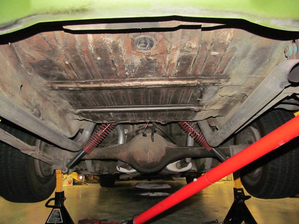

I once punched a '74 Duster pass side air shock into the trunk on launch. That car was not very rusty. The sheetmetal there is not designed for structural load. Metal fatigue will eventually fail it even under light load, over time.
I put coil overs on mine. They have served me well. Still want to replace the leaf springs though.

FWIW, the upper shock mount crossmember might not be a designated "load bearing area", but each time the shock absorber resists compression and extension, from wheel/axle movement and/or body movement, there will be a force applied to that metal which could probably far exceed, momentarily, any load which an air shock of load-leveler shock might exert upon it. If the upper mount bolts might be loose, even worse. End result? Metal fatigue, either way. Probably even worse if the car had seen salty winter roads rather than dry Spouthwestern climates?
