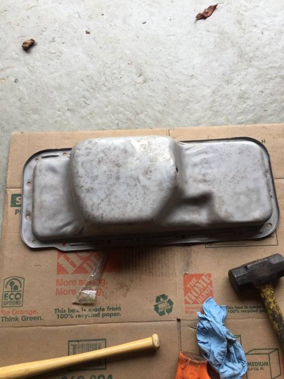

The new engine was going in. Took a 2x4 on the pan against the dents and hit the 2x4 with a hammer. It looks like a pan that never had a dent.

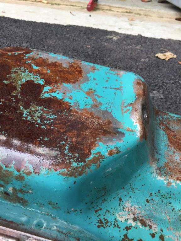

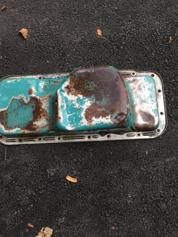

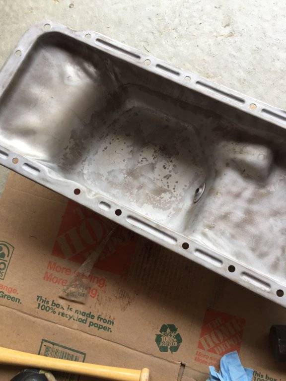

1965 413, any old school ways to remove this dent it's pretty big. doesn't need to be perfect just needs to get the motor some oil.
no real access inside through the drain plug, I was thinking maybe welding some bolts on the pan and pulling on those? I've never tried it tho.
the only way to do it right is to drop the pan & hammer it out .i had a dent in my 440 pan i used a 3lb cross peanung hammer & a 2x4 & a brass bar i put the pan on a sand bag & stsryed pounding but i was carefull not to braek through the pan

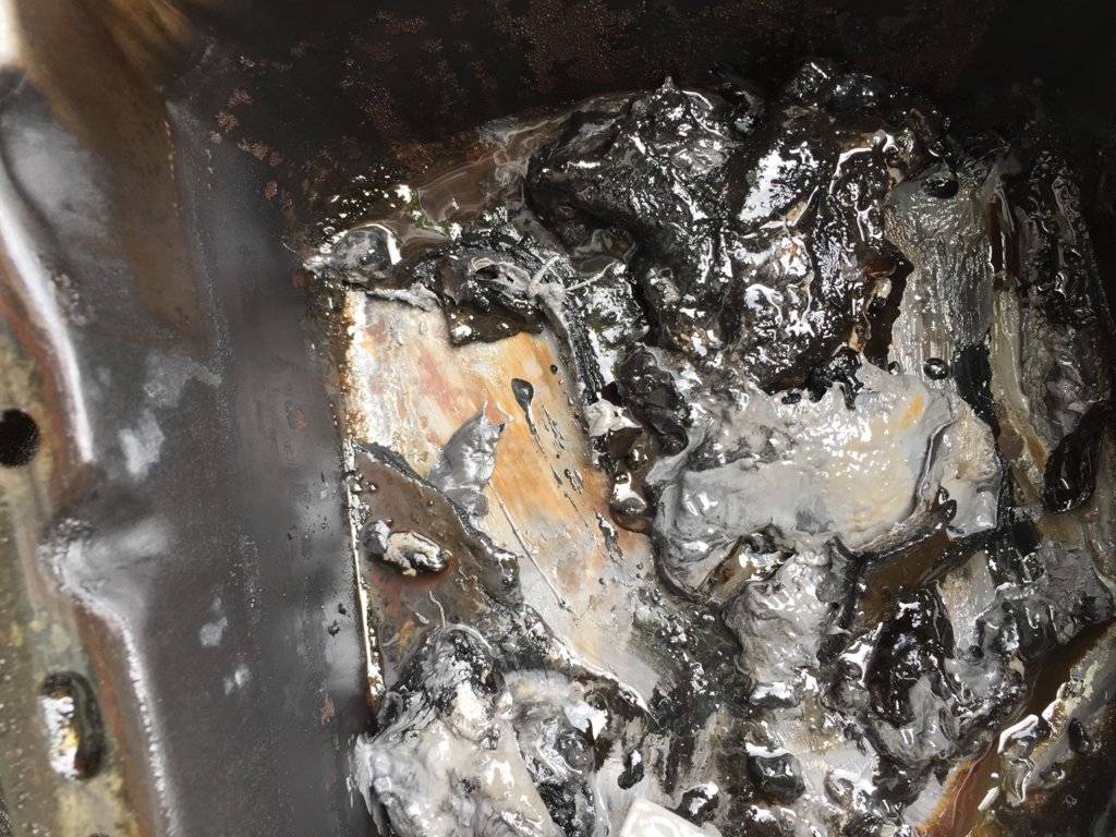

Mine had a large dent in it. Since I had the entire front end apart I just pulled the pan, cleaned out the thick layer of grey sludge and pounded it back in shape. It came out looking like new after painting.
