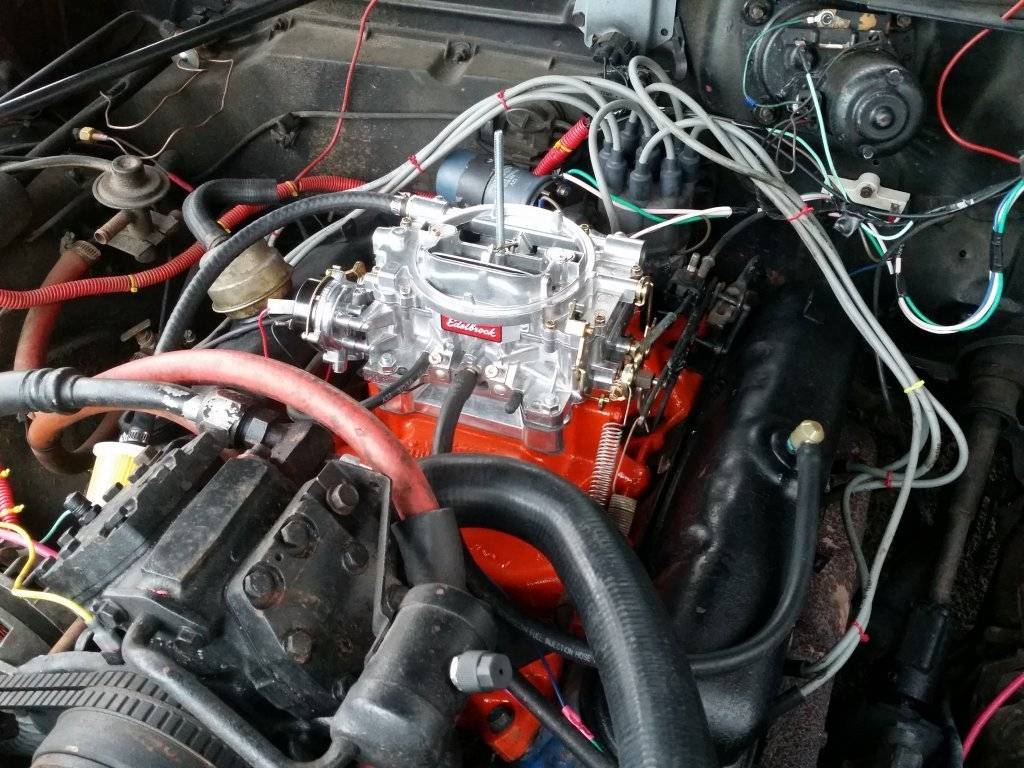

I finally had the chance to install an Edelbrock 600 4 bbl Carb and replaced the Intake. It gave me a lot more power, but I should have followed the advice of replacing the headers and cam. But I really need to get it reupholstered and didn't have the funds. But I will admit that y'all were right. Thank all of you for the advice.
On a side note, the new carb has an electric choke and I have to get into the habit of not patting the gas before cranking it.

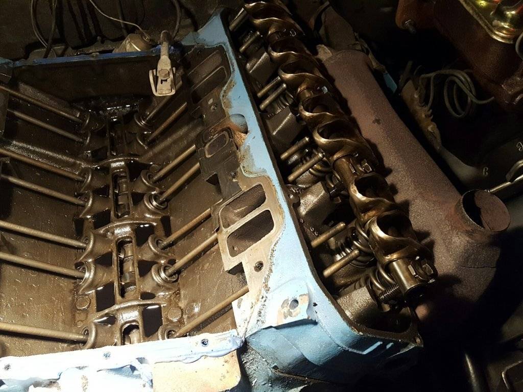

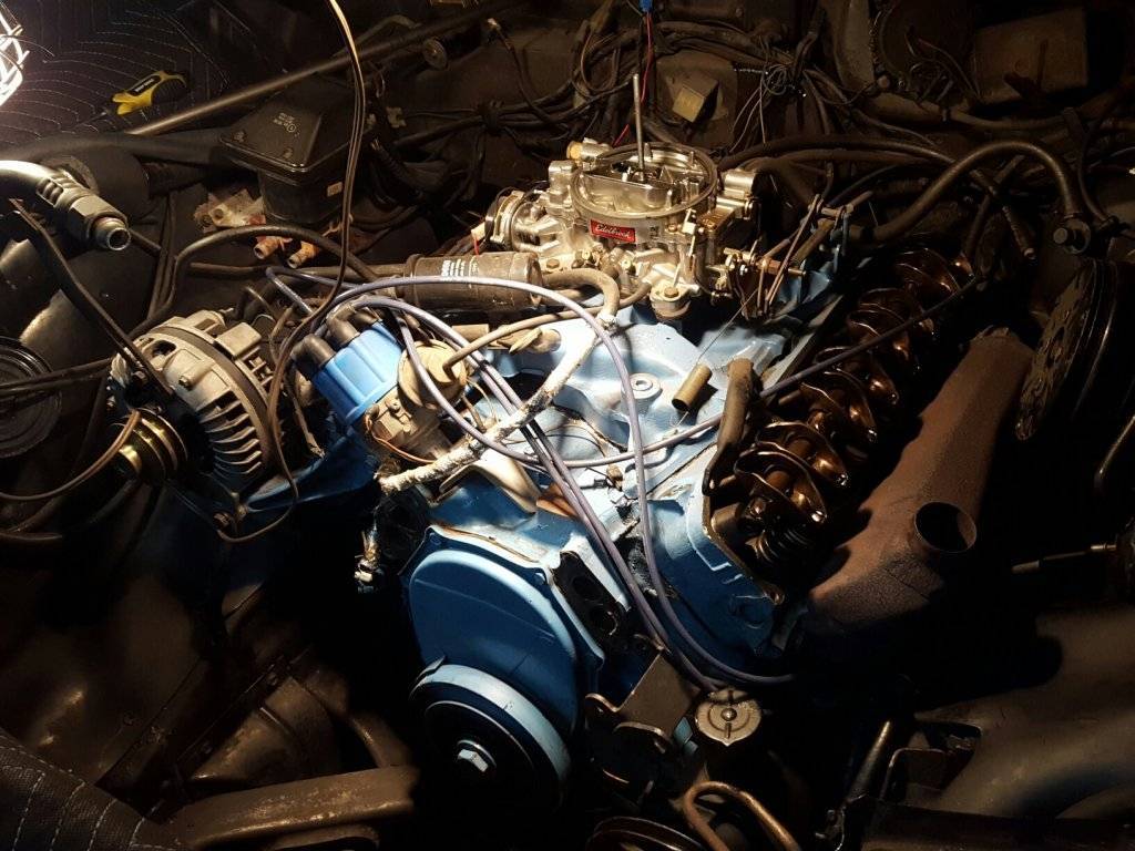

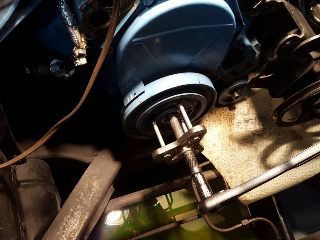

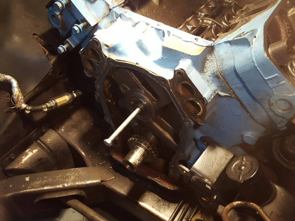

I I removed my cam today. Following are some pics of the progress:
More pics of cam removal.
Next step is to remove the heads, but that's for another day.
