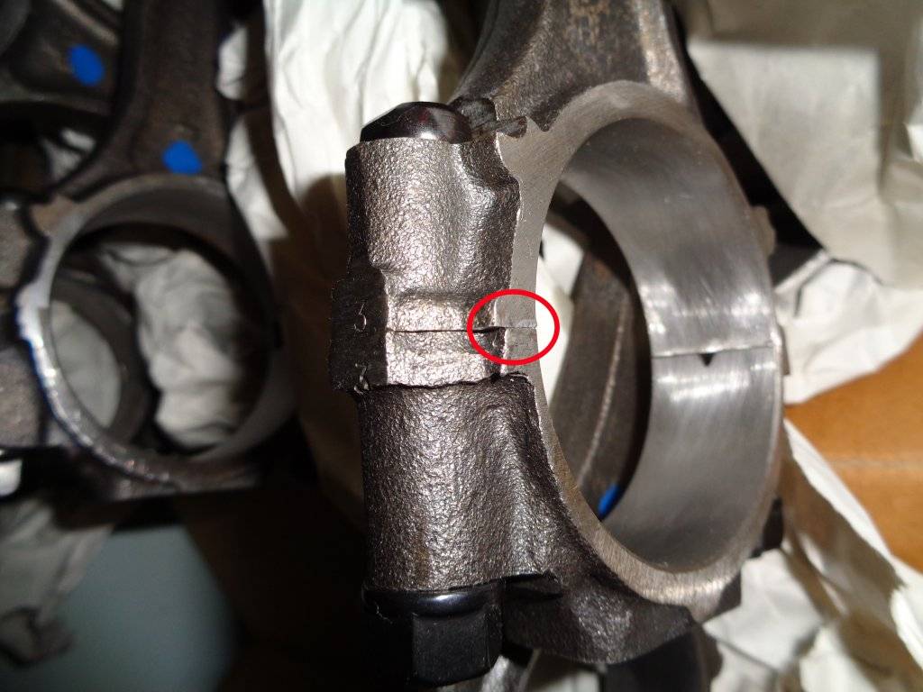

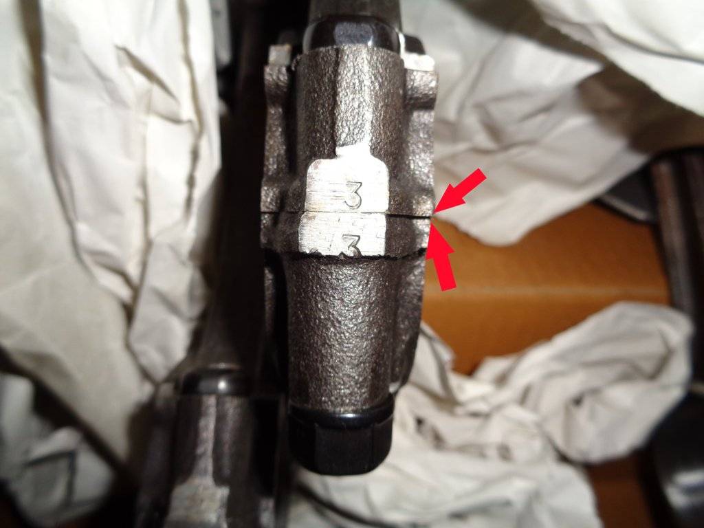

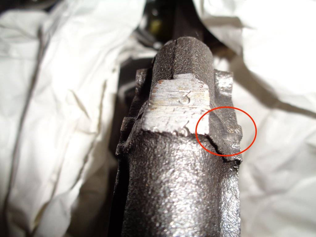

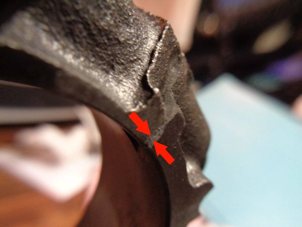

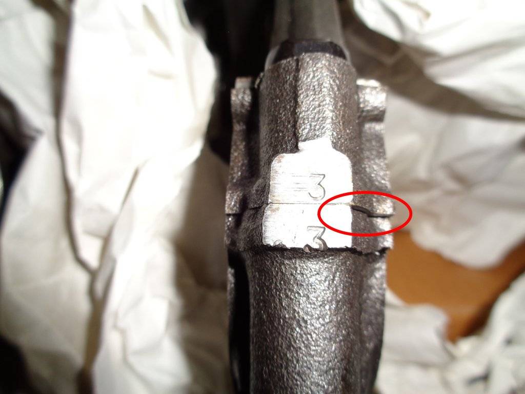

resized rods. face has dings
For a stock application, those nicks are not an issue.
If this was a full tilt race application, theoretically, a crack could start at one of those nicks and cause a failure. Odds on the Lottery are probably better than that scenario tho.
