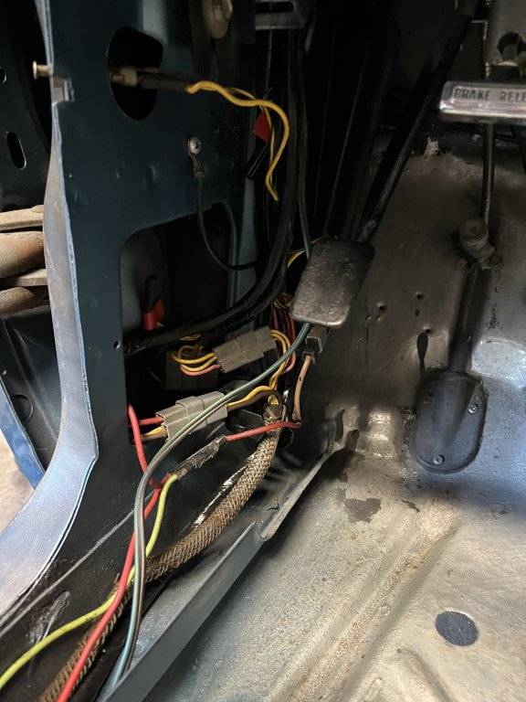

My advice is to make photo copies of the FSM wiring diagrams, that way you can mark wires etc while you work.
At least that's how I do harnesses following the KISS method..
You're really making me want to work on my Ragtop, I've had it 12 years in August.
Yes, that’s a great idea, especially since the FSM shows diagrams that include accessories that I don’t have like power locks and a console. Following the wires by sight gets real confusing fast.

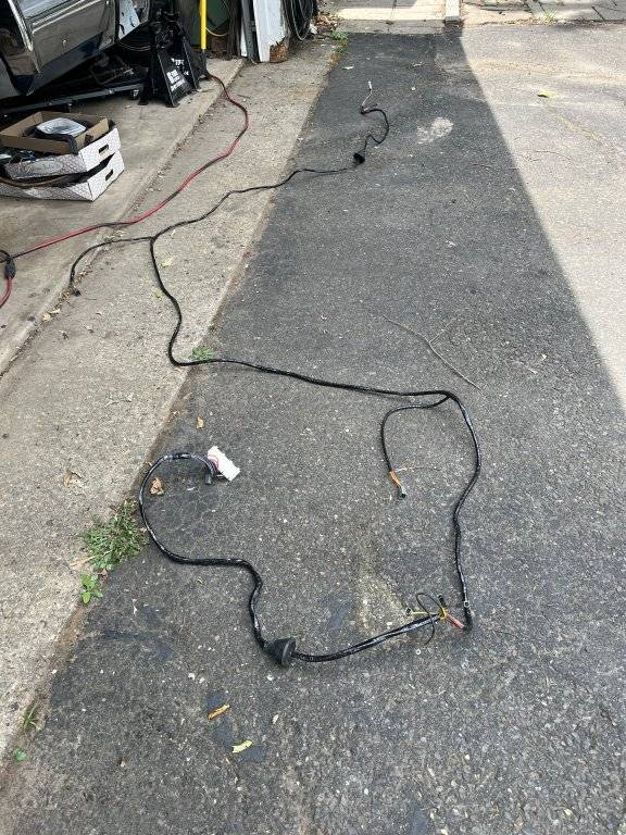

Does anyone have a favorite harness tape they want to recommend? I just ran out of the 1 inch shiny non-stick vinyl tape I had been using for behind the dash and I can’t remember where I got it from. I’d like to get cloth tape for the trunk harness, it’s currently a woven tube like material that is falling apart.

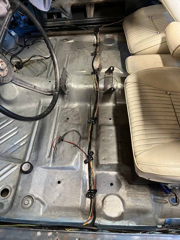

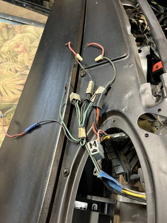

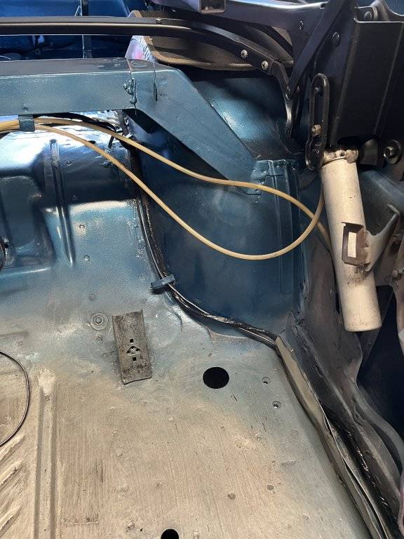

Here is the power window harness re-taped and ready to go. I originally thought it got tucked behind the dash, but it actually crosses under the seats and then doubles back to the hinge pillar through to the doors.

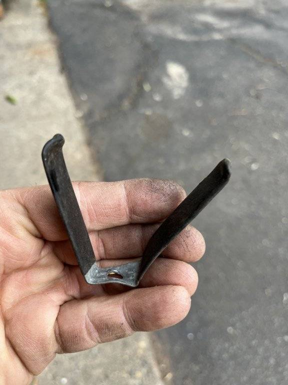

Also, what would you call these, and does anyone know a vendor than might have them? They screw to the floor and hold the harness down under the carpet.
The tape is getting harder to find. Search "non-adhesive vinyl harness tape" on eBay. Here's some: 2 Rolls Factory Electrical Non Adhesive Wiring Harness Friction Tape Oem A Nos | eBay
These guys have your harness clips. Dynamic Renovation - All Mopars Nice folks to deal with too.

I got it off the rack of wire at NAPA, they had both types, the non adhesive tape and the friction (cloth) tape.

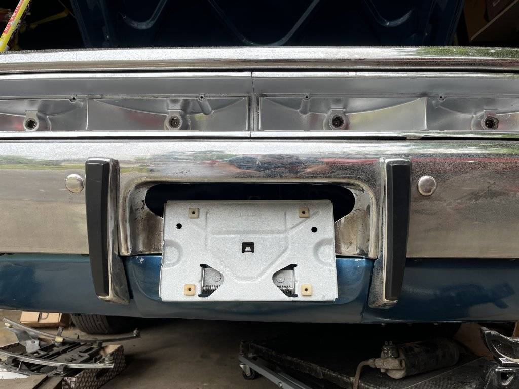

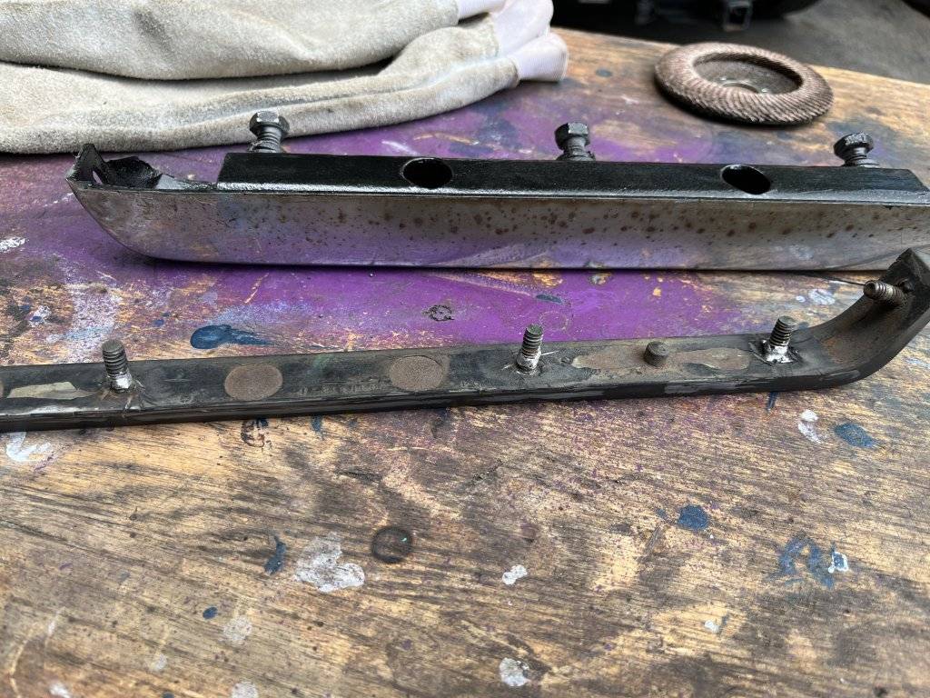

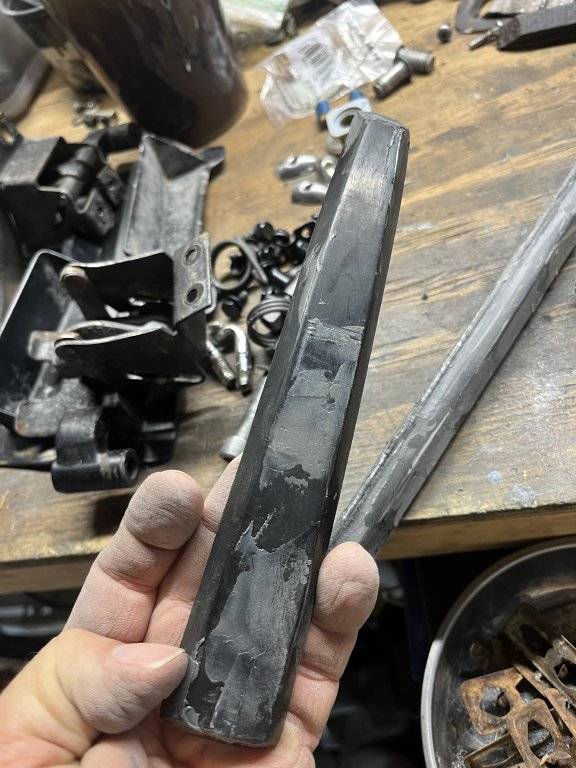

I always liked the small bumperetts and the bumpers had the holes so I’m putting them back on. Not willing to pay hundreds for NOS pieces, I decided to patch up the rubber and repaint with some satin black. I don’t remember how these came off, but getting them back on has been a challenge. Top bolts, no problem, but there is no second hole for the bottom and I can’t figure out how to position the strange looking brackets.
JB Weld Epoxy:
View attachment 667922View attachment 667923
Of course the studs broke off. Time to break out the welder.

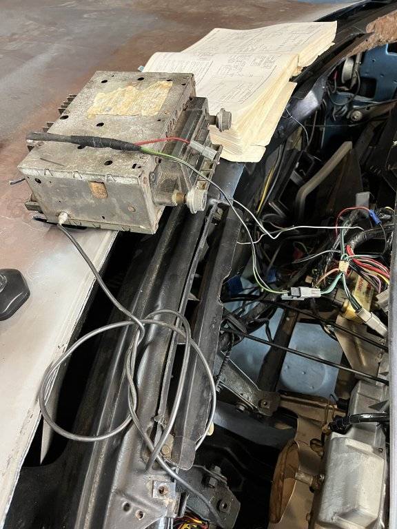

Took the week off, but now it’s a rainy day here in Jersey, so might as well do an update. After much testing, connecting, taping and stringing I believe I have wired the rest of the body. I have it yet powered anything up, but hopefully it doesn’t all end in one big fireball.

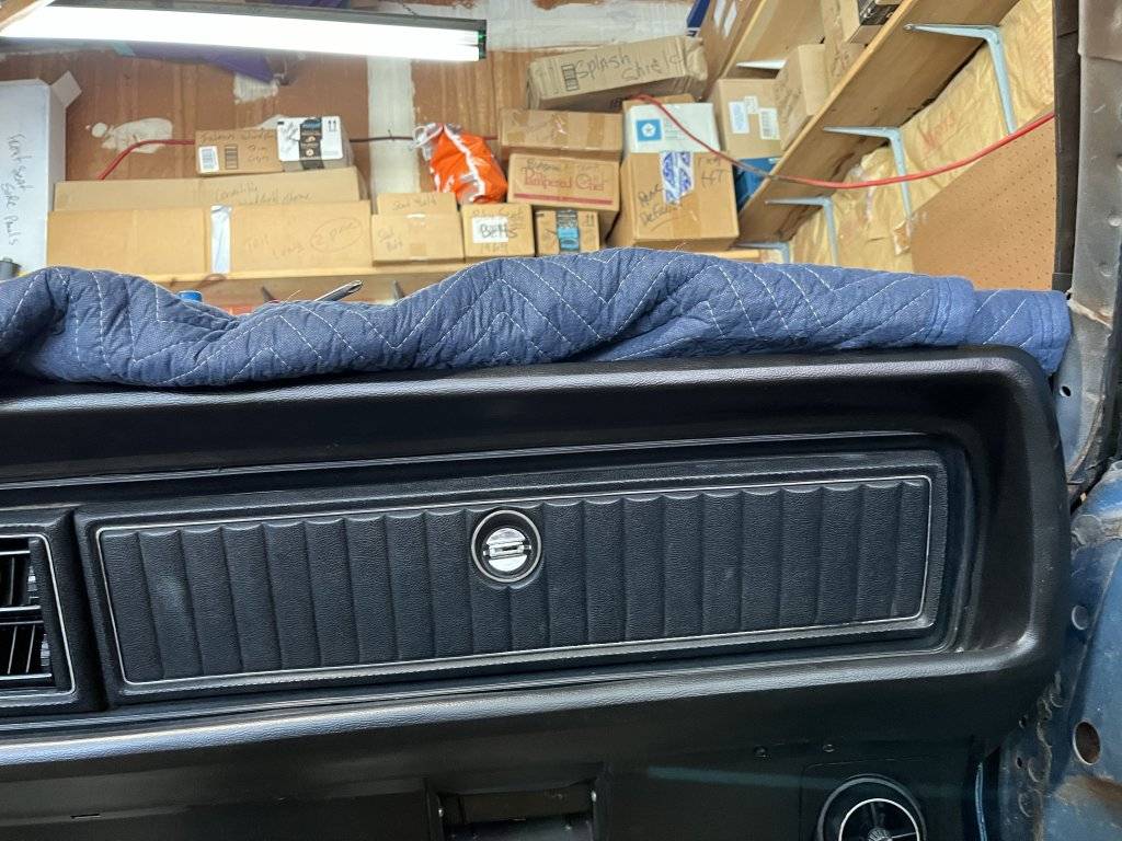

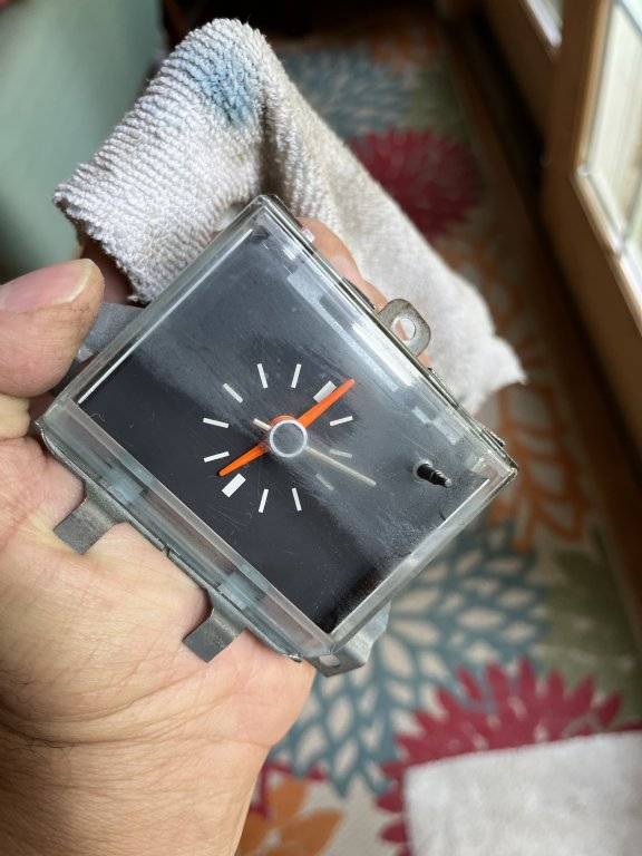

After last year’s marathon of priming and painting I found that some overspray must have billowed up into the covered dash coating the gauges. To say I was disappointed is an understatement. It did give me an opportunity to finally finish installing the glove box, ash receivers, radio and speaker. I also was able to get the clock to work! There is an excellent You Tube video on the topic. I had no idea it was a self winding clock where a set of points make contact every few minutes sending a charge to a plunger that winds the spring.
I didn’t want to risk the old plastic with solvents so I used the headlight cleaner PlastX and was impressed how easily it removed the overspray from the surfaces.
Ugh, more unfinished wiring. My son got the radio to work briefly, but we couldn’t get the seek to work. Sometime in the future I will go for the upgraded modern internals, but for now I just needed it to fill the hole in the dash.

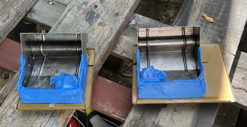

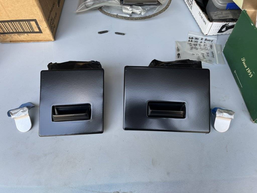

Ash receivers from the ‘73 NYB were in perfect condition, just needed a coat of Rustoleum Flat Black topped with Clear Matt finish.

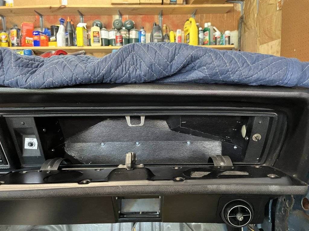

This freaking Glove Box liner! That’s all I’ve got to say on this engineering RubiX Cube.

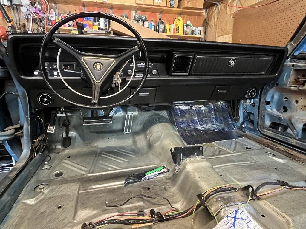

Finally after 14 years I have a completed dash.
That dash was a mother on mine too

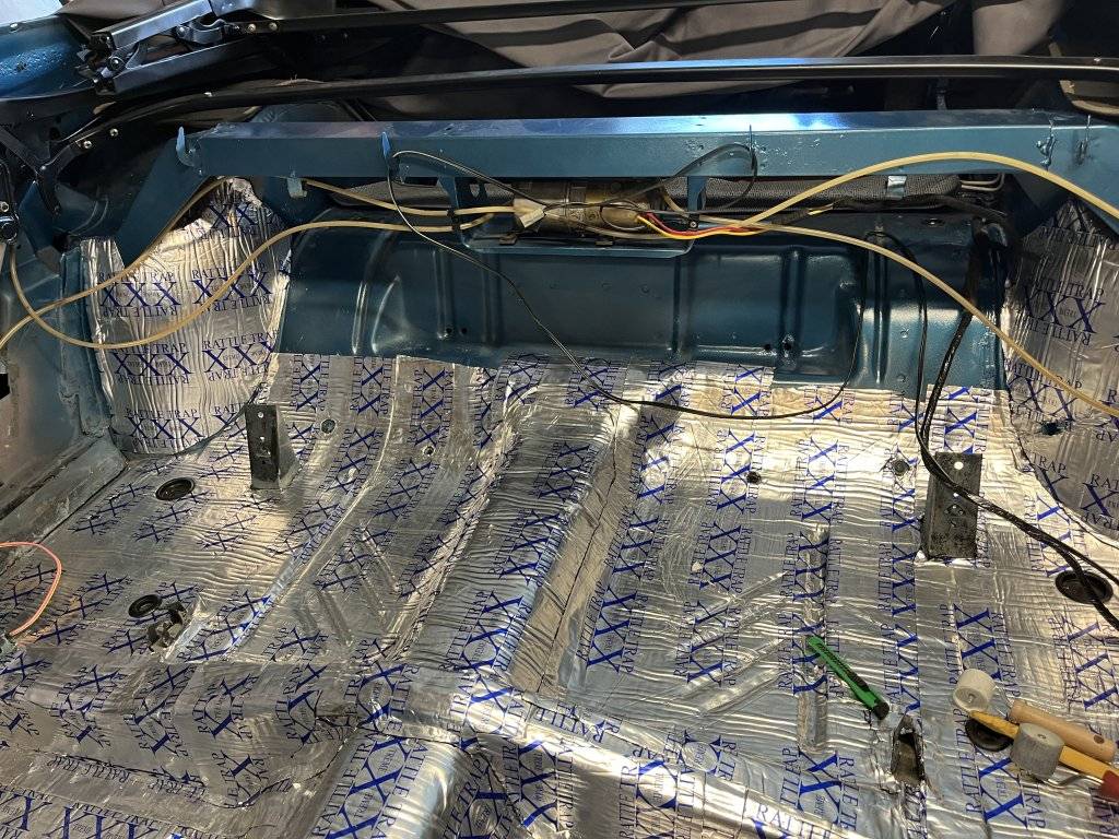

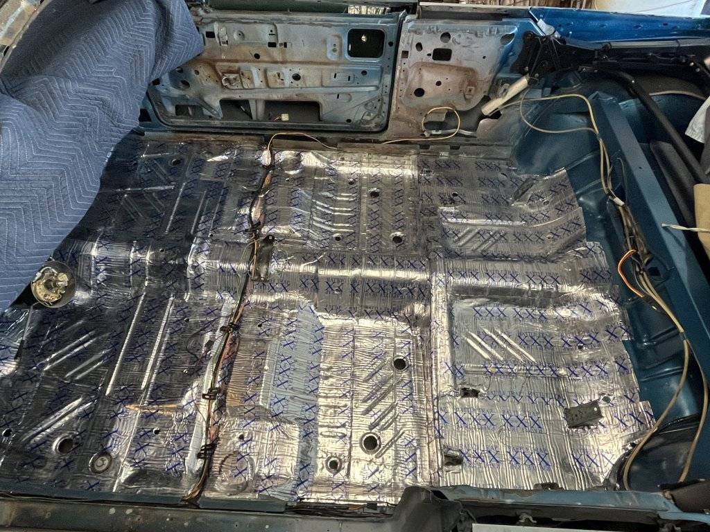

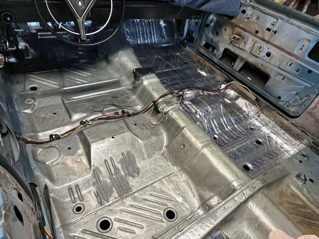

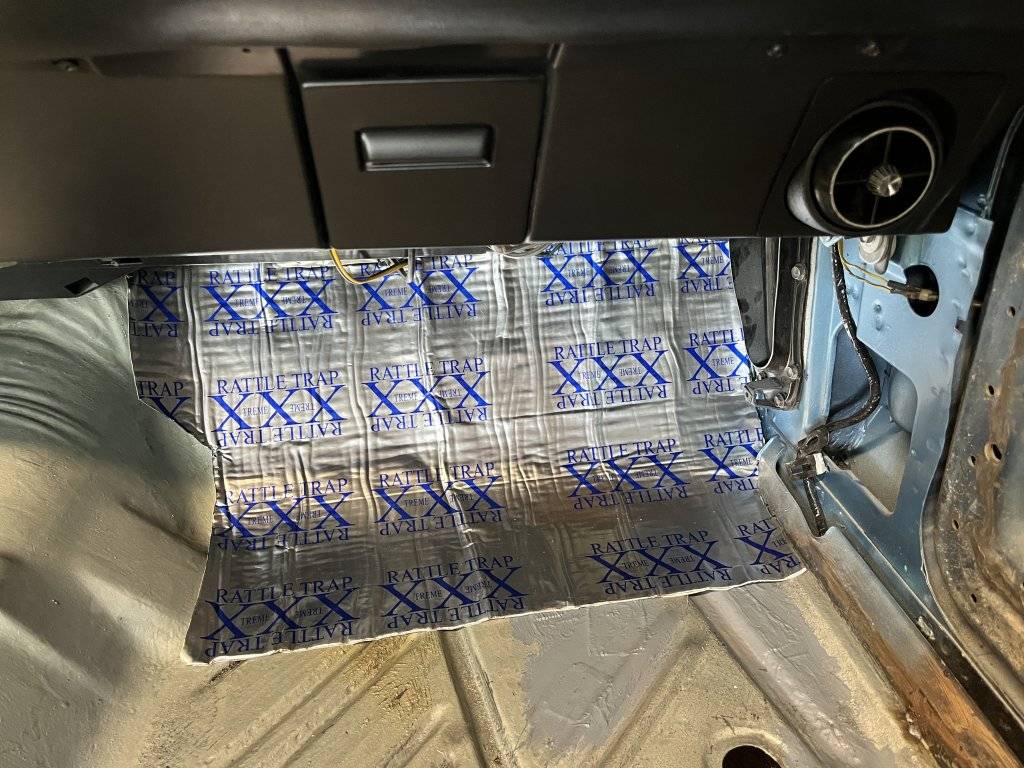

Fat Mat sound deadening applied. Easy as 1-2-3, and a lot of sweat doing this during our 10th heat wave of the summer. I ran out and had to order another 10 square feet, but got it done. I spent a lot of time gathering all the correct body plugs so I didn’t want to cover them up.

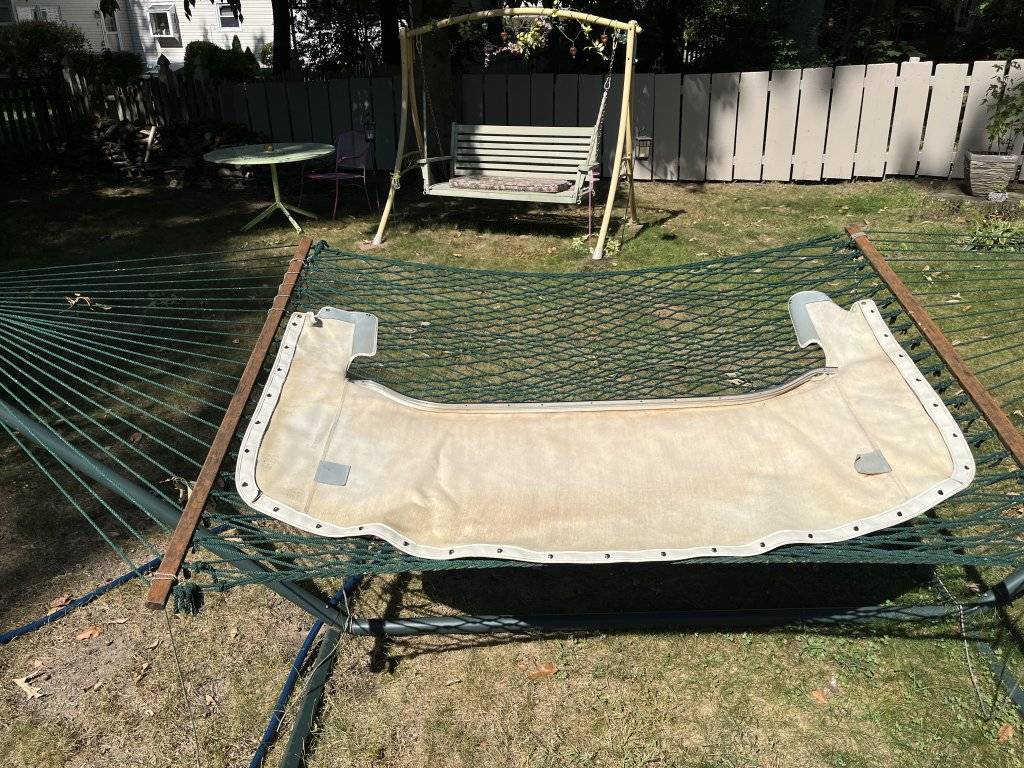

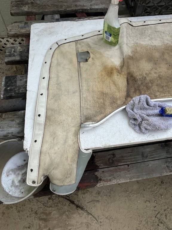

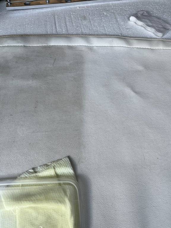

Finally got around to locating and cleaning up a number of parts for the interior. The boot had been kicking around the basement for a decade now and started to get some mold spots. In another thread @cuda hunter suggested green Dawn to wash off mold from walls and wow did that work! Also uncovered a date stamp of September 4 1969.

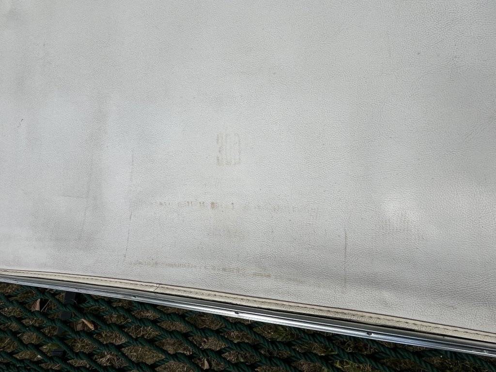

This was interesting. The boot must have spent too much time draped over the back seat so it was branded with the “300” from the rear speaker grill. I thought it might be a rust stain so I tried soaking in Evapo Rust, then Dawn, then Formula 409, but it is still there!
