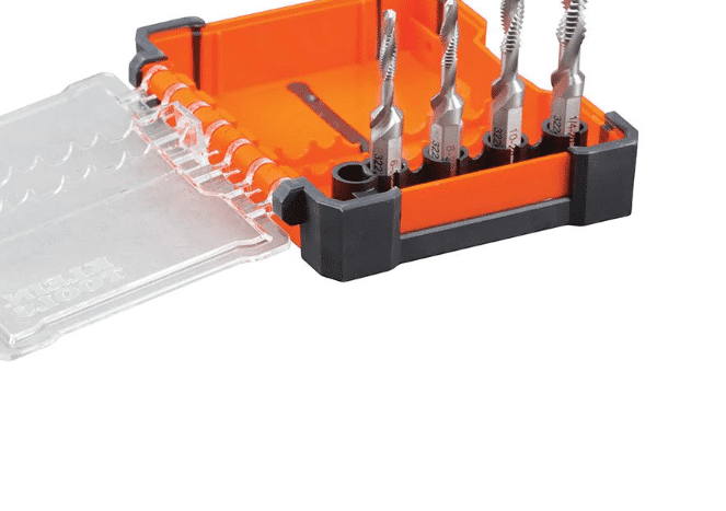

Here bro: Klein Tools High Speed Steel Drill Tap Tool Kit (4-Piece) 32383SEN - The Home Depot
Use the largest of these four taps, the 1/4-20 bit-tap combo. Chuck the 1/4" hex base into a 1/4" socket, driven by a 1/4" drive ratchet, make sure you're vertical, normal to the tangent to the plane of the 3/32" hole the pin goes into, tap that hole at least four complete rotations of the tap, to make sure you've cut the thread and cleared it down, and then you can insert a short 1/4" stud, which is best supported with a nut just where it touches the column. This takes shear stress off the threads.

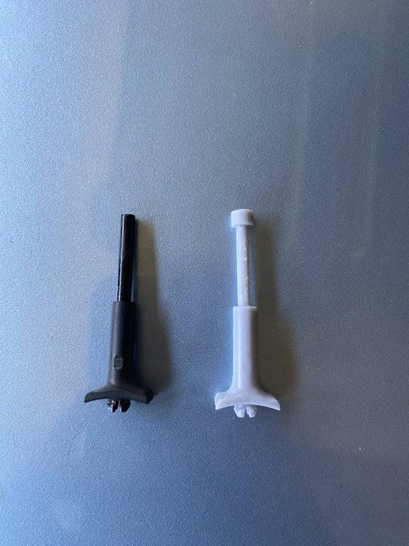

Good news on the reverse switch front. Finally got a legit 3D scan of the original and printed out some replicas. This batch was with the more brittle resin because that is what was already in the bath. It is a perfect copy:

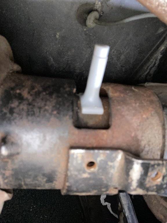

Even though this was the more brittle material, I decided to install the switch just to see if it will work. Figured if it doesn’t break, I will see how long it lasts.
I think you may have a winner there. Actually with the little head cap, it may be able to be re-used a couple of times unlike the original.
So long as it holds up, you have a winner copy! Collectors and purists can rejoice in the quality of your work; its that good.

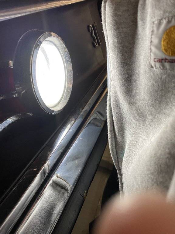

Took the car out for a drive. Backing back into the garage so I had my son hop out and snap a pic. One happy dude here!
