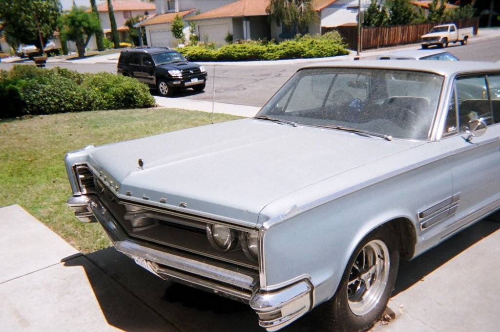

I ran slots for 12 years. These were Shelby Cal 500s, 15x7. Yes, Ford wheels, but I had no problems, regardless of the horror stories about running Ford wheels on Mopar hubs.

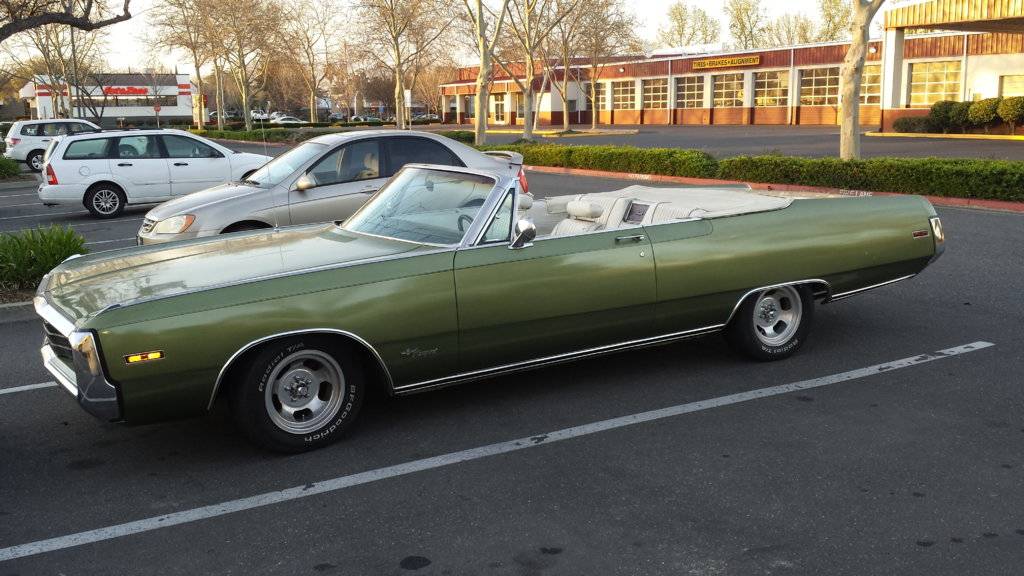

my 67 300 required a rear end charge to get the 15x8.5 vintage americans from 1965ish with a nice size tire
on it . do to a 1 1/4 pos offset . and that 245/60-15 fits with no issues , 225/70-15 up front could go bigger . but i've never needed any more tire on the nose of these c bodies , even at 145 mph in a freeway curve .
