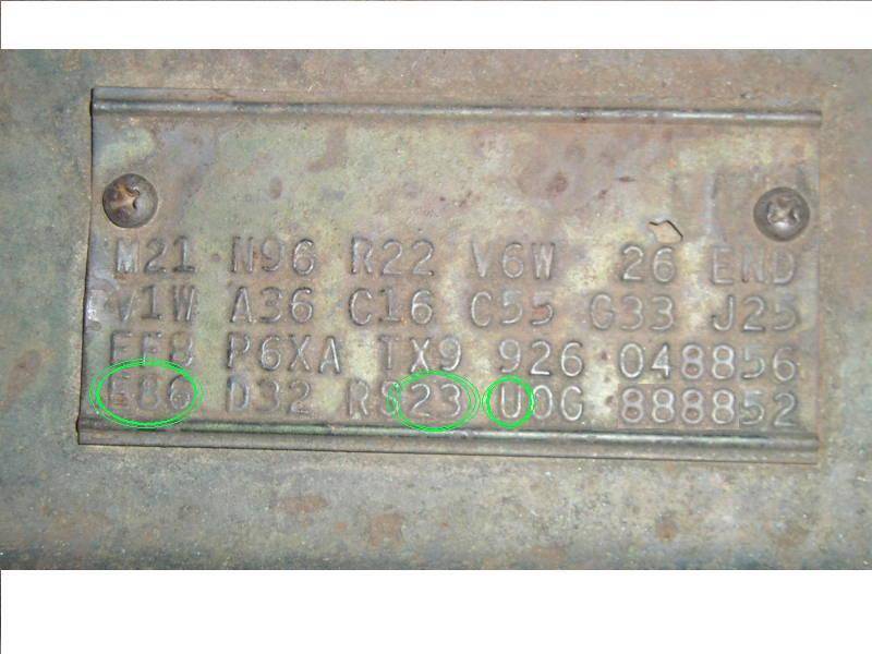

Galen's book shows 1 known U code RR for 1970....
Your kidding? They were all T's
i wonder if the orig one was blown or is residing in another carGalen's book shows 1 known U code RR for 1970....
There was a very interesting turn of events with this car..... The windshield was cracked and delaminated and it made the VIN hard to read. Add to that a small scratch across the dash VIN tag made the 5th digit appear to be a "N", (383), as I was told by the fellow I got the car from. Once the windshield was removed it became evedent that the code was a "U".... An original 440 4bbl A/C car....!!!
In addition Chrysler historical shows the car was built for either an executive or for inhouse purposes..... It was never delivered to a dealer..... Wish it could talk....
I'm not buying it.... :no: How do you buy and then sell a car, neither time writing the VIN# down on a bill of sale, and what of the title?
I could look further to see if the 1 car that had the U code 440 was a hardtop or post, and whether it was a 4spd or auto car...

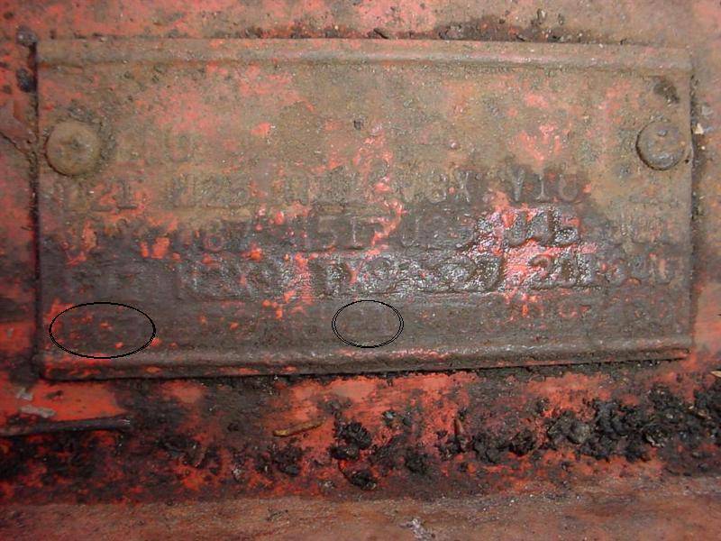

However... it would be easier to just see a picture of the VIN, data plate and the door decal to see what is real and what isn't...
If the vin tag, door decal and the fender tag all have a U for an engine code but the fender tag also states 383 and you have no engine...in my mind you've got more evidence pointing towards it being a 440 car. Was a build sheet ever found?
ill tell you something that's been happening a lot lately to me and it has everything to do with living in the Detroit area. I've heard more and more stories being told by people that were in the plants where these things were built and I'm not going to say that it was an absolute free for all but I will say that it was substantially more loose then you'd think. I'm sure the same can be said for the other cities that had assembly plants. I also know that people made mistakes when stamping out these tags and decals but this one is pretty consistent. This guy is on FBBO, I'll go for a closer look at some point.
Please keep us posted, its an interesting story...
I still cant get over no 440-4 in a 70 RR
Isn't the data plate for this RR have E63 on it? I would think a U code RR would be something special.
If the vin tag, door decal and the fender tag all have a U for an engine code..... but the fender tag also states 383 and you have no engine...in my mind you've got more evidence pointing towards it being a 440 car.
I've heard more and more stories being told by people..... This guy is on FBBO, I'll go for a closer look at some point.
