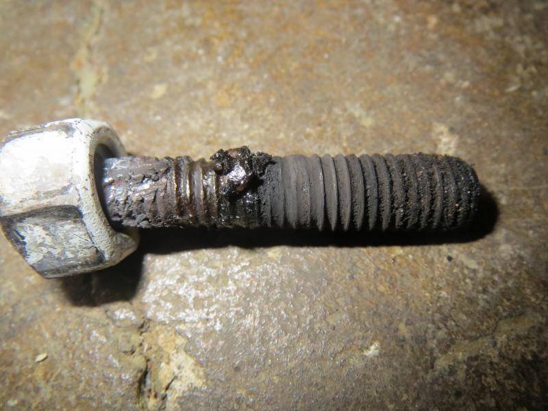

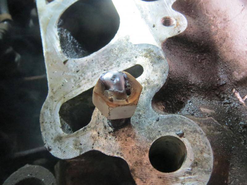

I just got the broken bolt out and I only welded the nut on when it showed signs of movement with the Vice Grips!

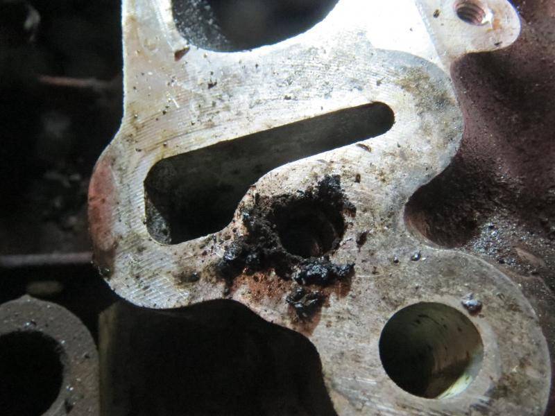

I credit patience more than anything but honorable mention goes to mapp gas, PB Blaster, bees wax, acetone atf, and tapping with a hammer while heat applied. The threads are still in great shape and I can finish putting it back together now. Here's the aftermath.

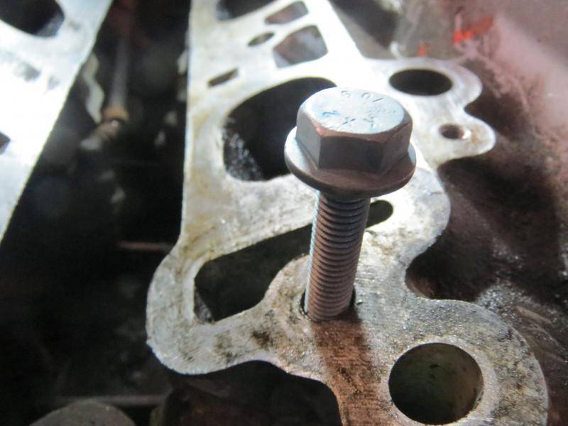

Matt...make sure you put some anti-seize on those new bolts.
