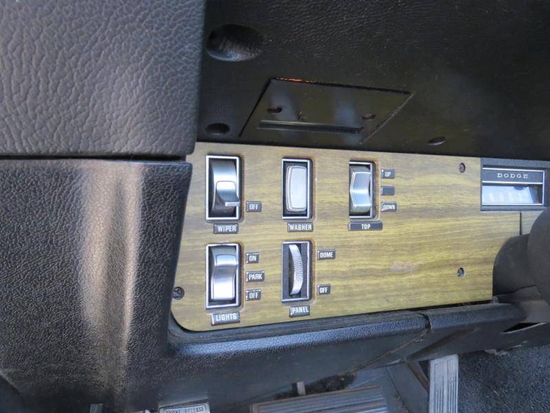

Most, if not all of that was just done over the last year by the previous owner. It really just has a few very minor issues and needs tires before really hitting the road. Dash lights don't work so it probably needs a new dimmer switch.

My bet is the circuit board .

circuit board? Maybe but I just had the rotary dimmer rebuilt for my Imp and in the process looked at the rest of the dimmers I had on hand and all had the same issue. They are all worn out and not making contact on the reostat.
thats the culprit IMO.

Here's the guy that did mine, highly recommended. You should be able to pull it for visual inspection or better yet put a test light on the leads.http://cgi.ebay.com/ws/eBayISAPI.dll?ViewItem&item=251059984371&ssPageName=ADME:X:DED:US:1123
