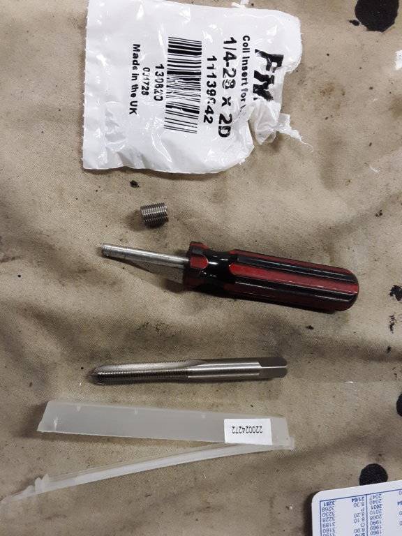

i thought this was cool.
Thread Insert 11139042 1/4x28 x 2D: turn clockwise to install on oversize threads, using old tire valve installer. The slot at the end of the tire valve installer engages the tang at the bottom of the thread insert, and saves you the cost of buying an insert tool, about $12.
my thanks to the author.

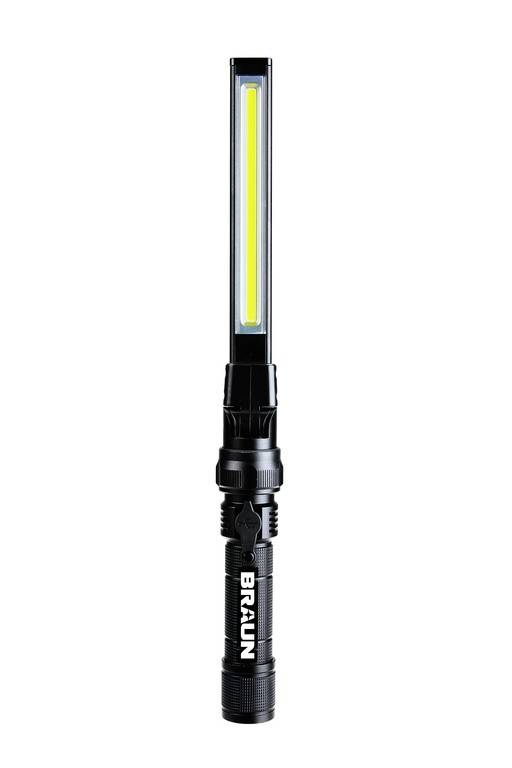

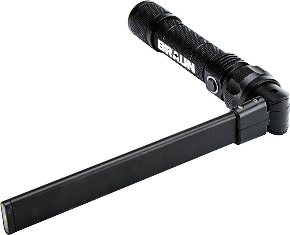

I found these lights at Harbor Fright. You should be able to catch a sale and get one for about $26. I have two. 390 Lumen Magnetic Slim Bar Folding LED Work Light They light up the world nicely and have a magnetic base to stick on the car. Two levels of light on the arm and a small light on the tip. Rechargeable.

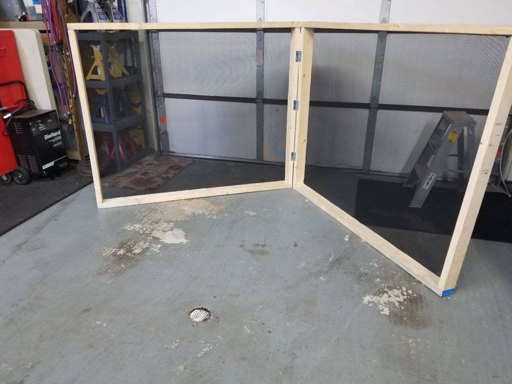

I made this door screen to fit under the roll up door to keep the leaves from blowing in the shop. It also allows plenty of sun light to come in, so no need to keep the lights on all the time.

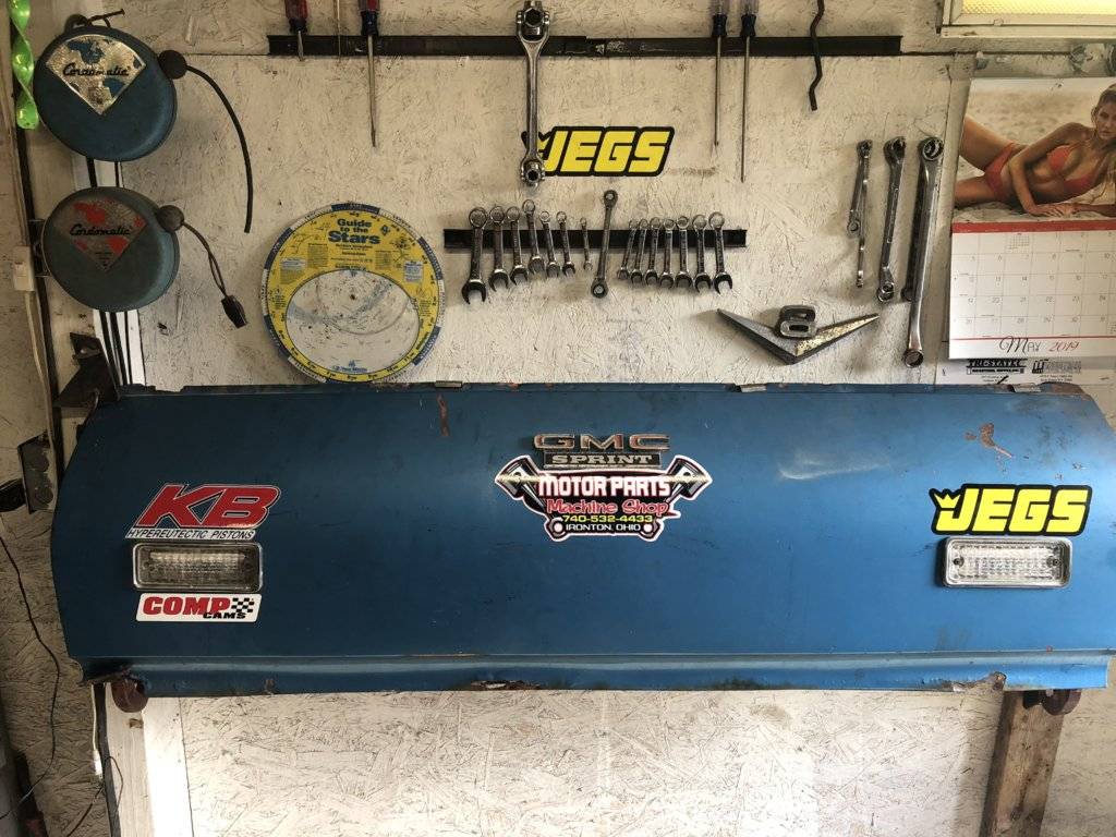

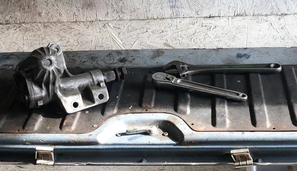

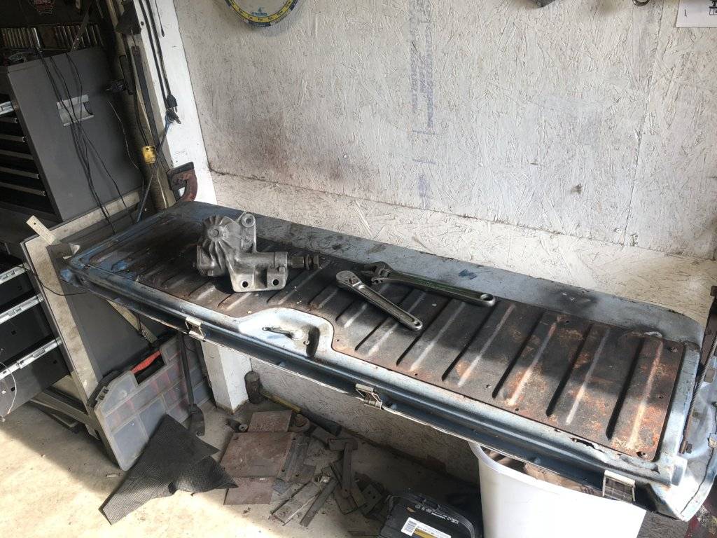

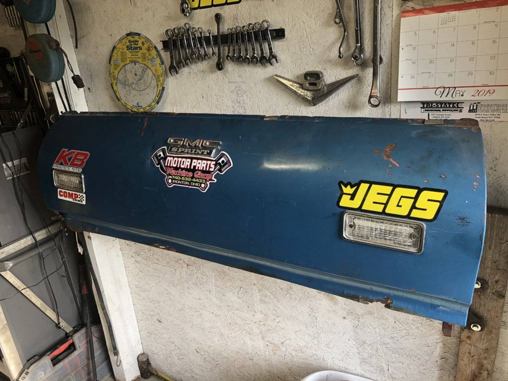

Ok, here’s my shop tip/trick:
My garage is small. 25’x18’ I wanted heat and AC so the less British Thermal Units I had to come up with the better!
Being so small, a smart use of space is important. Today’s cars fit nicely. A big C body? Not so much but,it’s manageable. I wanted a bench in front of a car to be able to lay tools and parts on when working under the hood but didn’t want it in the way when working on the rear of the car as I have to place the car in deeper to make room.
My solution was a repurposed tailgate from a GMC Sprint. Using the original hinges and one cable, I fastened it to the rear wall. In the up position it’s out of the way. In the down position it’s plenty strong enough to hold most any part. I even hooked the back up lights to a 12v power supply for light and general coolness!

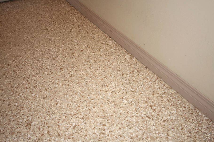

Some coatings are as described. But others don't seem to be. Our service manager had the shop floor power washed and coated with light gray "stuff". ANY bit of moisture made it hard to walk on. But in the 4 stalls that our trans guy used, had to be careful there, too! He also had an inclined concrete area clear-coated. Same thing.
But a friend had an older shop, with similar gray coating, and it never was slippery at all. Even without any of the "traction grit" put down. Not sure why some are slick as owl stuff and others aren't!

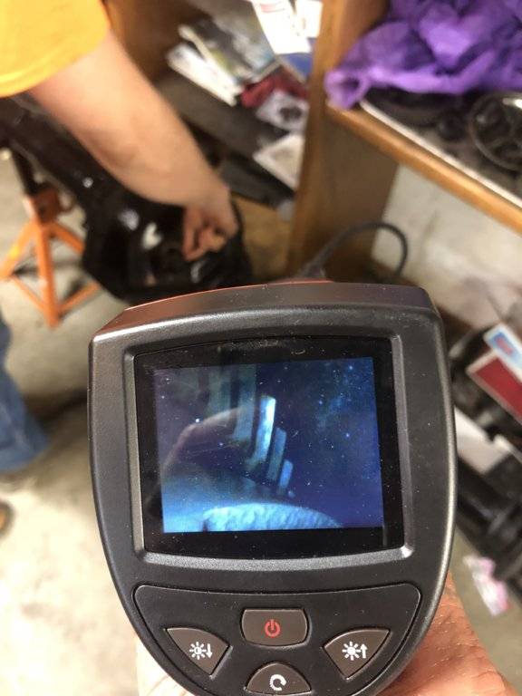

Remote viewing camera. Take one along when inspecting a potential purchase. Pull out a spark plug and have a look!
Good for the shop and when I go to look at one for the purpose of buying, it keeps everyone honest. I’ve inspected quite a few “4 bolt main SBC” that turned out to be missing 2 bolts.
