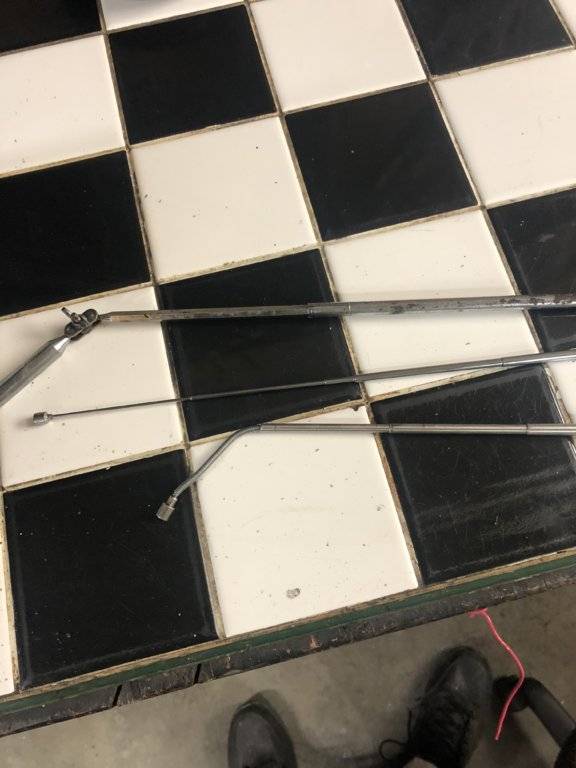

These little telescopic magnets are very handy.

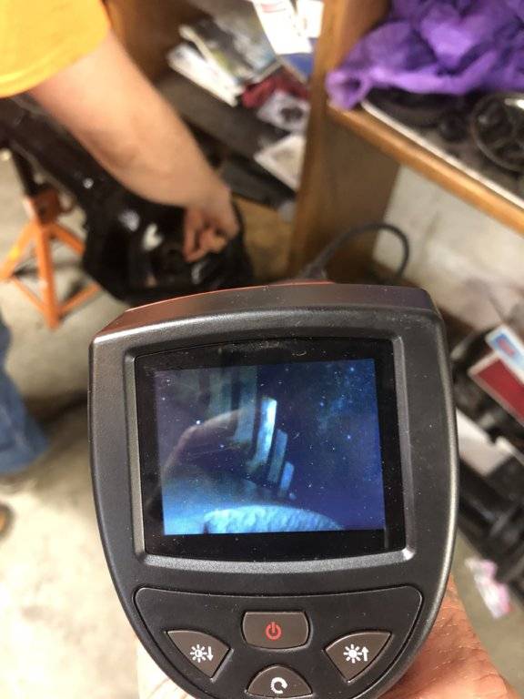

Remote viewing camera. Take one along when inspecting a potential purchase. Pull out a spark plug and have a look!
Good for the shop and when I go to look at one for the purpose of buying, it keeps everyone honest. I’ve inspected quite a few “4 bolt main SBC” that turned out to be missing 2 bolts.
How did you get the camera into the oil pan to check the mains?

Drain plug.
I'm surprised the seller would let you drop the oil to check this but if they motivated sellers, they let you do what it takes to sell the car.
Unless the engines were free & clear out of the car.
Thanks for the explanation.
That’s what I’m talking about. Engines that are already out. I’ve never drained the oil in a car that wasn’t mine to perform this inspection. But, if the seller is motivated enough and the money is in hand, you could say “if you let me do this and, it is in fact a 4 bolt main, I’ll hand you the cash when I crawl back out from under it”
