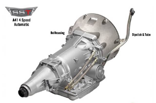

Hey guys! I'm Kevin Shaw, Editor-in-Chief of Mopar Connection Magazine (www.moparconnectionmagazine.com). We do a lot of work with Silver Sport Transmissions and they showed particular interest in adapting their "A41" 4-speed automatic overdrive transmission kit for our '70 Plymouth Fury III convertible project car.
But as is with all things, they're curious if anyone else in the C-body community would be interested in updating their C-body with the similar kit. The A41 begins with a 4L60E or 4L65E overdrive transmission that is fitted with a Chrysler bellhousing (SB or B/RB) and a modified tail cone. It can be adapted to be manually shifted or use a TCM.
They currently have kits for A, B and E-bodies and they wanted to to branch out into C-bodies, so I'm here to help gauge public interest. Obviously, this isn't for everyone (particularly those who are restoring their builds per factory) but for those looking to modify their Mopars.
I'll try to answer as many questions as I can, but I am NOT an employee of SST, just a friendly messenger.
