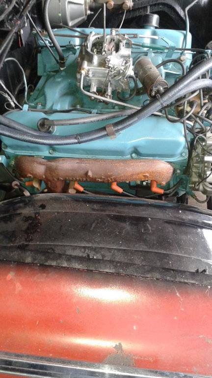

So far as I dig deeper into my 383
So far I'm out only a timing chain cover , but if the entire motor explodes when i go to start it I may have everyone beat lol.

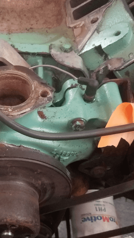

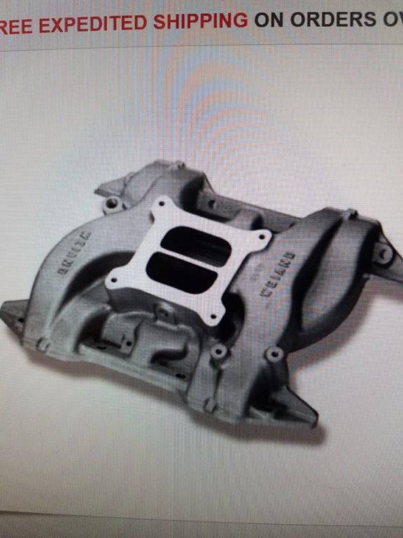

So guys if I went with a aftermarket intake would I have to drill bolt holes to mount my coil and so on. Just kinda lost on what to do. I did find a Weiand 8008 that looks like might be a good fit and allow my coil to work. I did find a stock one painted orange but I see there's a area that I may have find or make a block off plate for ?
The stock one shown will not need a block off plate, that's the well the choke element sits in. Some will have an EGR opening, those will need a block off plate = it's a direct vent to the intake plenum.

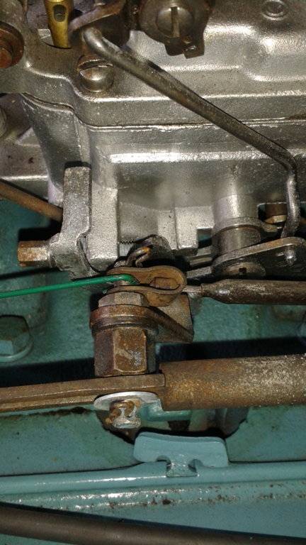

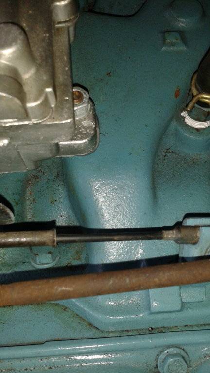

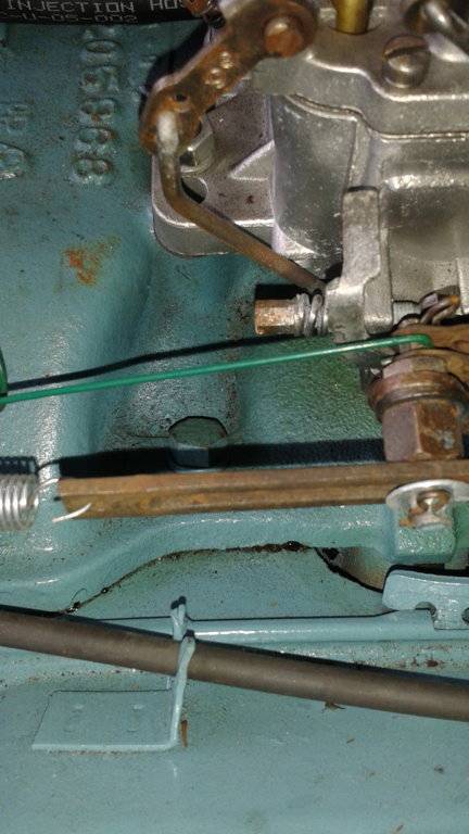

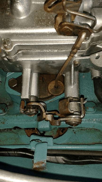

Here are some pics of my 1966 300, factory 383 4bbl. The adapter bolts on to the carb and puts the linkage in the correct place.
Take a real close look at traintech pictures and you will see the difference, someone have did it all way wrong on your linkage.
Remove the little screw in the slot and load the slot at the opposite position with a spring, the KD linkage must follow throttle position, at WOT it should be almost at full load on the transmission. The slot is there becasue if something happends to the transmission the carb wouln't stay at WOT when you let of the pedal.
In some cases when you go from 2bbl to 4bbl you must lenghten the linkage at the carb to get the right geomethric, it all depence on how much you can adjust the linkage. It's very important to get the right adjusted KD linkage to get right shifting points and as many has described, the KD linkage is a matter of fact a pressure regulator, if you get it wrong you'll fry your transmission or blow some gaskets.
There's many instructions how you adjust KD linkage on a 727, just google it, but you must have the right geomethric to start with.
Just my 2cent...

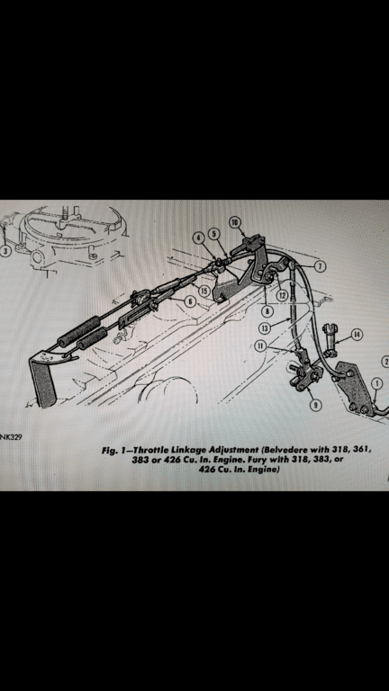

There is very thorough and detailed procedure laid out in the FSM you should use to perform this critical adjustment.

Also adjust transmission linkage so that it is all the way to the stop at WOT.
Zwap, adjust as in starting at the carb or at the foot pedal? I'm sure there's a YouTube video out there lol
Hold the pedal to the floor, helper, stick, whatever. Loosen and adjust throttle cable sheath clamp(on bracket) pull cable rearward till throttle plates are fully open, tighten down clamp. Tighten or loosen the kick down linkage to just allow the slot to make it onto the pin (rear of slot), should be tight/snug. Giving you the most line pressure at WOT. Put the springs and clips back on and release the pedal/helper.
