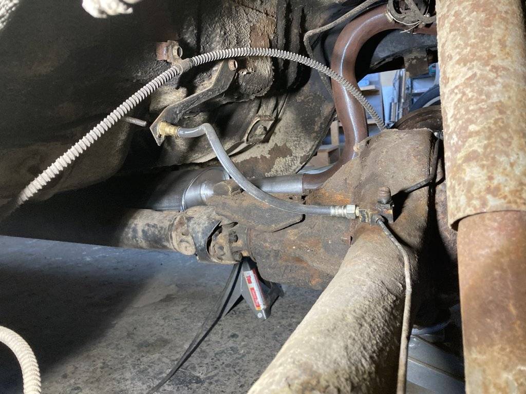

I did have to replace one of the wheel cylinders but the other one I just disassembled end cleaned it before putting it back together. Just replaced what I needed to other than that. I happen to have two freshly turned drums and since the shoes had a lot of life left I kept them in service.
I actually drove it down to the court that my shop is on and it stopped great in spite of just being gravity bled.

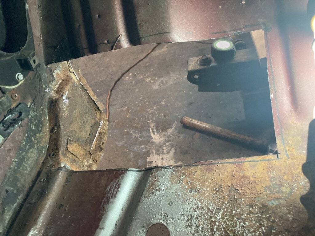

Before and after
Question? I see that you have this spot tacked on the inside. Do you later then finish the complete weld with tacks? Do you complete spot welds on both sides? Or just one side?
Im just asking because I have to do same on a 61.
I have zero body experience,but lots of welding experience.
This would be a stitch weld and only needs to be done on one side and slowly. 1 stitch every inch or so across the joint and let cool for a bit and then repeat until the joint is complete. This means that you can’t see light when looking at the joint when backlit. I took advantage of being able to weld from the backside in this particular place because grinding the weld flat would have been a giant pain in the *** in between those two body lines. Anywhere the body side molding doesn’t cover will be welded from the outside.

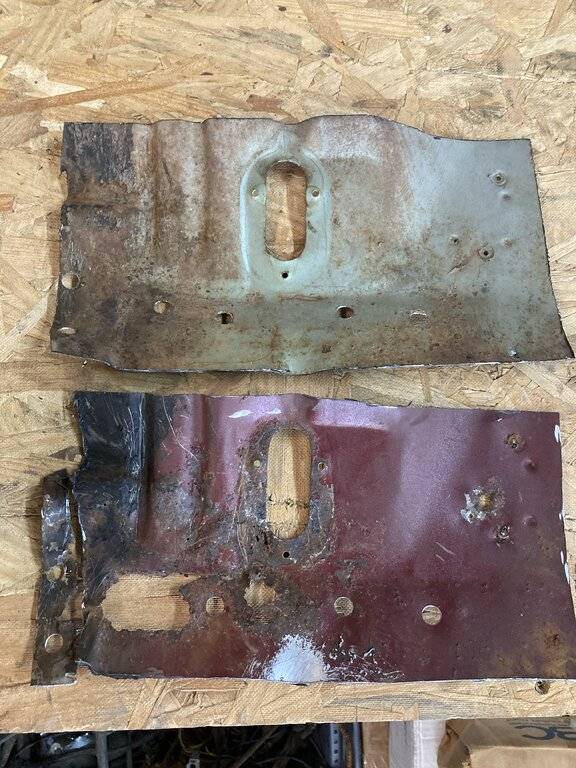

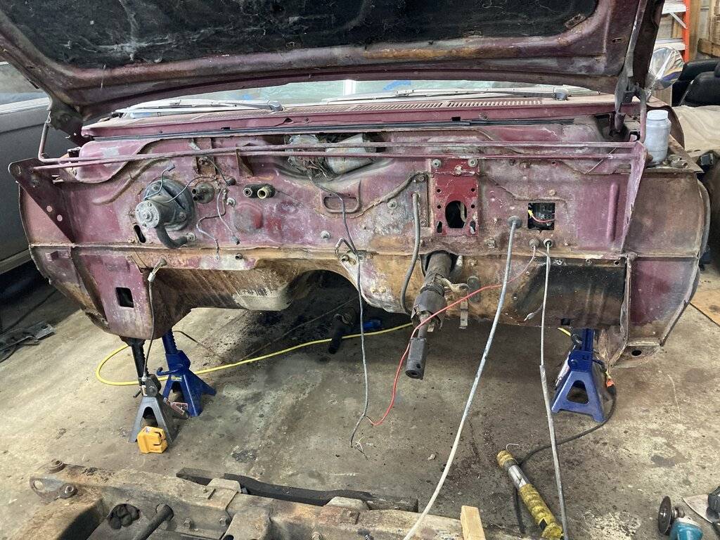

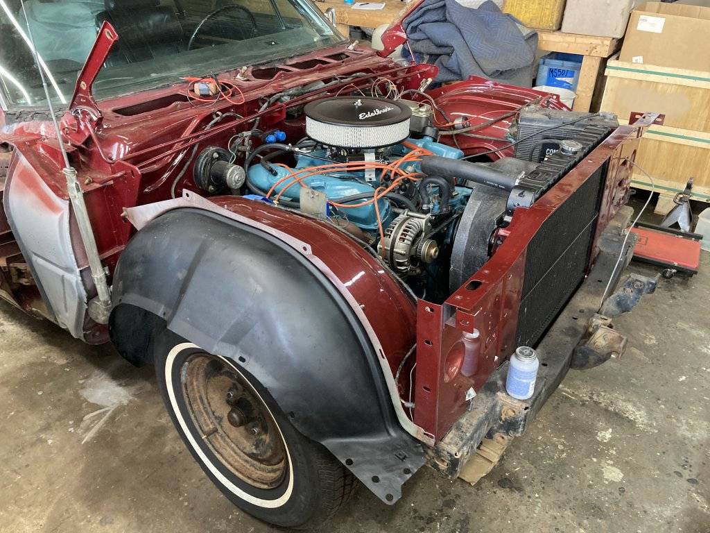

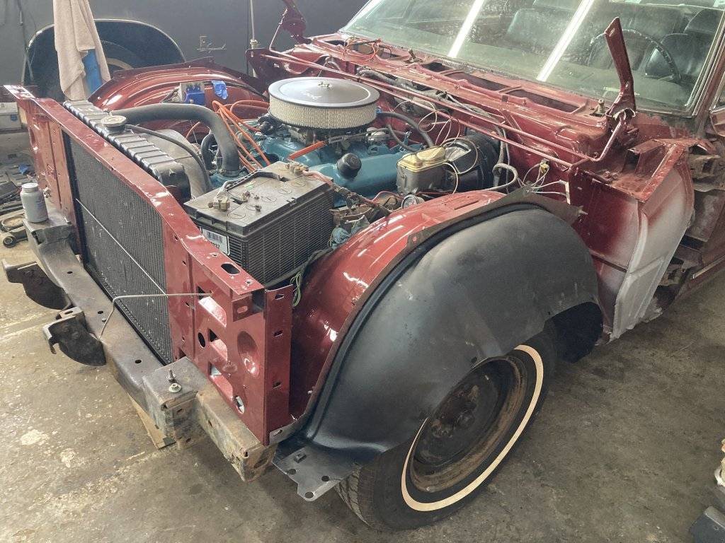

I’m preparing to hang the rest of the metal back on the front now that the engine is good to go. The outer halves of the front wheelhouses were in pretty good condition, very solid, a few bends that were easily straightened and I had to weld one captive nut back on and of course a coat of rust reformer for prevention.

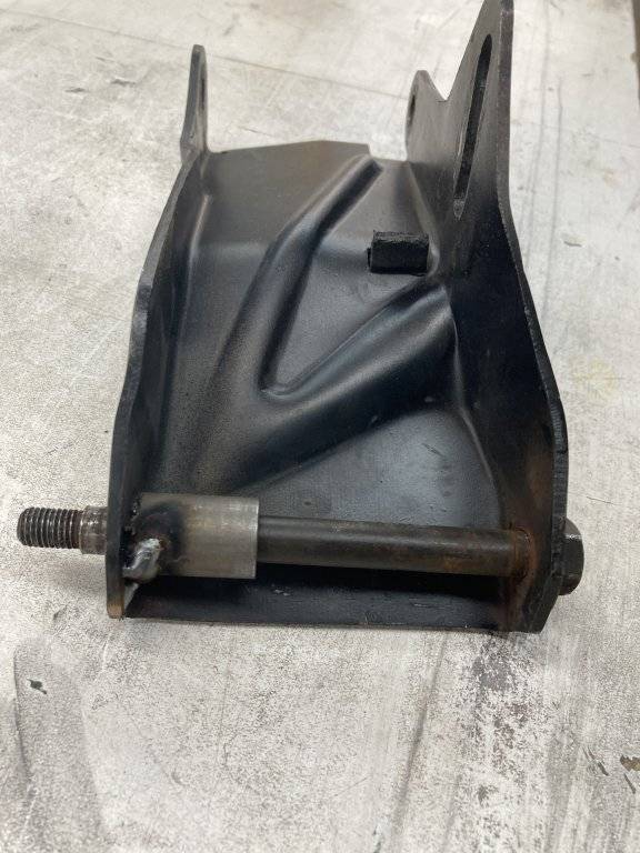

Took the wobble right out of the power steering bracket. I drilled out the worn out oblong hole to 5/8” and welded in the alternator spacer with a perfect 3/8” I.D.. Done this way it will never wear out again.
To foreshadow a bit some things I’ve been waiting for for this project will soon be finished and a trip to Tiffin OH is in the near future to get the rest of the metal I need to finish making this car rust free. :thumbsup:

Please post a "how to" that can educate us further on your upgrade - these floppers are often worn out and what you've done is what the factory should have done originally.
They actually work well with a self tensioning under load design, and are easier on belts therefore... but sadly they wear out at the pivots and get misaligned.
This car confuses me in several ways pertaining to its condition, one way being that in my experience with Michigan cars is that usually the passenger side fares worse than the driver’s side because most of the road debris gets kicked up near the shoulder. This one is quite the opposite. There is some work to do in these same areas on the passenger side but not nearly as much.

Trying to think of a scenario where the drivers side would see more salt than the passenger side. Maybe if it was parked on the street for extended periods and salt trucks threw salt on that (exposed) side?
‍You do have to wonder.
It was used to deliver the morning paper?
Here in Western NY the roads are pretty salty for most of the winter, and we have lots of 2 lane roads. The whole car gets pretty salty, of course, but it's normal for the driver's side to get extra salt spray from the the oncoming traffic. Perhaps that has something to do with this car's condition.
