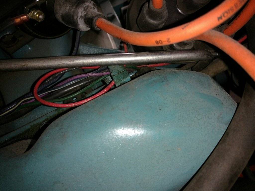

If I could find a proper hard line I'd use one to be honest.
These guys are giving very good advice... have one made or bend one yourself. Any line that gives a fair chance to spraying the distributor and exhaust with fuel is simply temping fate a little too much.
Hard line from tank to carburetor inlet. The only interruption should be hose connections at the fuel filter. And hose shouldn't be used as bends.
Is that mirror crooked?
The short one comes out of the fuel pump, turns sharply up. Then the fuel filter with 2" hose on each end.
Then the longer one goes from the fuel filter, between the block and the distributer, into the carburetor.

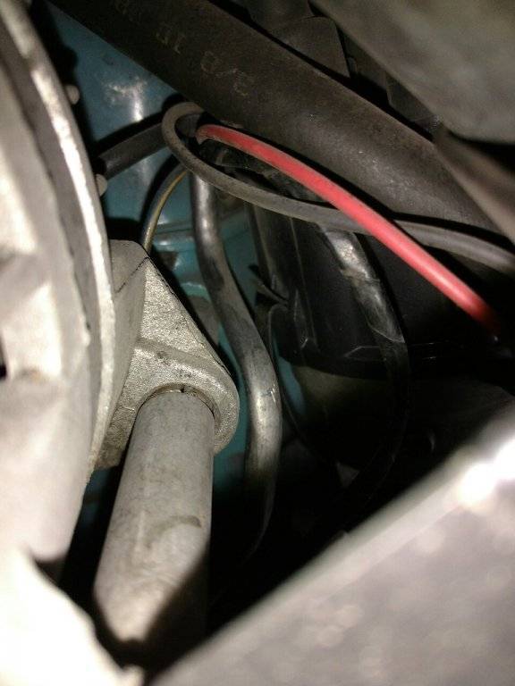

If the duel inlet carb is on a low-rise manifold, you HAVE to use the Mr. Gasket duel inlet fuel line.
Hard to photograph but you can see it's relation to the alternator mount and distributor.
