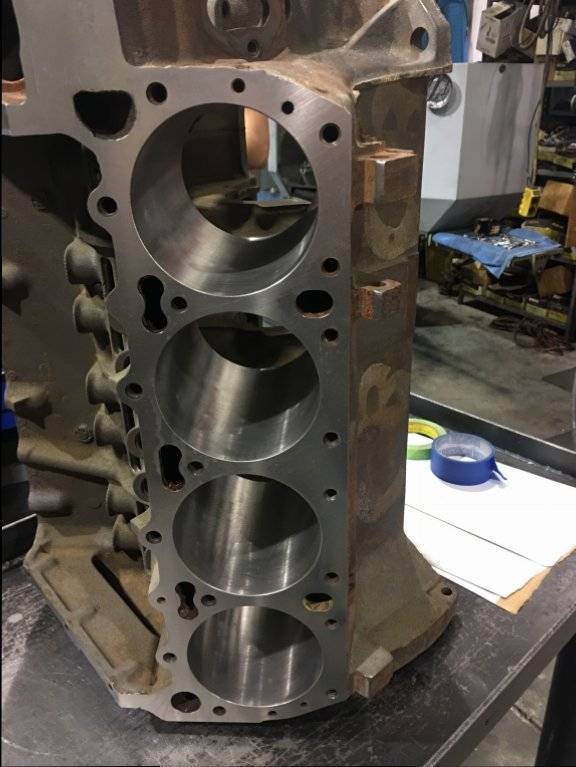

So I want to have a 440 built....
So what was our total cost approximation on this rebuild, after parts, dyno, and machine shop? If you don't mind me asking?

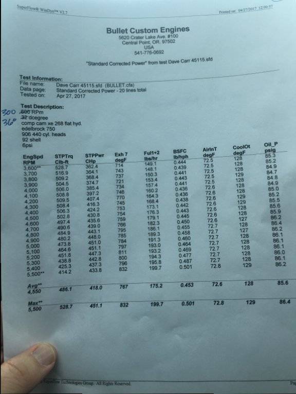

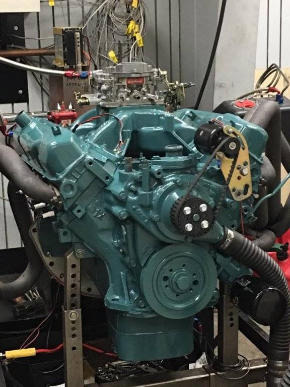

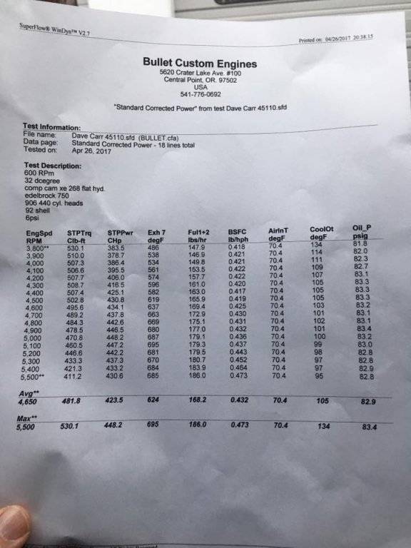

Carb's too lean for our altitude, will be richened up tomorrow and a few more pulls made. Engine builder is surprised by how much power and torque we're getting from such a mild build. Did I leave power on the table? Probably, but I'm really happy with these results.
